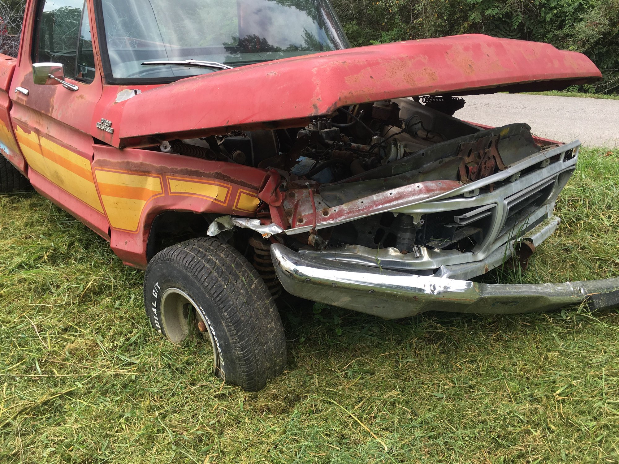

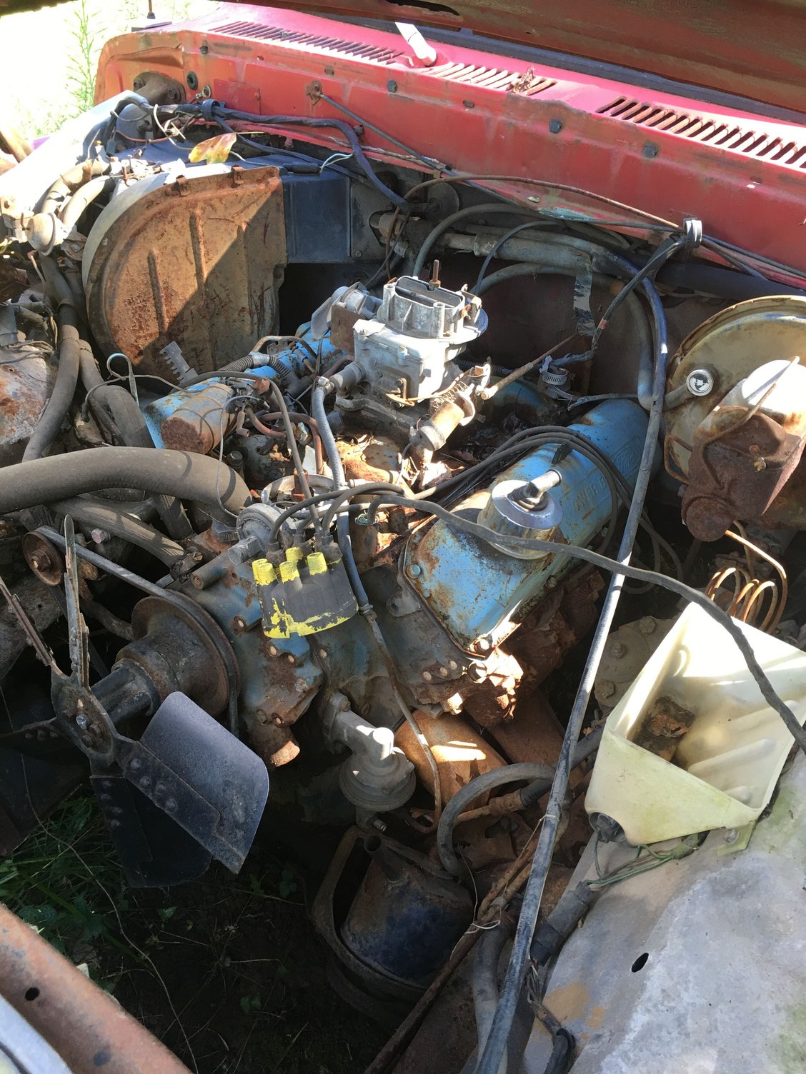

Some may remember the post from a few days ago where I was asking about some stuff for this truck. I'm a mopar man so this is all new territory, but with that being said I love anything old so I'm not too biased. Anyways my uncle gave me this truck due to him falling ill to cancer and not being able to fix it. I want to build it back almost stock except for a few goodies, just the way he wanted it. The truck itself is 1977 F100 Custom short bed two wheel drive. Factory 302, AC, PB, PS, Bright red with funky seventies stripes which one member said they believe to be the free wheeler package. Is there any way to prove the package, and it's rarity? This will be mostly a picture thread and parts buying thread until I get enough to start the restoration of it. Now onto the pictures.
As it sets.

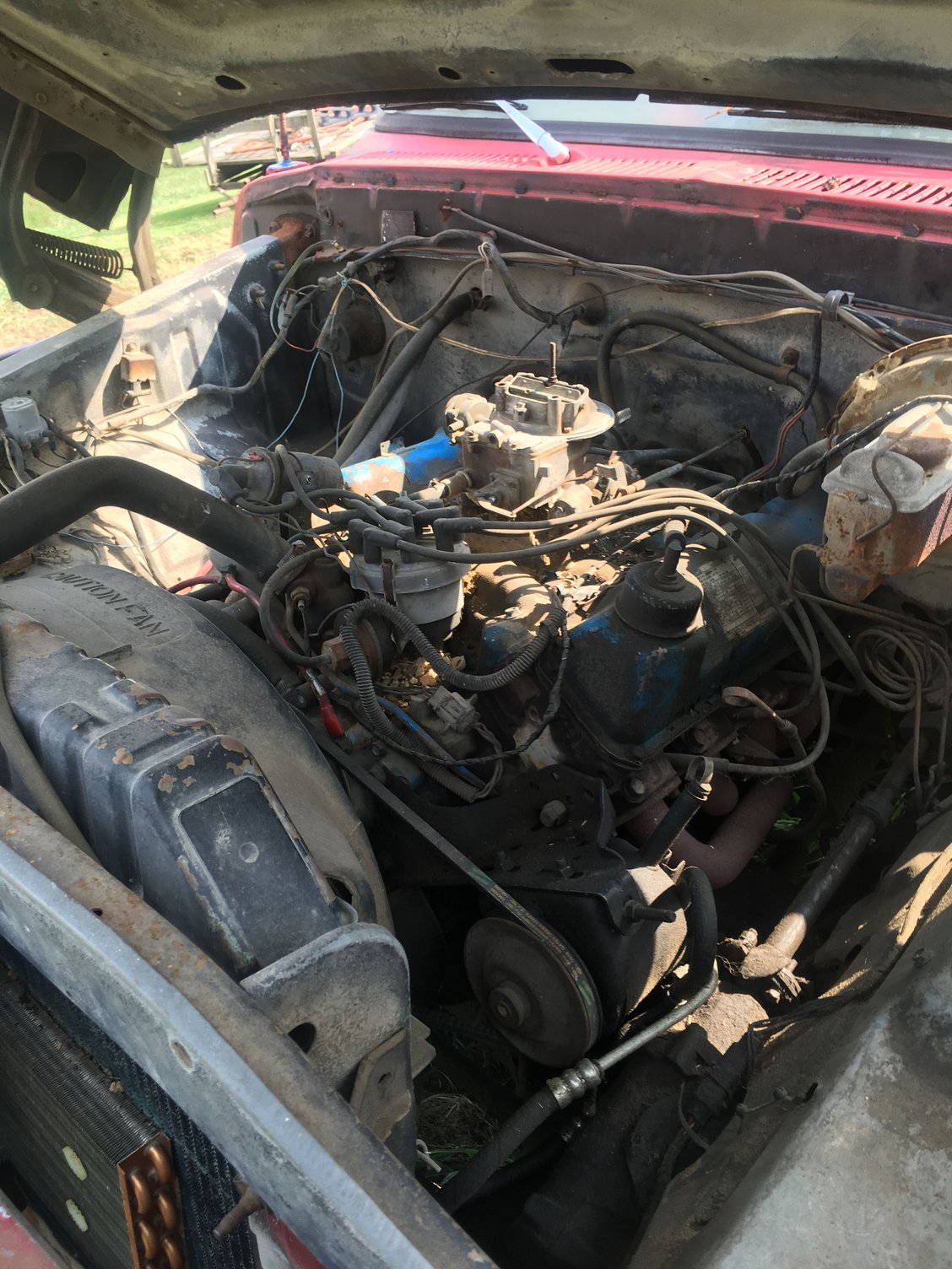

This will be replaced by a 351W that was also give to me.

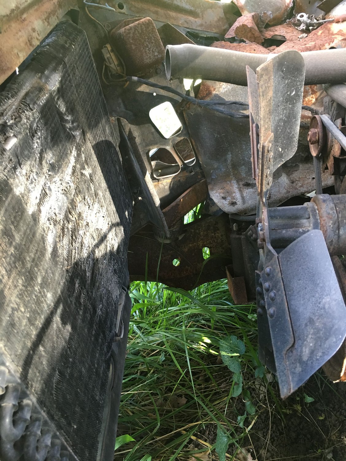

Frame damage from a drunk driver that hit it while it was sitting in his yard.

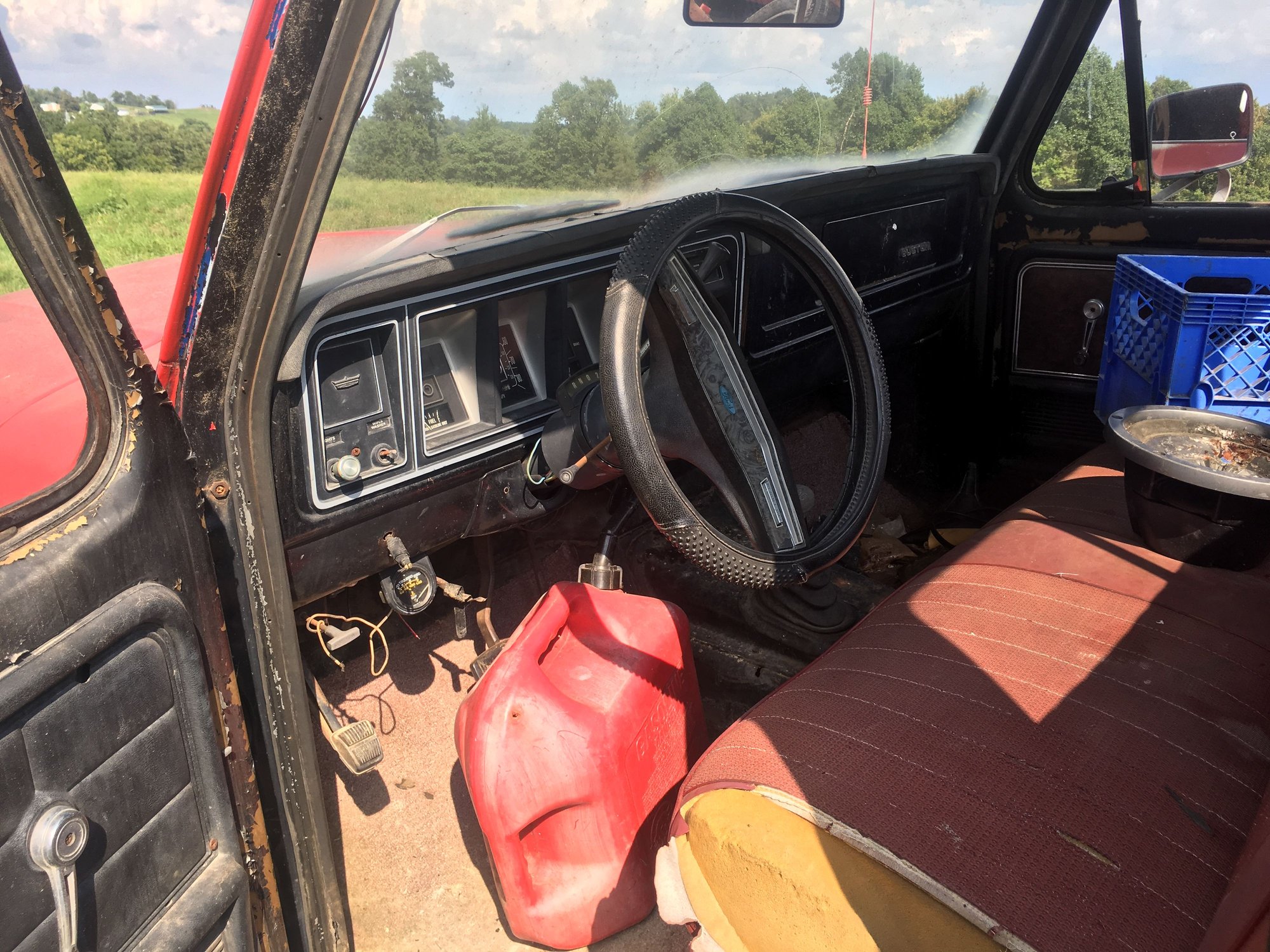

The interior is in pretty good condition overall, missing the stock radio which I will have to hunt for.

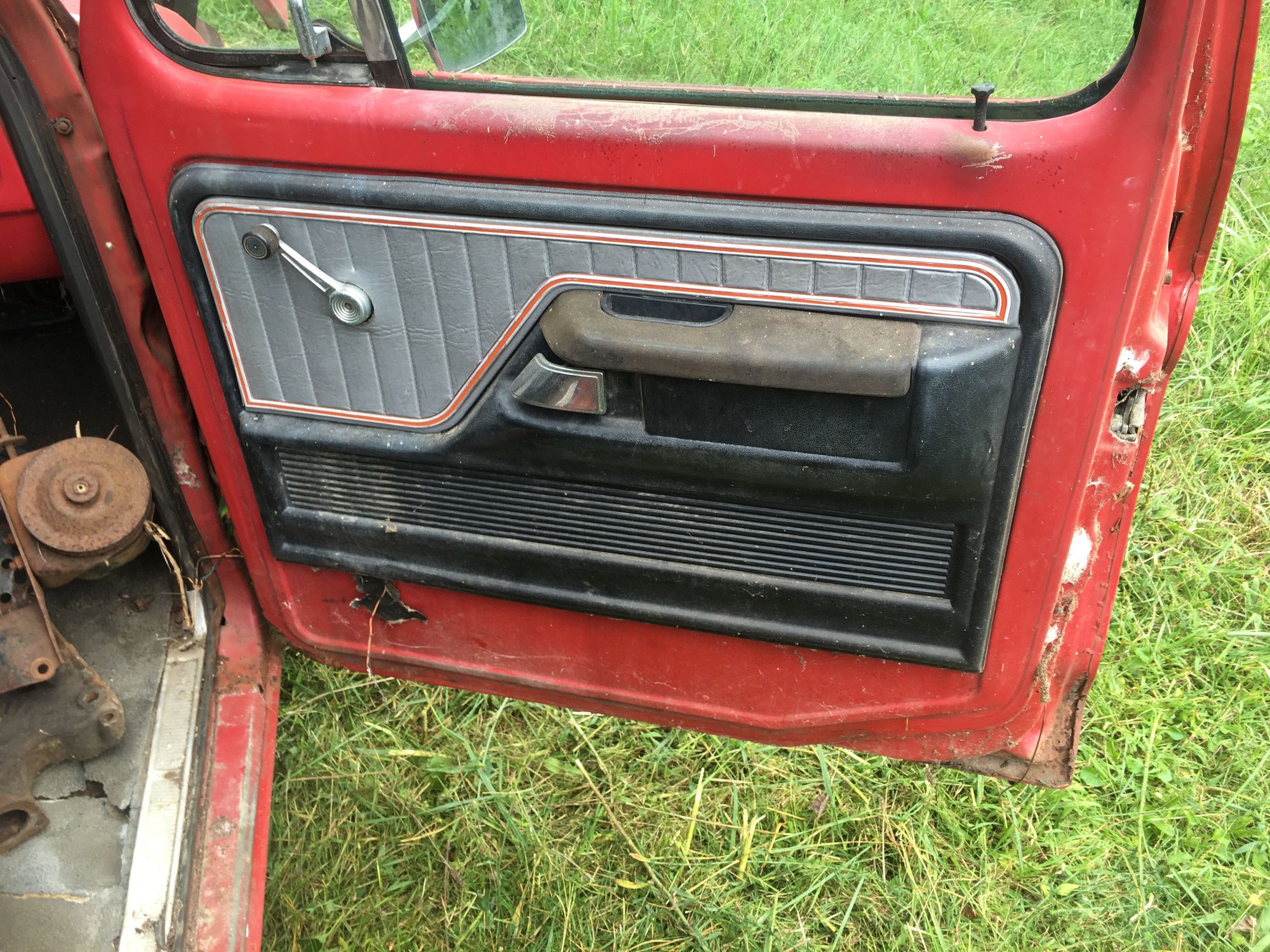

The door panels are definitely from a Free Wheeling edition.

A Marti report should be able to confirm whether it is an original Free-Wheelin' or a really good replica. As mentioned, the door panels but also the orange stripe on the dash panels as well as the wheels all match that package. My money would be on the fact that it is original.
Now for the bad part- as you pointed out in the engine compartment pic, there does look like there is some frame damage. The quickest and most common recommended frame repair is to swap the frame from a donor truck. However, that would totally render the Free-Wheelin' debate moot as the VIN goes with the frame, not the body. Still a totally cool truck either way, but it sounds like the originality matters from your post. If it was me, the originality and the sentimental value might make it worth repairing the existing frame, but that is something you will have to decide once you get it opened up and see the full severity. In the meanwhile, check out this post for some frame repair ideas: https://www.ford-trucks.com/forums/1...ent-frame.html

Another thing that points to the Freewheeling edition is the seat upholstery and the orange pinstripe on the instrument bezel and glove box surround.
This interior was also used on the Pace Truck, but the exterior definitely makes it a Freewheeling edition.

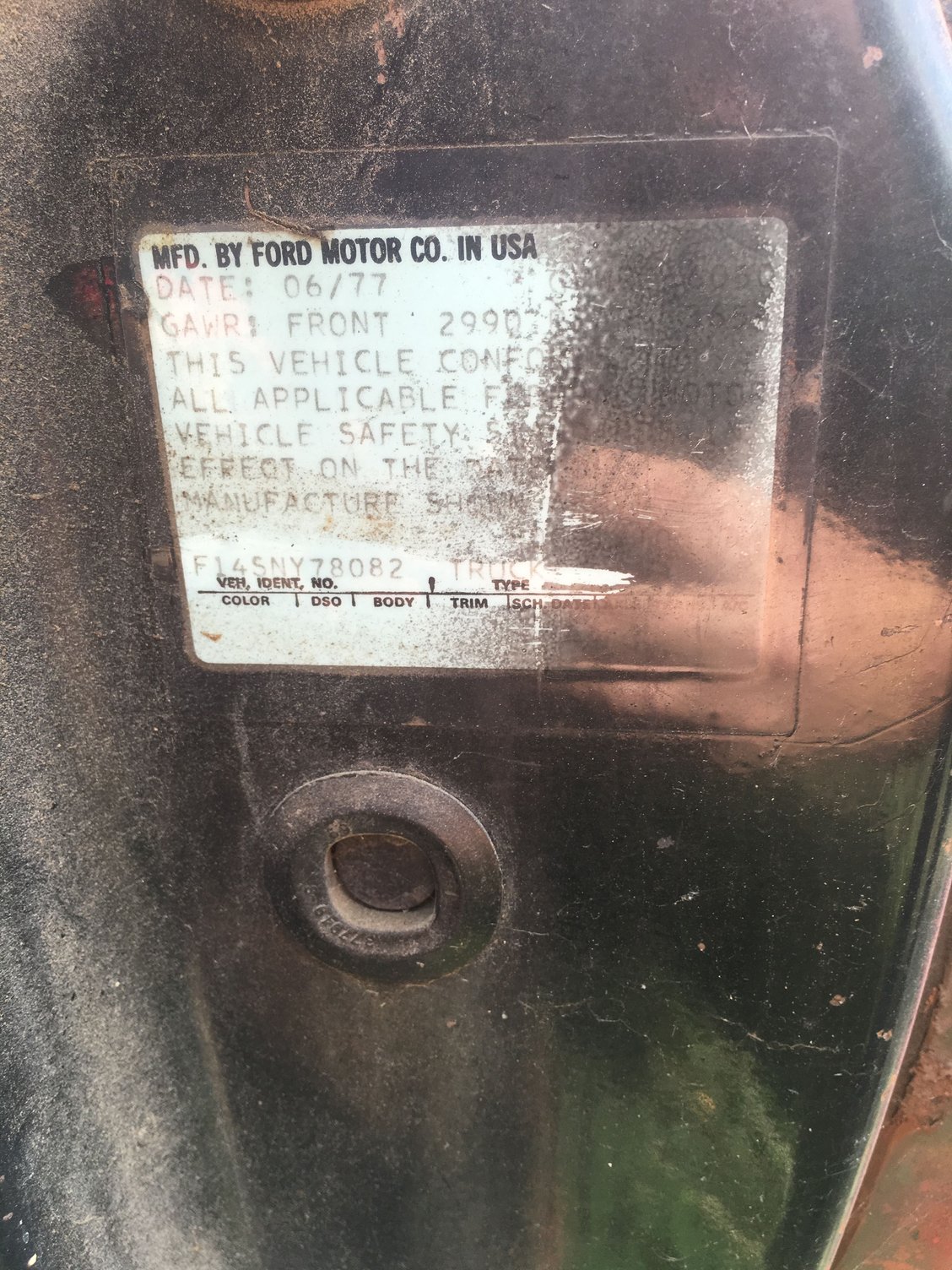

Vin help
So I'll be ordering the marti report soon for the truck but I'm stuck on the serial number of the truck, It seems to be a misprint. The resources I've looked at says the serial should start with and 'x' when it's 80,001 up which mine is. However on the vin it looks like a y or a v, should I put x, or what? The rest of the tag is in good readable shape, it's just that one letter that is holding me back from the report.

Just so you know the engine in both trucks is a 351m or a 400. Your 351w will not bolt up to the transmission. A 460 would though.

F 10 G N Y 89966

It is not uncommon for the doors to get swapped on these trucks. Best to verify the VIN from the stamped number on the frame. As for the Y- it is X80001 through Z25000 so your number looks good for a 77. Still best to make sure before ordering a Marti on the wrong truck.

So the Y is all good, correct? Where is the vin stamped on the frame?
