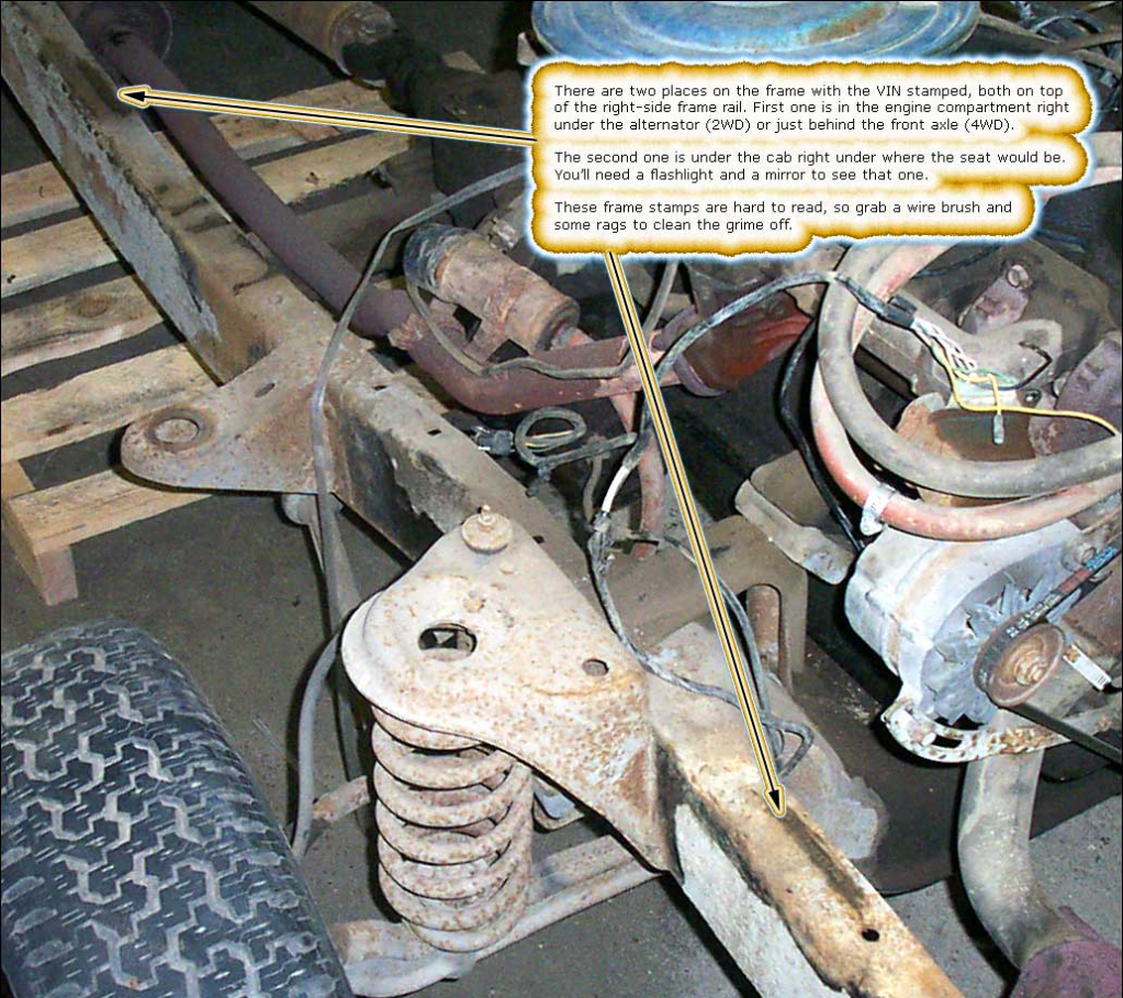

Where is the vin stamped on the frame?
*The preceding picture was shamelessly stolen from another post.

Awesome, thanks a lot. I'll make that my weekend project if we can get it moved to a place I can work on it.

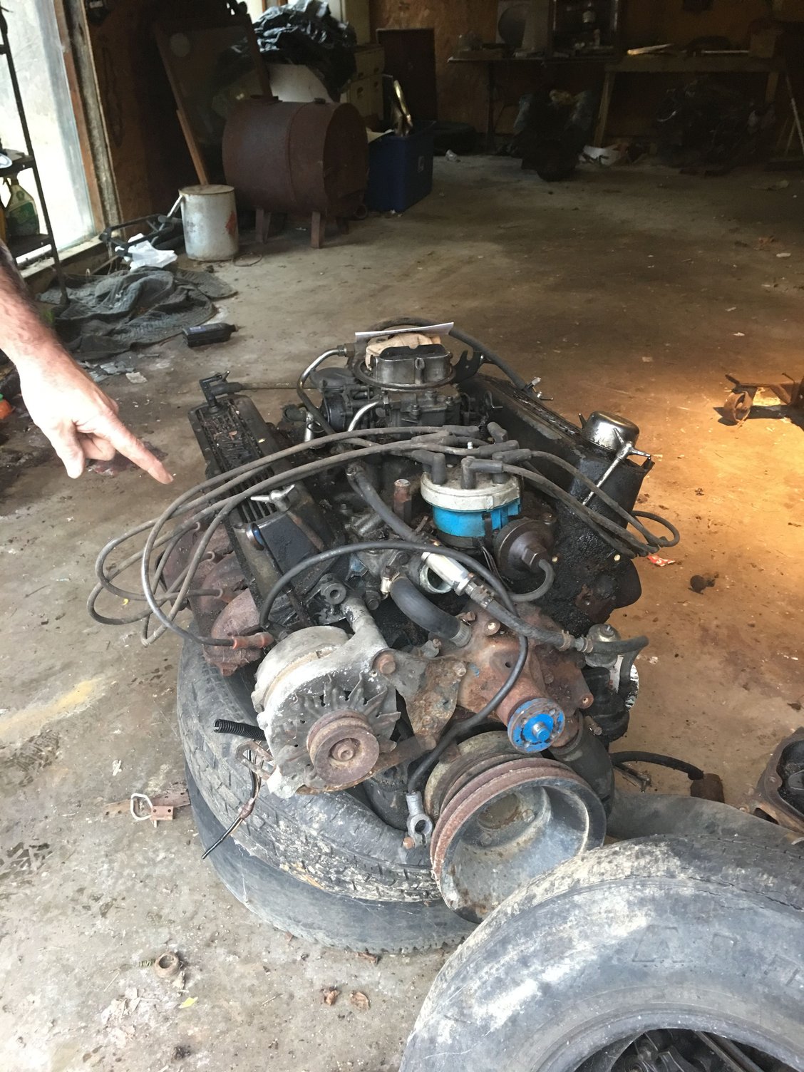

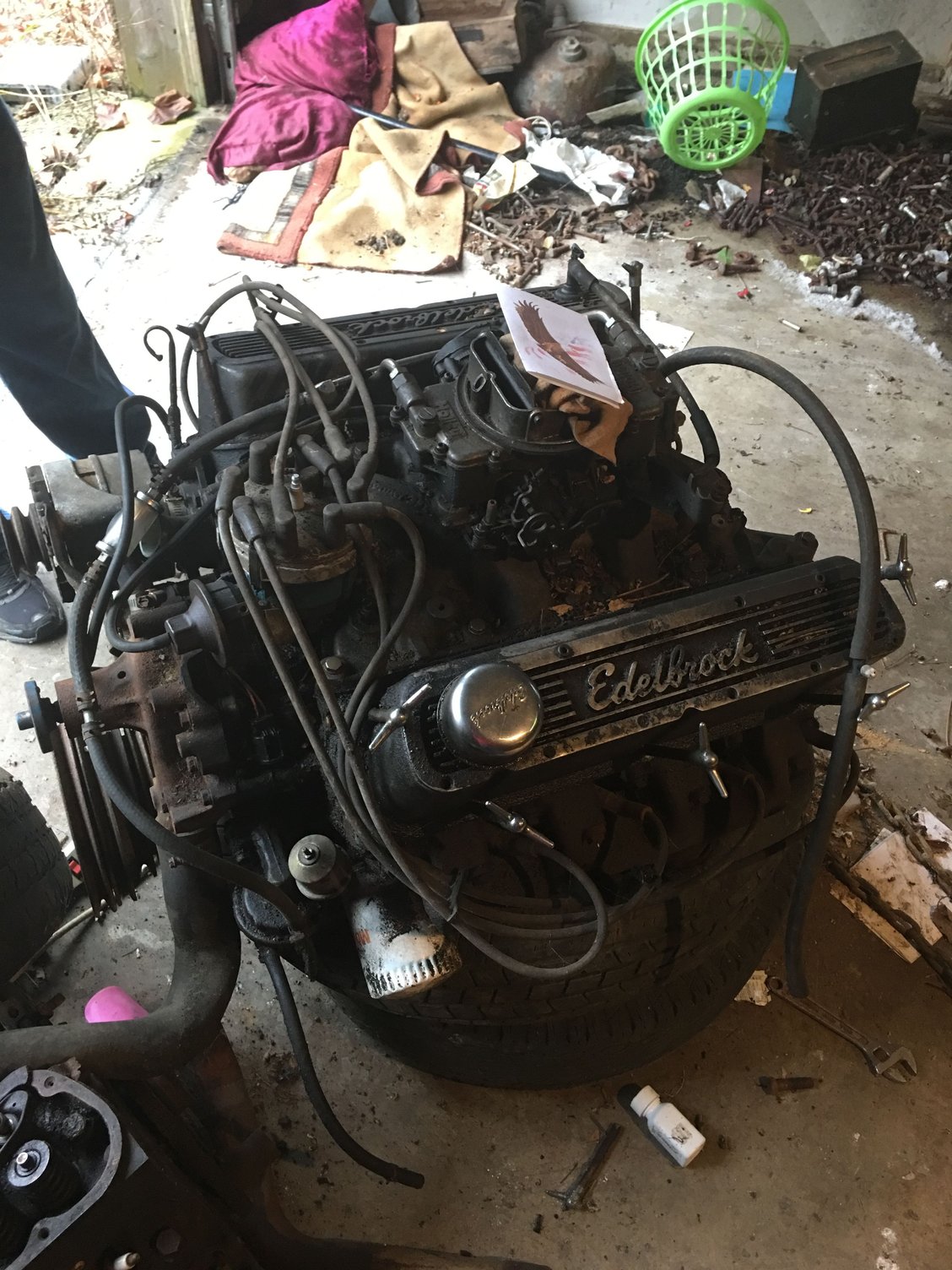

Long time no see. Sadly the truck still sits in the grass, I'm a full time college student and work full time so time is limited until summer. Anyways, went venturing around my uncles farm, found the motor in the garage that apparently has a few grand sunk in it, I can't vouch for that and I also am not for sure what motor it is. While plundering I found a near perfect grill and bezels for the F100 laying in the back of an old dump truck, and he also told me to use parts from his old bronco. It's an ex sheriff truck, I can't remember what packages it has but it's very rough. I might save it for a later day but I'm not sure yet. Anyways onto the pictures. Sadly I don't have any of the grill yet it's laying on my current project which is a dodge I hope the grill doesn't Infect it. Haha

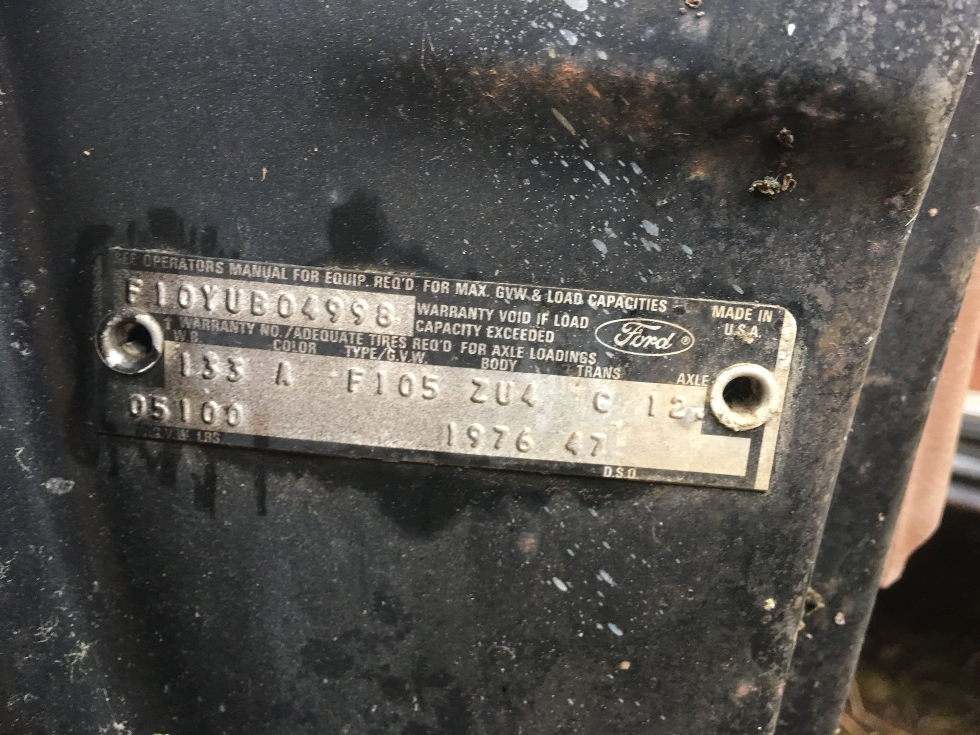

Ordered the marti report yesterday and paid for the rush because I'm impatient and this is what I received. I'm pretty stoked to see all the information these provide. Really cool and worth the money.

That engine looks to be a 302 or it could be a 351winsor hopefully the later.

It's supposedly a 351W but I haven't checked it out yet.

Judging by the width of the intake I'd agree its a 351W.

Sweet, he gave me a 302 eddy four barrel carb and intake in case I wanted to go that route. I think I've got in total four engines to choose from. I'll probably go with the Windsor as that's the way he wanted it.

The 302 intake will not work on the 351w. There are are adapters available tho.
