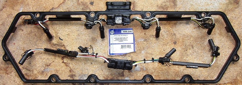

IDM codes are almost always a bad UVCH connection, which you can easily test by clicking the UVCH link in my signature. This will also cause issues with the glow plugs - so you get a two-fer.

I started at your step 1. https://www.ford-trucks.com/forums/1...-material.html ... I used the diagram to measure resistance across the injectors. It was very easy to follow.
On the passenger side I got a range of 4.5-5 ohms across all 4.
On driver side I got 3-4 ohms on 2,6,8 but 30 ohms on Injector #4. I verified this several times.
Does this indicate a fried injector?

Naw... it indicates bad connections with the Under Valve Cover Harness. Many people do what called a "50-cent mod" to correct this, but I have seen these fail (one on my own truck). I recommend either replacing both UVCHs (OEM from Riffraff Diesel), or going to the Dorman single-piece valve cover gasket.

I went with the Dorman single piece ones when I did my injectors and haven't had any problems

When I read the 30 ohms on #4, I did what any red blooded american would do..I went to the orielly auto parts parking lot and ripped my valve covers off. I did not notice any disconnected plugs. But for fun, I sprayed them down with contact cleaner and put some dielectric grease on them and plugged them all back together with the valve covers off. Fired the ole girl over and she purred like a kitten at a milk bowl.
I must have the second generation connectors because the way they are designed, the quarter trick wont work. But i definetly had a bad connection there.

As said above. UVCH. People have not had issues with Dorman. Maybe the only part they don't have issues with from Dorman. OEM is always good as well.
