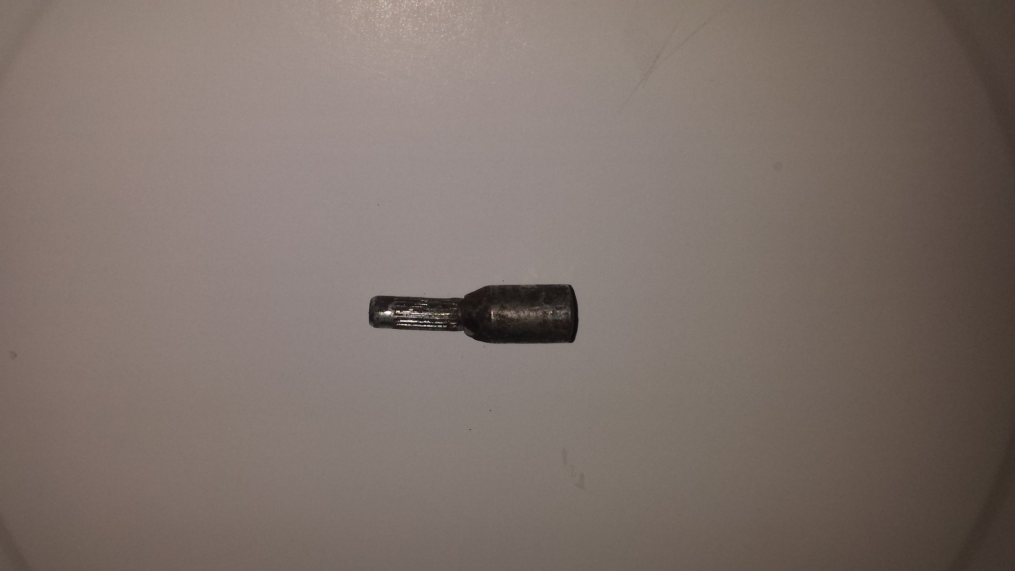

Update: success
Just an update. There was a peg pressed into the handle rod that prevented the rod from rotating far enough to gain access to the lead ball at the end of the cable.
The peg was in the small hole and the lead ball from the cable was in the larger hole.

There's 4 bolts holding the ebrake handle bracket (2 at firewall, 2 at dash). The clip at firewall in engine compartment. I also disconnected the ebrake cable under the truck for slack. The peg was pressed in, I used plyers and twisted it out. I don't know if this was the correct way but it worked for me.
Hope I can get the peg to stay in when I put it back together.

I thought the peg screwed out so I twisted it with vice grips and pulled and it came out.
Looks like there are ridges on the shaft to hold it when pressed in. I haven't reassembled it yet. I'll let you know how it turns out.
