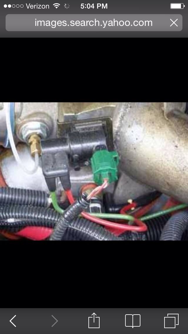

The black elbow on the red vaccum line is leaking air in a boost leak test, how do I fix it? I have the the other end off the wastegate and on the boot clamp. I am getting a loud squealing/tea kettle noise at high boost pulling trailer. Thanks.

If it's not connected to the wastegate actuator, it isn't doing anything anyhow. You can just disconnect it from the manifold and cap the nipple. If you want to reconnect it and keep it operational, those elbows are available. I bought some at Advance Auto Parts.
