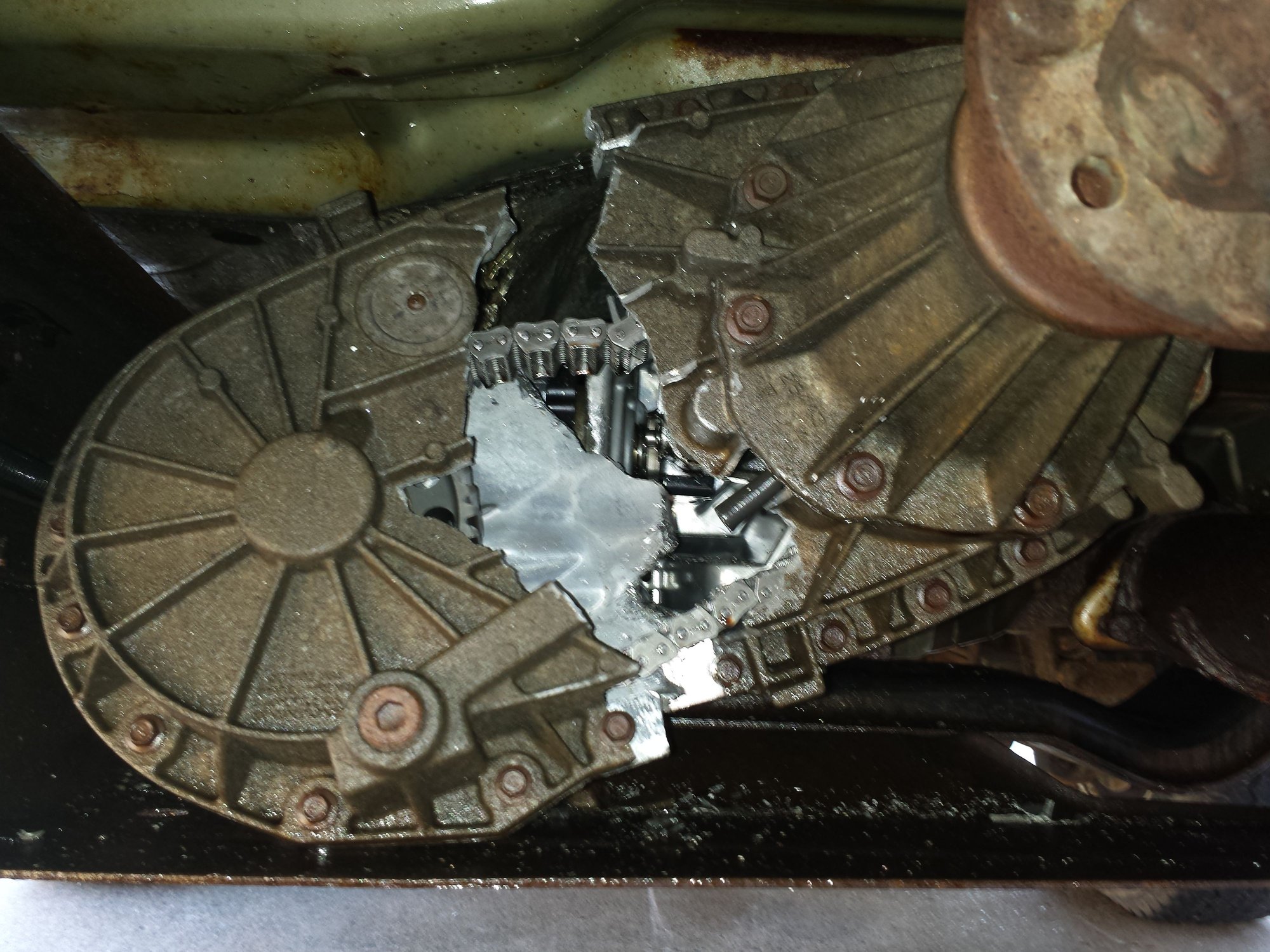

Running on pavement is your first issue. It binds the drivetrain, bad. Here's what happens if the hub does hold.
Be glad the hub popped out. I'd disassemble the hub and check the cog in the middle as most by design act as a fuse.
HOLY CRAP!
glad it did "pop" out!
I'll pull everything out and check parts and alignment this week then test drive on a hardpack dirt road this weekend

Likes: 94
From: So. Jersey
The customer who owned that tcase had a job that he used 4wd to get to. He left the job and forgot to take it out of 4wd on the blacktop. He made it a few miles and as he was on the long sweeping accelerating right turn entrance ramp and he said he heard a clunk and noticed he had "a leak". He was right, it definitely leaked. Lol. It took a lot to get it out of him to admit that he may of left it in 4x4.
That was a 2001 Excursion 7.3l with 3.73 or 3.55 ratio front and rear. (can't remember which) Luckily I found a used tcase for him and all is good.
