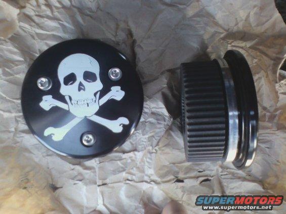

Drive slugs aka Drive flanges are a solid chunk of metal that slide into the hub to lock the hub to the axle shaft. Can't unlock them without tools. They are basically what the old full time 4x4s had in the front hubs.
Here's a Drive slug. The splined part goes in with a flat plate of steel with holes in it, and is held in with snap rings, than the cap screws on. If you want to unlock it you remove the splinned part and reinstall the rest of it.

Very cool!
I'll be investing in that for when I go on long or strenuous ventures. But for the quick sandy or muddy shortcuts I like to take around here a turn of a dial is more appealing, but I guess with a drill motor it could be a pretty quick swap out.
thanks for the info, extremely useful!
