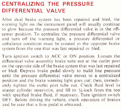

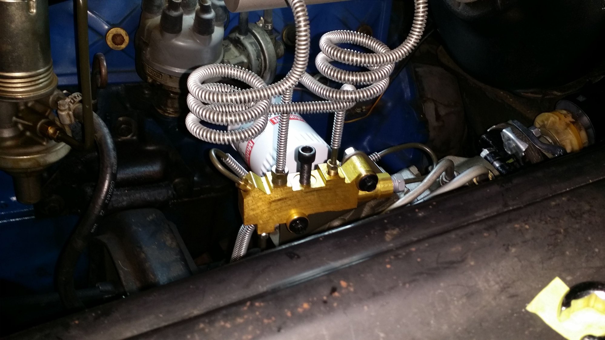

One major obstacle that needs to be corrected is to get the pressure differential valve back to center, to turn the brake warning light off and to restore full fluid flow to the front and rear brake circuits through the brake pressure differential valve.
Ford procedure for doing this:
When it comes to bleeding out the brake system, I never have help doing this. It's just me. However, Speed Bleeders, not dogs, are a man's best friend. I don't know the diameter and thread pitch of what an F250/F350 brake bleeder is but, if they are 3/8"-24 like an F100 (or F150 Dentside front brake calipers/rear wheel cylinders), the Dorman part number for them is 12701.
Once the pressure differential valve spool is centered again, having a valve lock tool to keep the spool centered, while bleeding the brakes, will be a MAJOR asset.
https://musclecarresearch.com/brake-valve-tool
