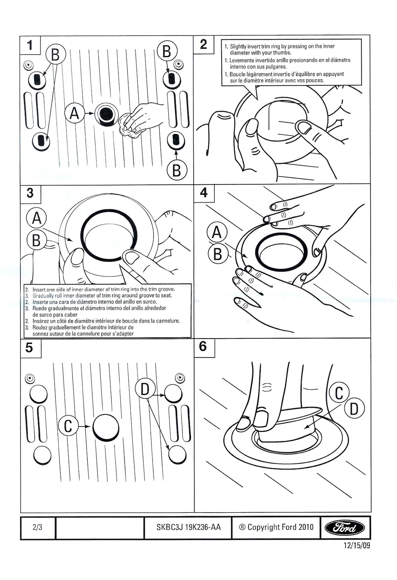

Here is a copy of the instructions that Ford supplies with the Hitch Prep Kit plugs.
