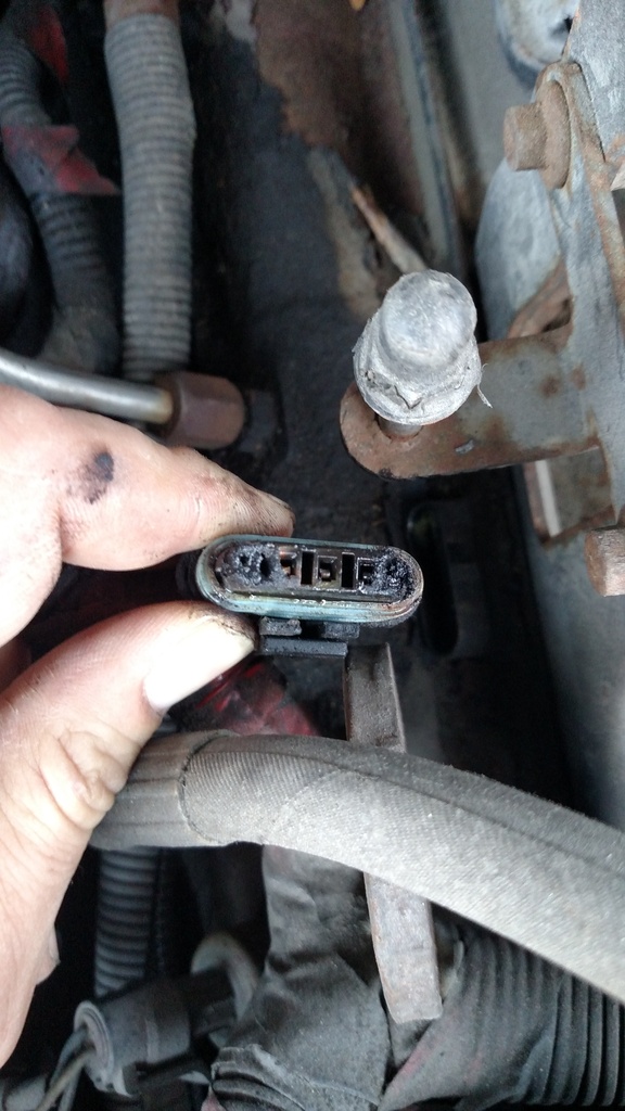

I finally took a couple minutes to look under the hood and check connections. Driver side front valve cover plug is burned.
Anybody have a good link to replacing it/them and parts needed and best place to get them? Thank you

SD ones are an upgrade with only one external connector and a bit cheaper than stock but have an internal connector.
Doorman makes a one with no internal connector and life time warranty
https://www.ford-trucks.com/forums/1...-0-50-mod.html

Thank you. I did a little searching and saw that. I think I'll go that route. Doesn't look too bad
