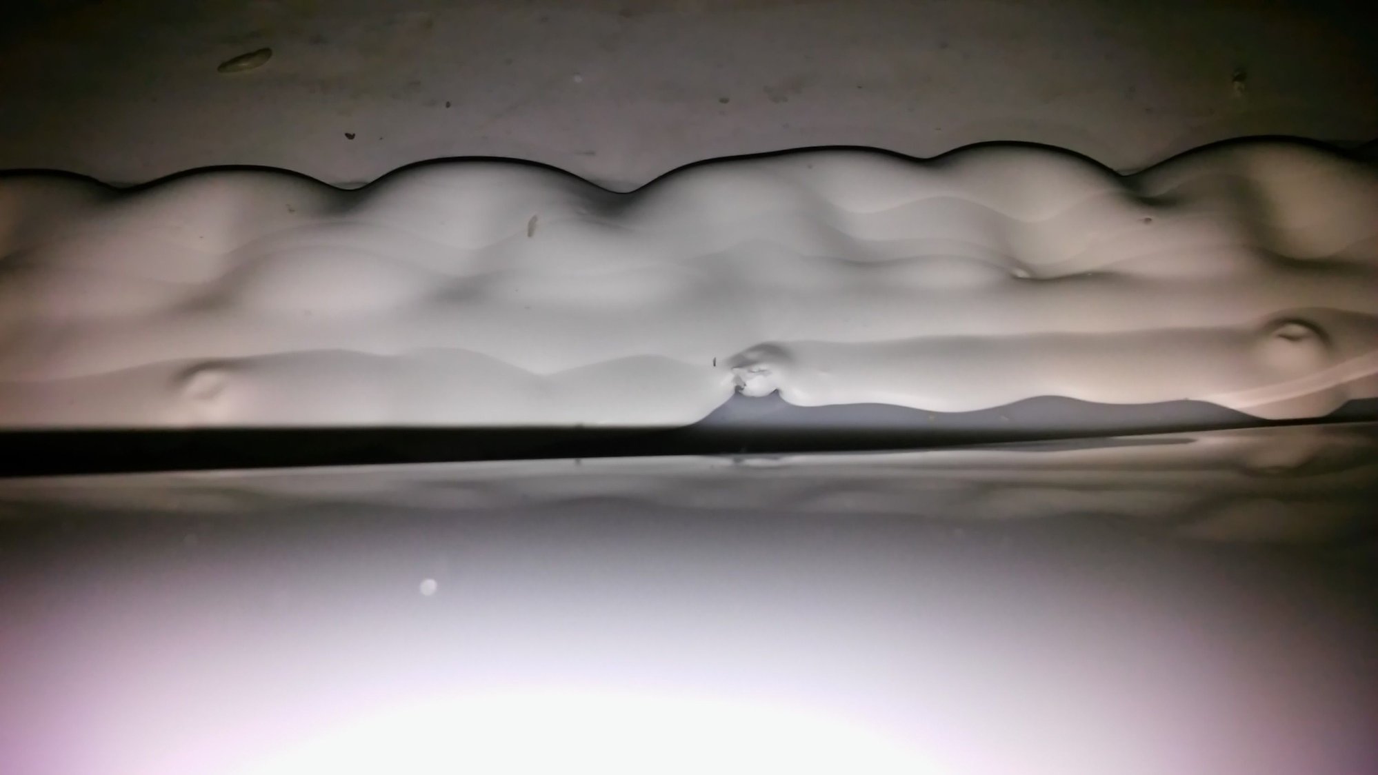

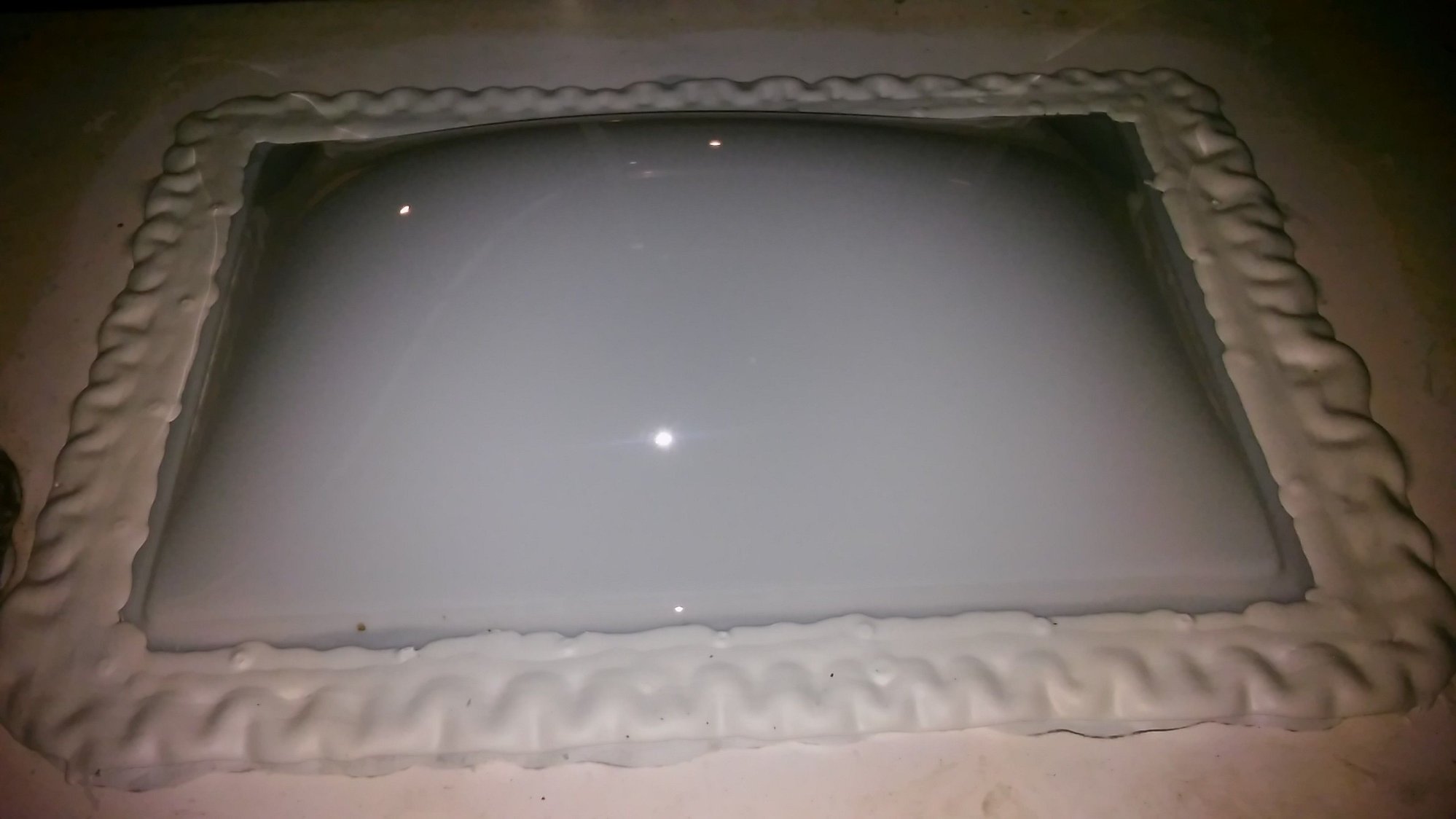

I got up there last night and I found two screw heads that weren't covered with dicor. I've got some pics but my phone and computer are in some kind of internal battle so I can't upload the pic...
not sure if I need to use the other tube of dicor or not. hate to open the tube just for two ounces, but I would hate a leak worse ...
dilemma dilemma
another thing I noticed was that the dicor was pulling up on the roof as it cured. you could see where the dicor was lifting the rubber away from the plywood as it (apparently) shrunk as it cured. looks totally different than it did before. weird stuff.

Do you literally mean they were not covered or do you just mean the dicor sunk down into the screw? Not covered at all means something. Just sunk down, yawn.

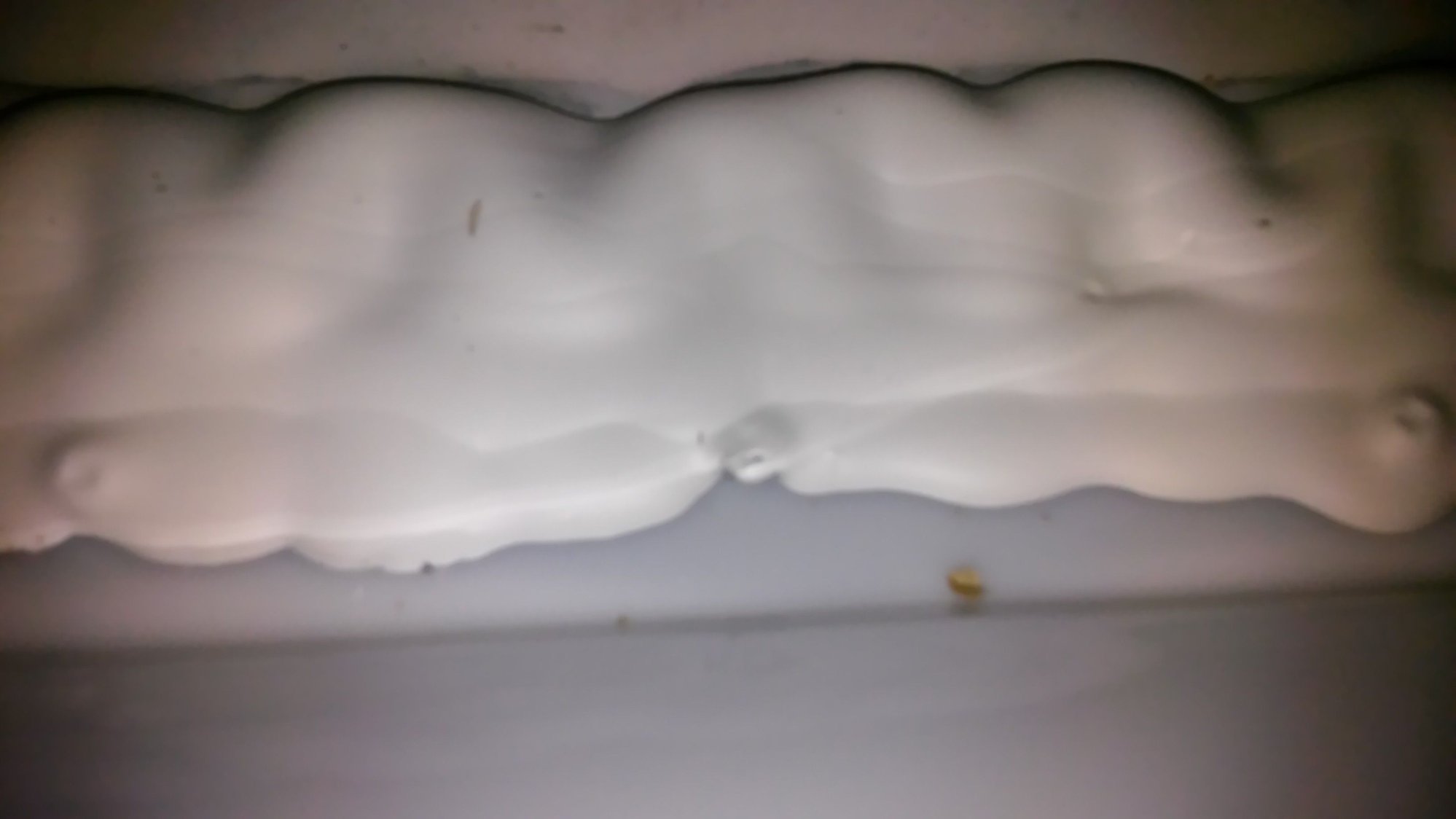

The first one is probably the worst. there are a few scattered around that probably look like the second one.
I did run the screws through the butyl tape.
is it worth burning the other tube of dicor?

Not worth it in my book. I would catch it sometime in the future during routine maintenance.
