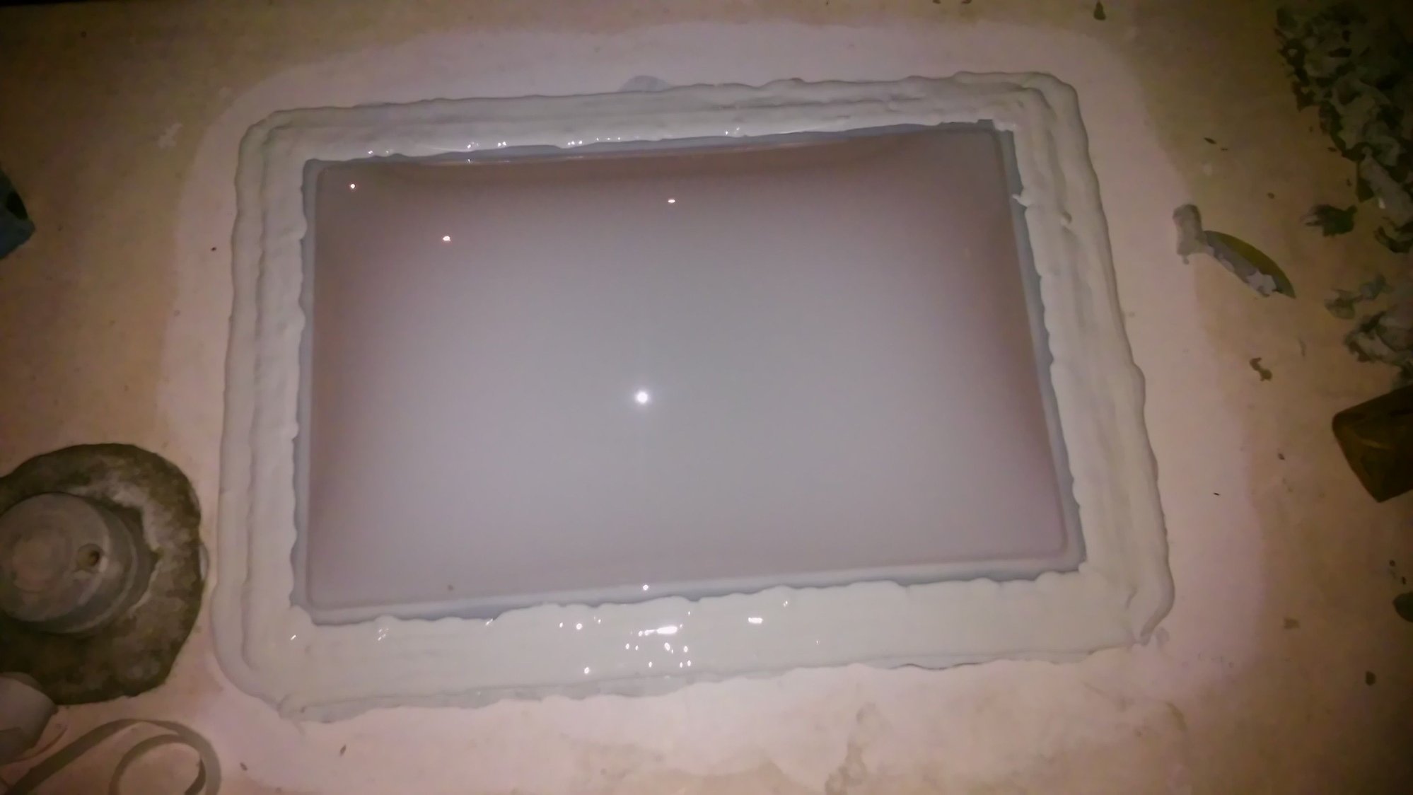

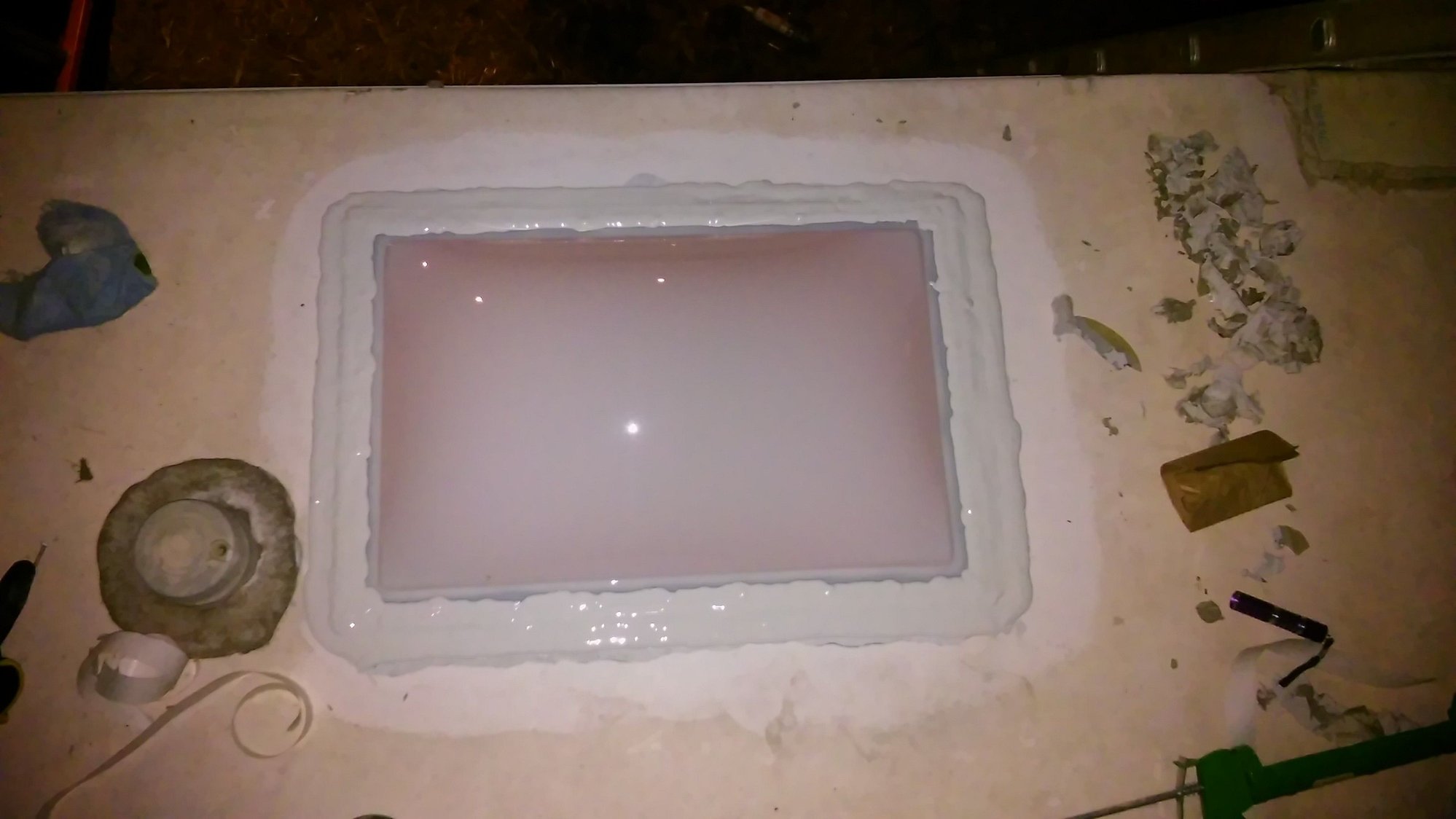

Got mine done last night (Finally!!!) about midnight.
how's it look? I used the butyl tape underneath across the screw holes, then covered them with dicor, and the went around the edges +1/2" with dicore and then filled everything in.
how'd I do? never done this before.
one thing that really sucked, is the old dome flanges were quite a bit wider than the new so some of the old screw holes were left exposed and I had to just cover them with dicor. I had thought about running a strip of tape across the old screw holes, but thought the dicor would be good enough. used two full tubes of dicor, and have left "just in case"
A tip for anyone doing this: use a heat gun on low to warm up the butyl tape and dicor during removal. judicious use of a heat gun on low makes the clean up a BREEZE. the stuff will scrape right off leaving very little left to try and remove with a rag and adhesive remover. at least that's what I found.
is there anything I need to touch up, or is this about right?
Old Jun 9, 2016 | 09:40 AM
wrvond's Avatar
wrvond
Joined: Oct 2015
Posts: 2,745
Likes: 72
From: West Virginia
It looks better than factory.
Naturally, now that the job is done, I'll say I would have used Eternabond tape for the project and skipped the butyl rubber and dicor altogether.
