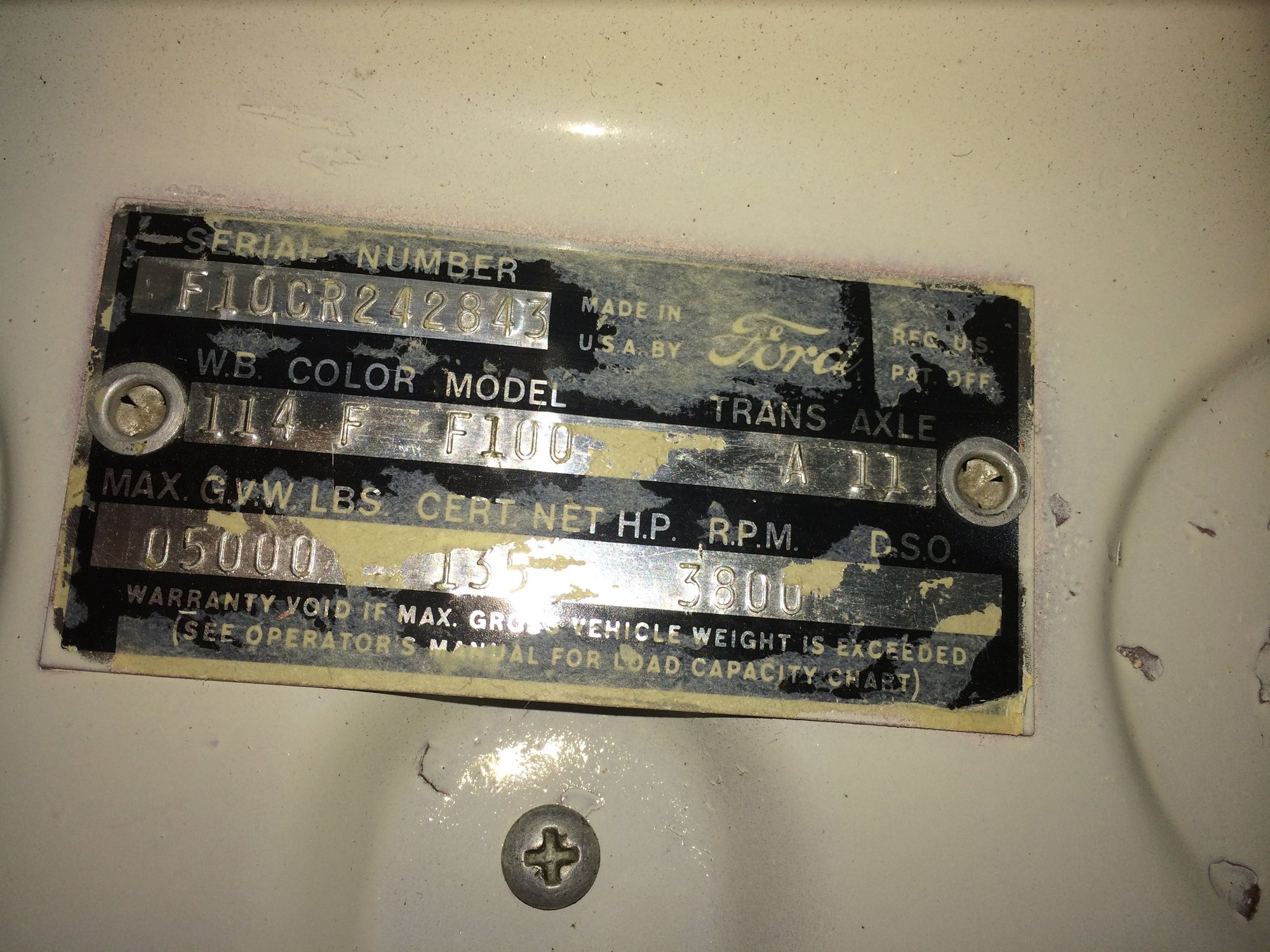

Look on the inside of the glove box door for the Warranty Plate and post all the codes from it.
I finally remembered to go out and take a picture of the glove box tag. It's not a very clear pic, because it still has masking tape residue on it.
114" Wheelbase.
F = Baffin Blue.
F100 2WD .. 5,000 lbs. GVWR
A = Ford 3 Speed Manual Transmission.
11 = Ford 9" Rear Axle / 3.70-1 / 3,300 lbs. Rear Axle Capacity.
5,000 LBS. Gross Vehicle Weight Rating. 135 net HP @ 3,800 RPM

Interesting that the eng, tranny and diff weren't all together. I knew the truck was originally for out your way, but I thought it was more northwestern, like maybe Oregon. Maybe it was built in California and shipped to a dealer to the north.
VIN decoded in post 2 .. it was assembled in San Jose CA
1956 thru 1979: Most trucks sold new in AZ/CA/NV/OR/WA were assembled in San Jose.
