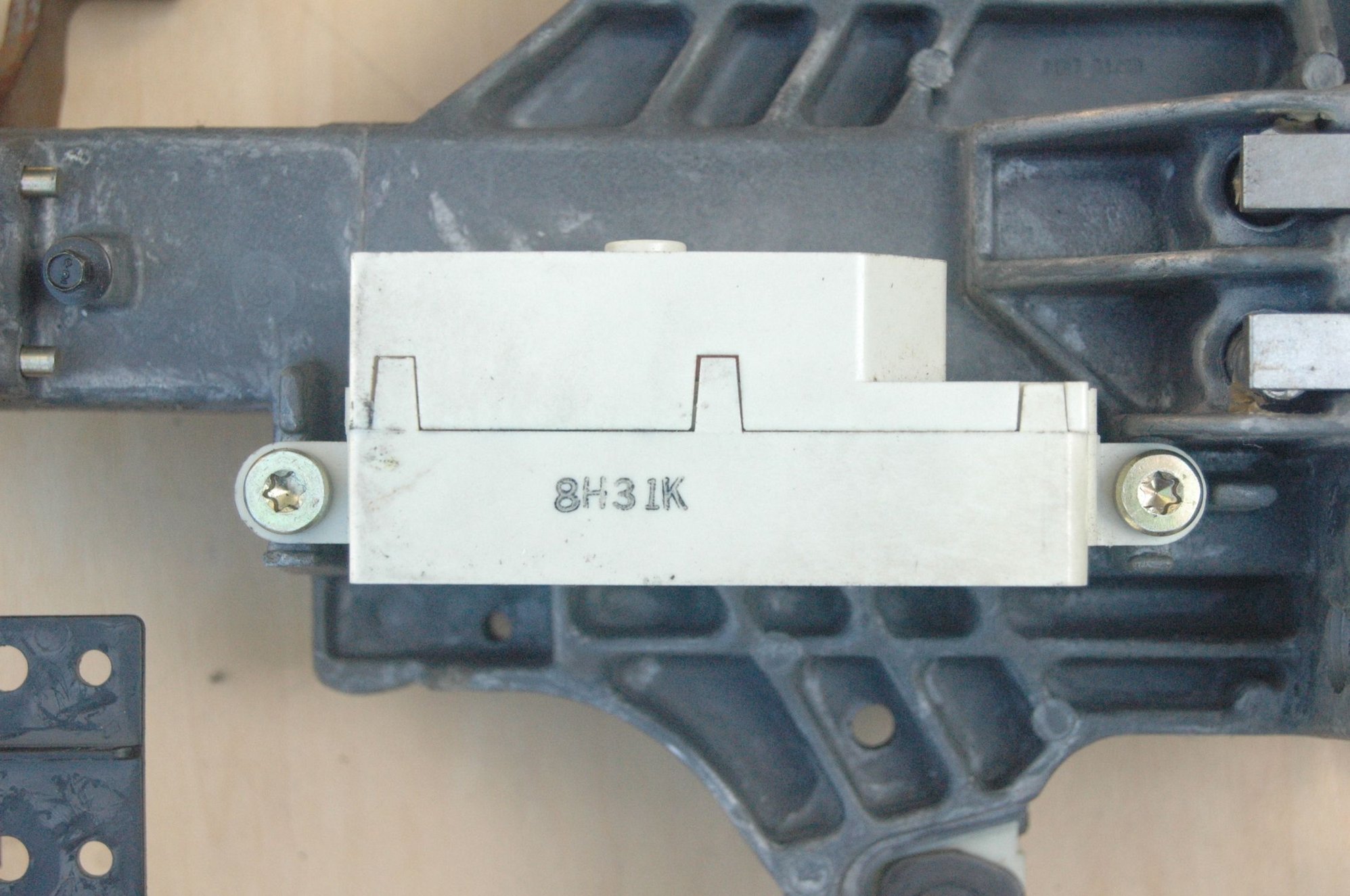

The actual ignition switch is somewhat easily removed with two Torx headed bolts holding it to the steering column main structure, shown here:
There will be a cable & connector attached naturally, this image of a column not installed. Moving the short stem sticking through the switch on the unseen side can start the van without any problems.
