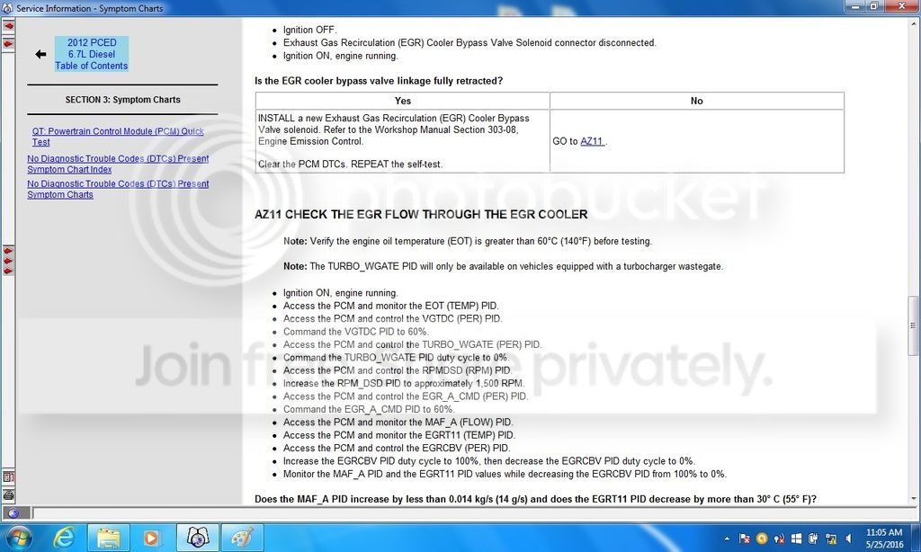

Old May 25, 2016 | 12:21 PM
shadetreezj12's Avatar
shadetreezj12
Joined: Dec 2015
Posts: 69
If your somewhat mecanical, you can at least check the basics folowing the flowchart.
You'll need the VCM stuff with the accessories to perform the advanced tests, as their called for.
FYI, this info was taken from the 2012-2013 service information (Think Factory Service Manual) that can be found on Ebay) for a few bucks.
It's a great reference to keep!!!
