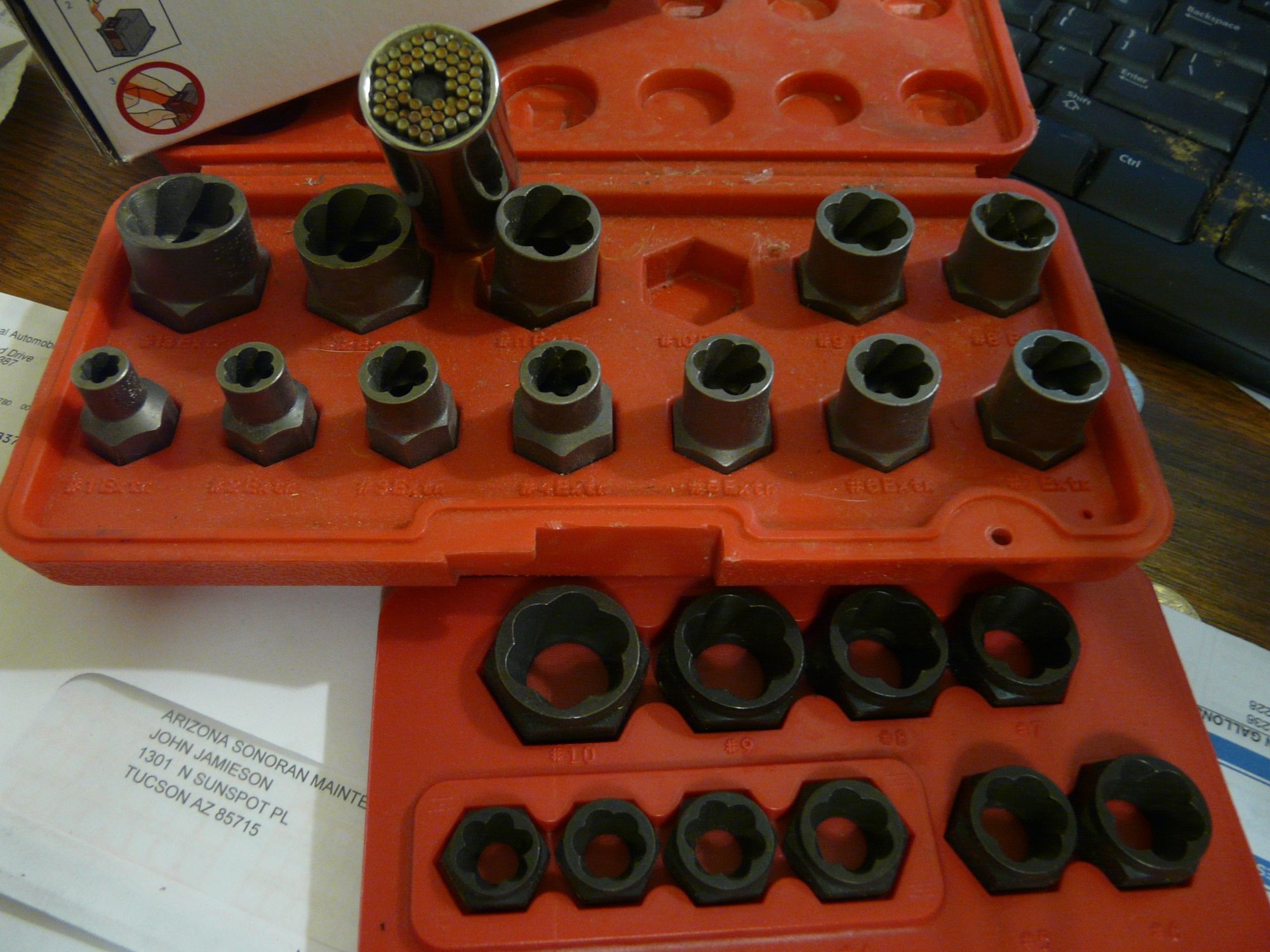

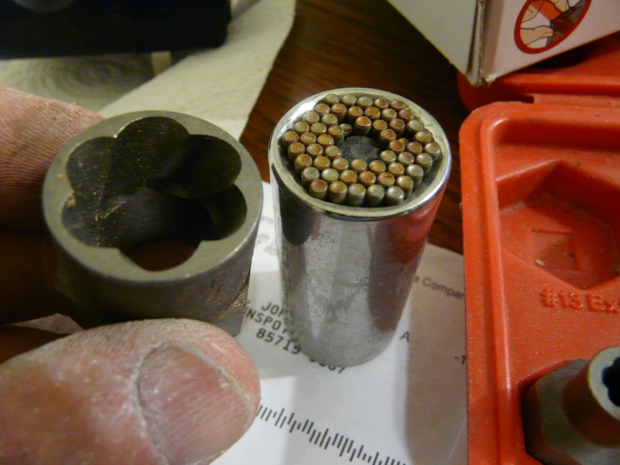

Here are two things you can try. One is called a Gator socket. It has a bunch of pins in it to catch on the bolt head. The other is a head that has spiral teeth in it to catch on the bolt head. They can be placed on the bolt head and turned with a wrench or placed into a larger socket. I got my sets at sears.

Yes tried turning motor by hand and is free. Will try gator sockets since can be turned with a wrench. There isn't enough room for a socket and ratchet between the bellhousing and starter.
