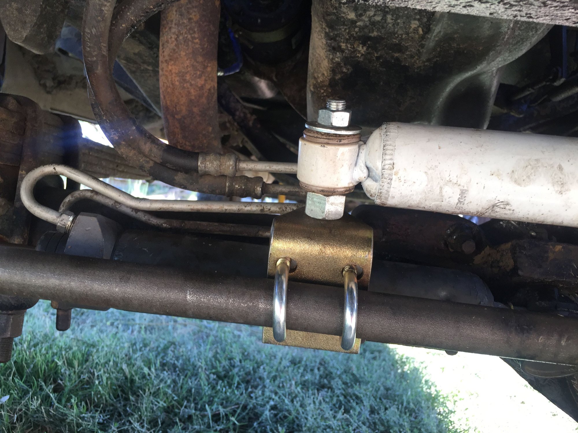

Old Aug 14, 2017 | 12:53 AM
  #35
perkint's Avatar
perkint
Joined: Nov 2014
Posts: 135
From: Seattle
Originally Posted by RichS2659
Perkint, take your truck to a good 4wd fabrication shop where they can make a u-bolt plate mount for the steering stabilizer just like the 99-04 Super Duties use. You could have them make u-bolt skid plates to protect the u-bolt ends under the axle at the same time. It is what Jeeper's do also. I take the use of a stabilizer as a Ford factory-engineered OEM option as a useful item.
i took your advice and took it to the great guys at S and H 4x4 shop in Sacramento, a shop that does a lot of work on jeeps. While they advocated the full power steering system replacement from a 77.5 -79 Ford 4x4 (I'm assuming that they would have used the Benchworks steering kit for 67-77 highboys), they agreed to add the steering stabilizer, especially after I told them I wouldn't be doing much 4 wheeling, other than work on a farm and occasionally driving in the snow.
Here's what it looked like after completion.
