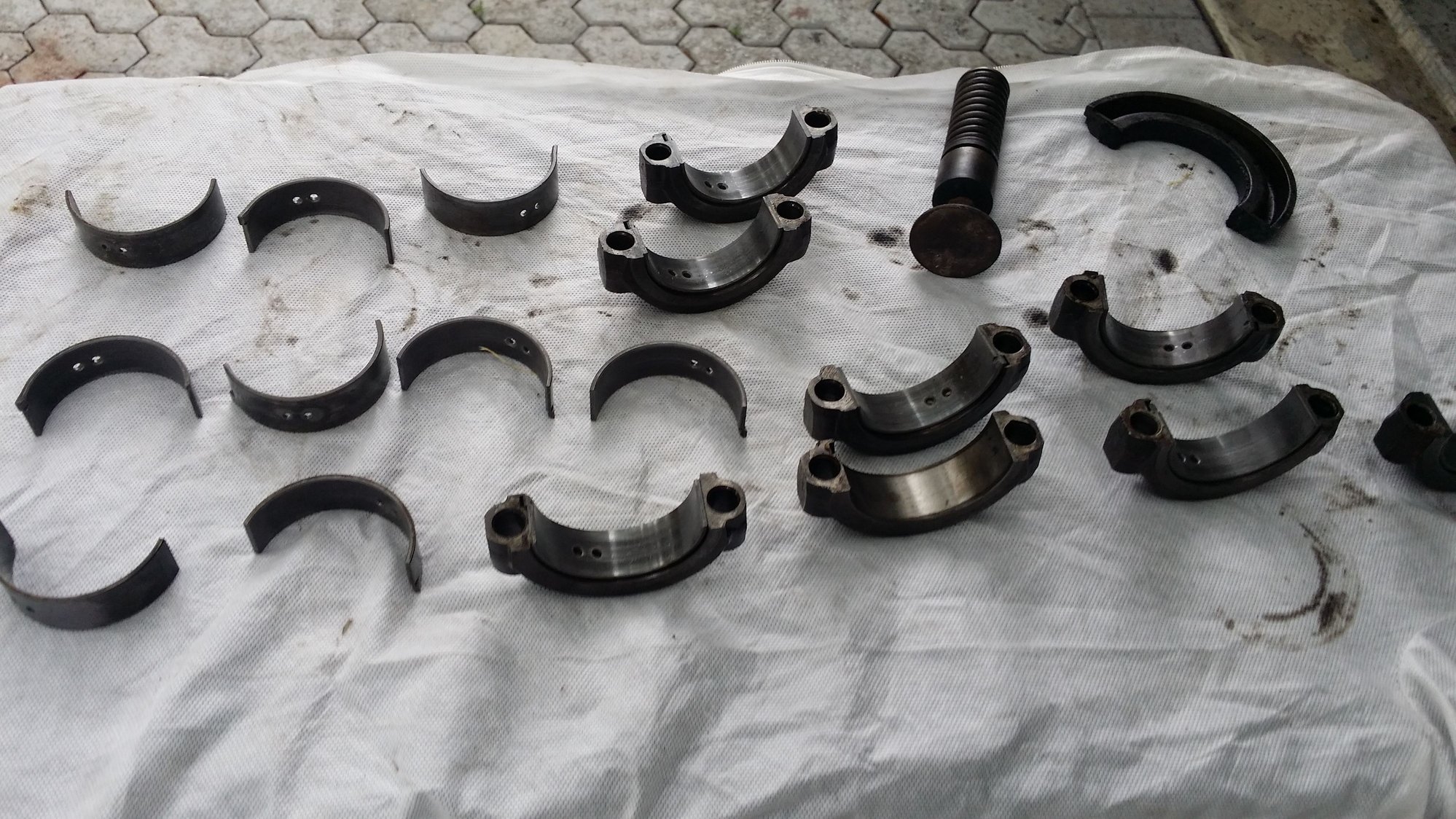

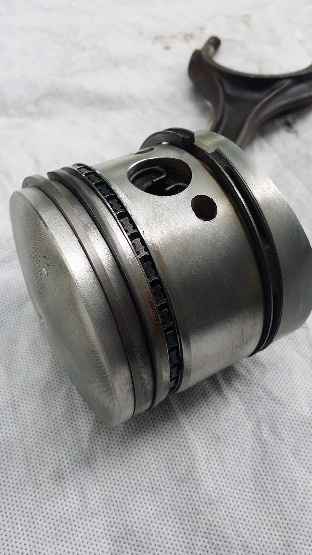

Thanks everyone for your input..yes I will spend the money to have the block checked out as some have suggested and I've decided new valves are the way to go so I'll probably buy the set of valves and related parts and give to the machine shop for proper fitting etc..I guess this is the right way to go with this part of it. Haven't decided on the pistons yet but I'm hoping to reuse them and replace rings and maybe even the bearings..take a look of bearing and piston pics below they seem to look ok?

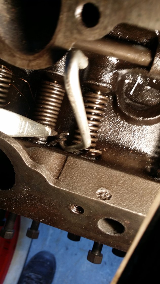

In the meantime I'm having a hell of a time getting these valves out. Got the first on out fairly easy and spent nearly the entire day today trying to get the second one out..so I've decided to ask for help (again).
Please take a look at the pic below to try to see what I'm doing wrong..I can't get that retainer(horse shoe clip) to come out with a fully compressed valve spring..I'm losing this battle. Please help. Thanks

First thing is to get her cleaned and MPI'd. I don't want to scare you, but the #6 cylinder appears to have an indication from the cylinder to the intake valve. It has to be cleaned, maybe it is just the carbon.
If you want her to run cool, getting the water passages cleaned is paramount. Four ring pistons are what it came with, but 3 ring Pistons have less friction heat.

It appears you have the bearing shells mixed up (not with the rod/cap they came out of), so you have to replace them. They don't look awful, but clearly worn too. What was your oil pressure before? What U/S is marked on the backs of the shells? Is there a date on them too?

Yeah..my oil pressure always sat around a low 30 psi..bothered me since I read it should be around 50 psi..temp always a problem but assumed there was an issue with the senders.
Hey guys..you're throwing a lot at me and I appreciate it..believe me if I don't understand all the jargon..ie: "clogs in the throws" or something like that I research it usually that same evening..just be patient with me I really want to understand this stuff..I'm having a blast!!!
I'm going to replace those bearings and rings..but I'm hoping to salvage the pistons so i don't have to spend $$ on piston cylinder rework. This truck is a driver. I drove it for 2 years until my wiring harness burned up. I decided then it was time to begin my restoration project. So here I am a.. "first timer"" appreciate your support. Thanks.
