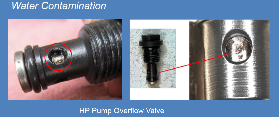

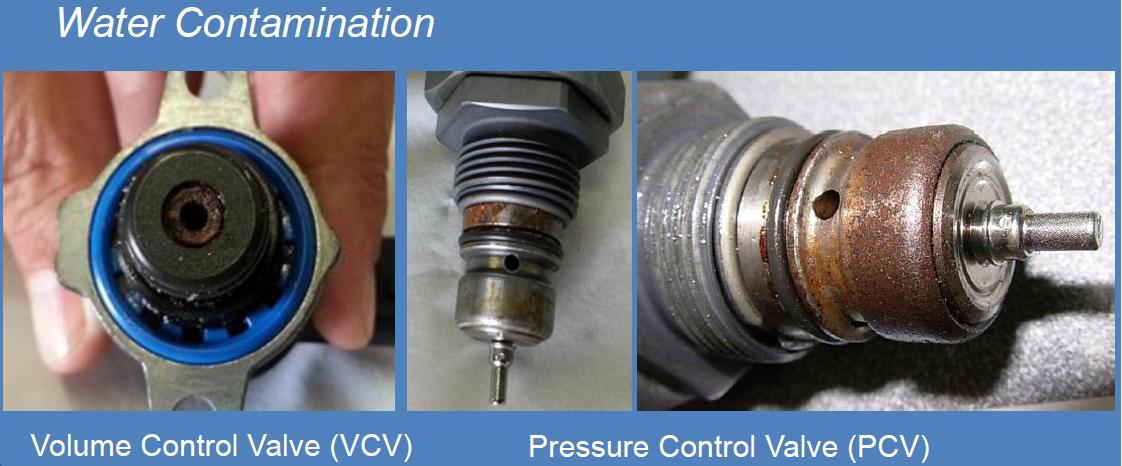

Ever wonder why there are reports of pump failures and trash in the fuel system, requiring a $9,000 repair that people fear so much on these motors? Now you see why, because a vast majority of these failures is fuel contamination, and way too often this contamination is unknowingly caused by the owner using the wrong products. These engines aren't like the old days where you could throw any additive, trans fluid, WMO, etc in the tank and expect it to continue running for many years. These motors are reliable, but only if you use known quality fuel at higher volume stations, and refrain from putting anything else in the tank other than cetane boost or anti gel when needed.
This is what dealer technicians will look for when a truck comes in for water contamination:

This is the worst response ever, especially when used with common rail. Diesel Kleen is actually admitting that they are trying to contaminate the fuel with water.
These motors require as little water as possible in the fuel, not adding more. Water mixed with diesel at well over 20,000 psi is no good. You also end up with corrosion issues at the pump and elsewhere.
