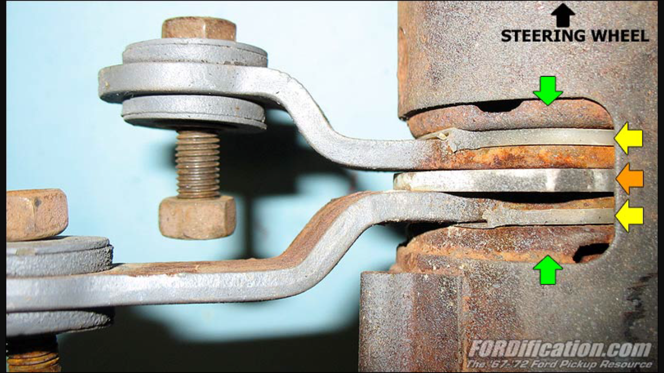

Originally Posted by MarkinTexas
Hey Muth - no help here (yet), but I've got a '74 that was converted from 3-tree to a floor shifter and I wanted to put the 3-tree back in. I've rebuilt the column, but don't see how the linkage goes (for one of the shift rods.) Do you possibly have pics of how the shift rods go from the column to the tranny? There are some strange/added brackets on the tranny, and ne of the rods doesn't even seem to be close to fitting. (Not even sure if it's the correct one??)
Maybe if I can get mine going, I could possibly have some input here for you?? Thanks!
This is the one I found on the Internet of the column arms, if this one doesn't help, I can go take a picture of mine.

Hey - yeah, I saw that pic when I was rebuilding my column. What I was looking for was a pic of how the 2 shift rods are routed from that column pic above to the tranny. (Probably best taken from underneath so you can see the side of the tranny where the rods mount...) It's like I can match-up one rod, but can't figure-out how the 2nd one goes. It does not seem to match-up at all...
