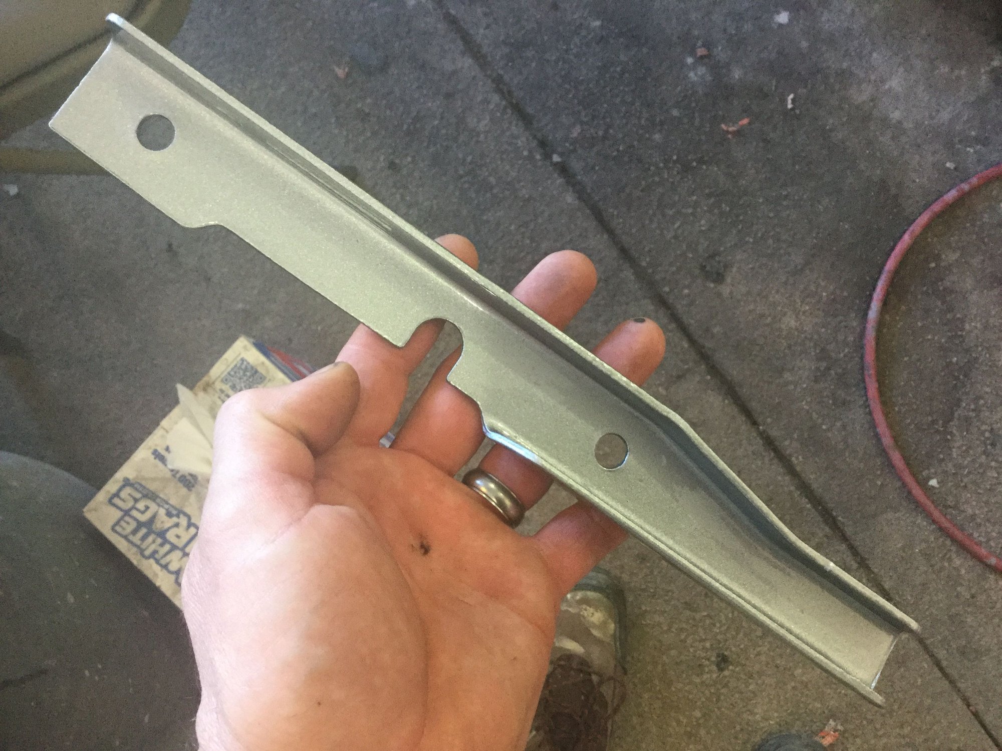

The truck in question is a 79 F150.
The trucks been torn apart for a while now and we're putting back together but can't figure out where this part goes. There's two of them!
Please help!
Don't know where this goes on my 79 F150

Those look like the hood hinge area stiffener brackets I have seen on some 78-79 pickups and broncos. What you have pictured-from what I can remember would go between hood and hood hinge.
My truck doesn't have them but i have seen them on other trucks in salvage yards.

What Orange said

Thanks guys, we're not putting em on. Hoods on already lol

X3 on hood stiffener. Part #16C805

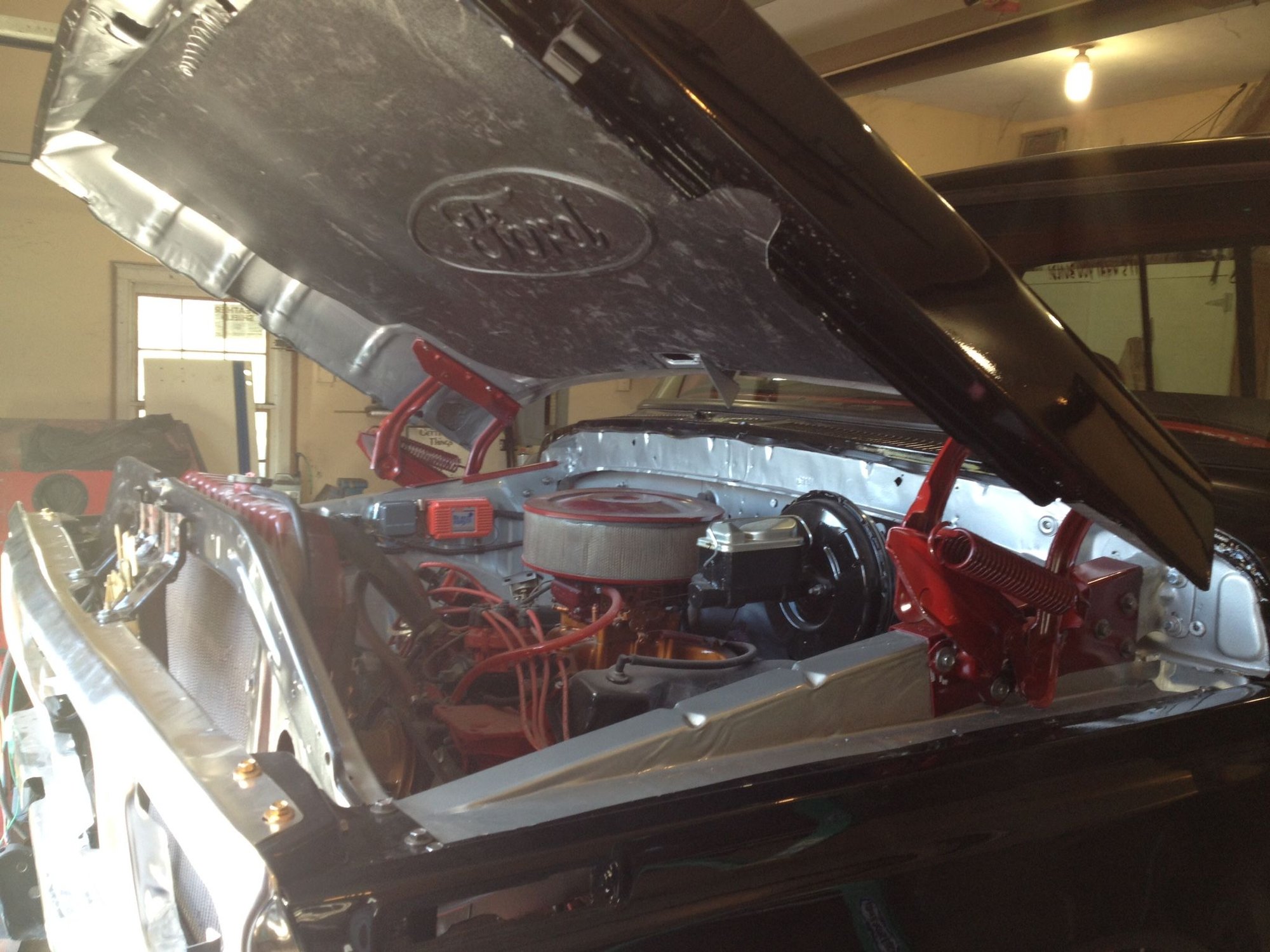

As mentioned above. Part of the factory solution to having the hood keep from hitting the windshield in event of a front end collision. I see you got the center piece in place.
See the circular cut out on the side of the hood, about in the middle? Supposed to help the hood " bend" in case of collision.

That's a sweet under hood liner where did you get that

Yes looks like what i need .
LMC sells it, but it ain't cheap

The hood liner came from LMC
You can also get the underhood liner from these people.
