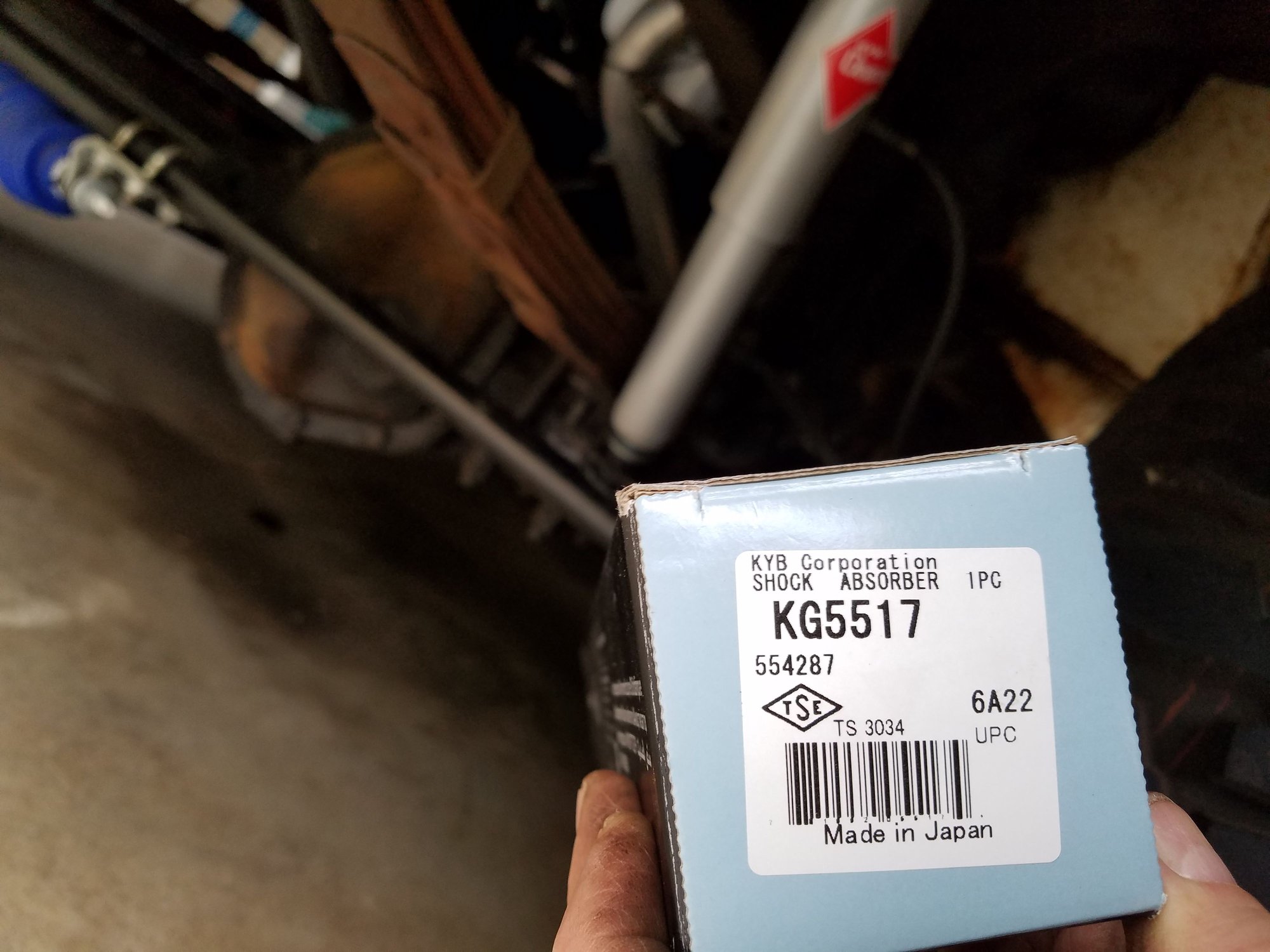

Here's the part#
Toyota Landcruiser front shocks fit nice on my 59 4x4. Rav4 on rear
Old May 6, 2016 | 02:39 PM
chetspencer's Avatar
chetspencer
Joined: Jul 2006
Posts: 1,181
From: Fairfield, CA
OK I just did a test ride to Harbor Freight and back, I'm very happy with the ride, It rides just as nice as my 2005 Excursion (sort of proud to own the first and last leaf spring 4x4 trucks Ford ever made )
