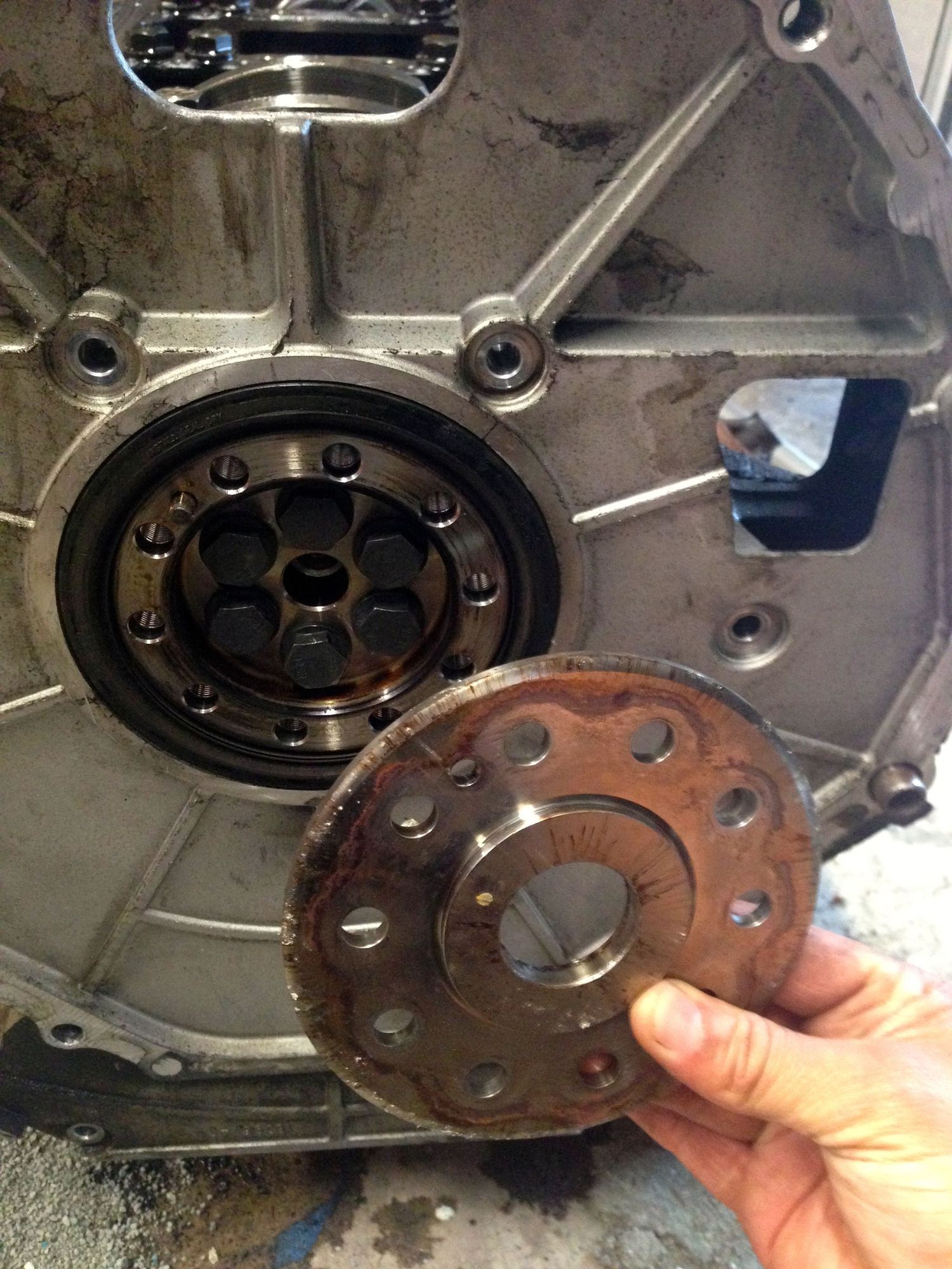

Originally Posted by Ray Castillo
Sorry, probably a dumb question. But on to the next worry, on my 2005 it has what the fly wheel bolts too and on the engine i bought it doesnt. And idk how to take that off. Is it a puller that needs to take it off?
It's an adapter plate. Puller or good pry bar. One thing you don't need (or want) to do is remove those other 6 bolts holding on the crank/flywheel adapter. That piece is machined and balanced with the crank.

^^ what he said.
When I re-sealed the rear cover, that plate stumped me for an hour or so.

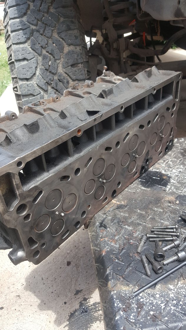

Are the rocker assemblys different from a 2003 head to a 2005? If so how?
Please clarify. Rocker boxes or rocker arms? Actually, to that point, yes and yes. The rocker box issue you've already crossed that bridge with regards to your high pressure oil rails not bolting up. The 2003 engines use a metal wavy spring type metal rocker arm pivots while the newer 2005 engines use plastic pivots.
Since we're on the subject of differences between model years, the 2003 engines use a deeper piston "dish" with a slightly longer glow plug than a 2005 engine with the shallower "dish".

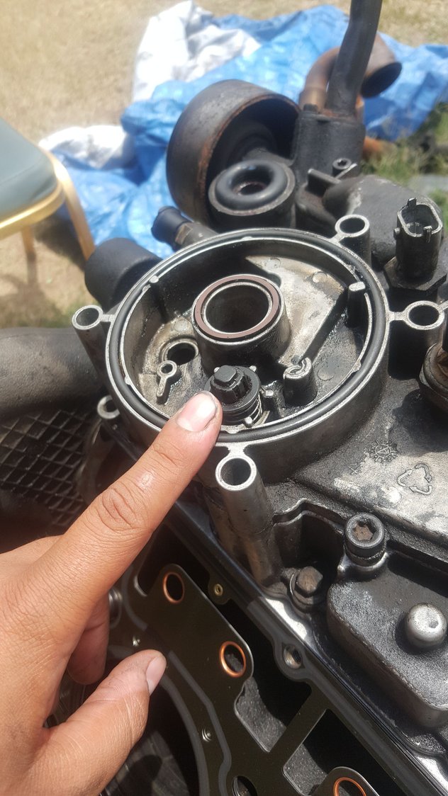

Side question, this piece has 3 prongs and 1 broke do you recommend new replacement? And guys I really appreciate the help
