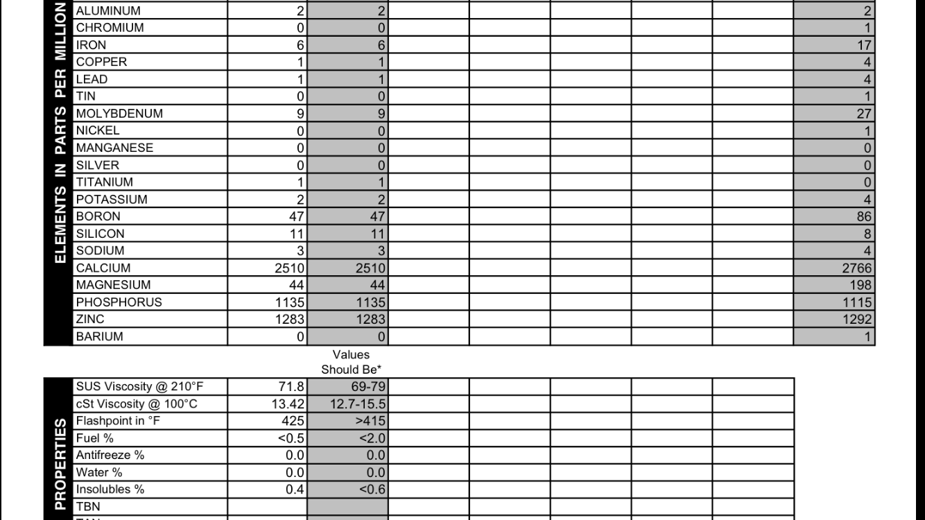

My blackstone report
Hope this pic worked. Is there anything I need to worry about? Blackstone said all looked good. Readings on left side are mine

Wear metals are all in the signal digits which is always good. How many miles on the oil?
About 2000 at the most

Well then that makes sense cause it looked like oil out of the bottle. However give the VERY low mileage insolubles are higher than I would expect. I would just make sure you don't have a leak in your intake anywhere and make sure your filter is clean and oil if applicable. I would just monitor it for the next UOA.
Thanks. I will send another sample at 5k miles
That's a good plan. Next time wait till at least 3K miles.
What brand of oil?

I run motocraft. Run delo sometimes as well

sounds good.....that explains the residual Molybdenum additive.
How many miles on the vehicle?

167k miles

As RufusHusky posted, wear numbers look great. Silicon is low so you air filter is doing its job as well. Which air filter are you running?
No signs of coolant and your viscosity is holding up strong as well.

Running the afe big boost filter. Same as 6637 but has screen on top as well
