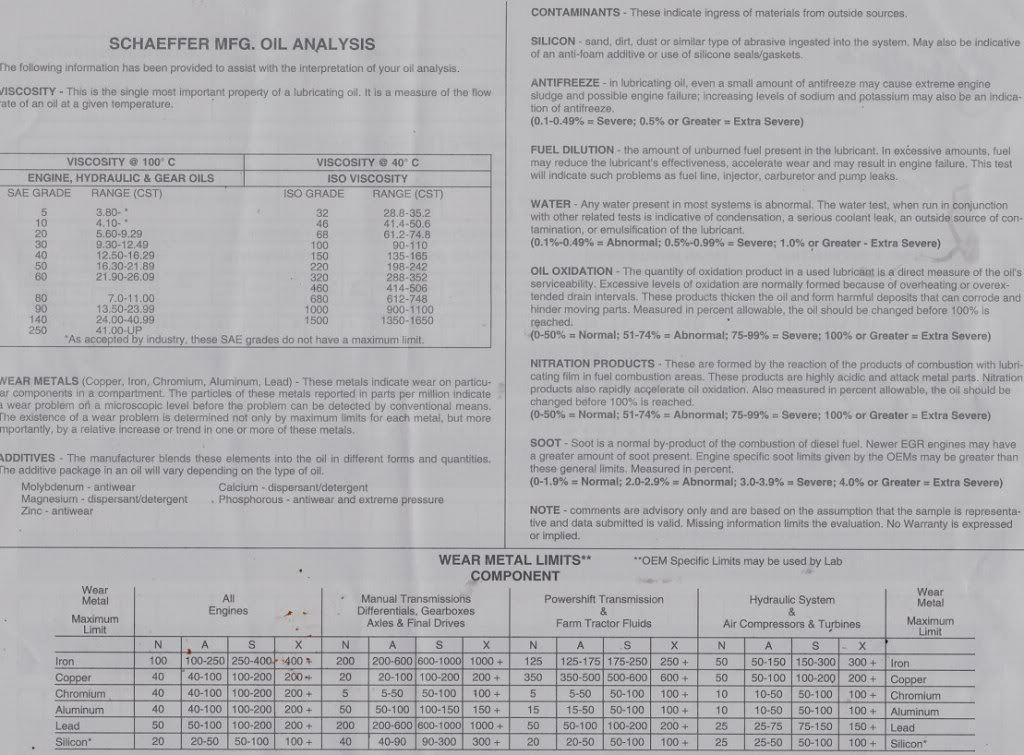

I'll add some links & info here so the info can be found on one thread instead of searching the web.
Here is a couple of links that explain the values you would see on a UOA.
Frequently Asked Questions | POLARIS Laboratories®
Cheat sheet for newbies reading UOA's | Used Oil Analysis - Diesel | Bob Is The Oil Guy
here is the backside of a Schaeffer's UOA report explaining the values reported.
