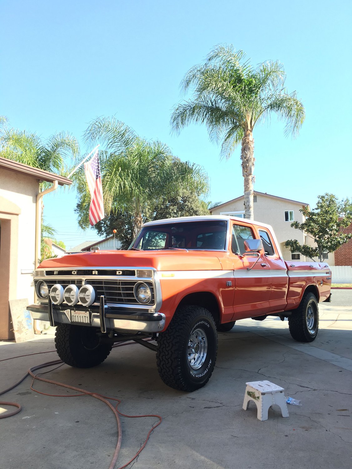

So I have a 1975 f100 supercab, don't hate me, but it has a 355 small block Chevy with a turbo 400 trans. The engine is built pretty good since it came out of a dragster camaro. So the problem is while I'm driving down the road the engine will randomly shut off on me even though I warm it up to operating temps, is it the fuel pump going out or the carb needs an adjustment? I'm really lost so if anyone can please help me out its killing me I just wanna be worry free while driving again!
