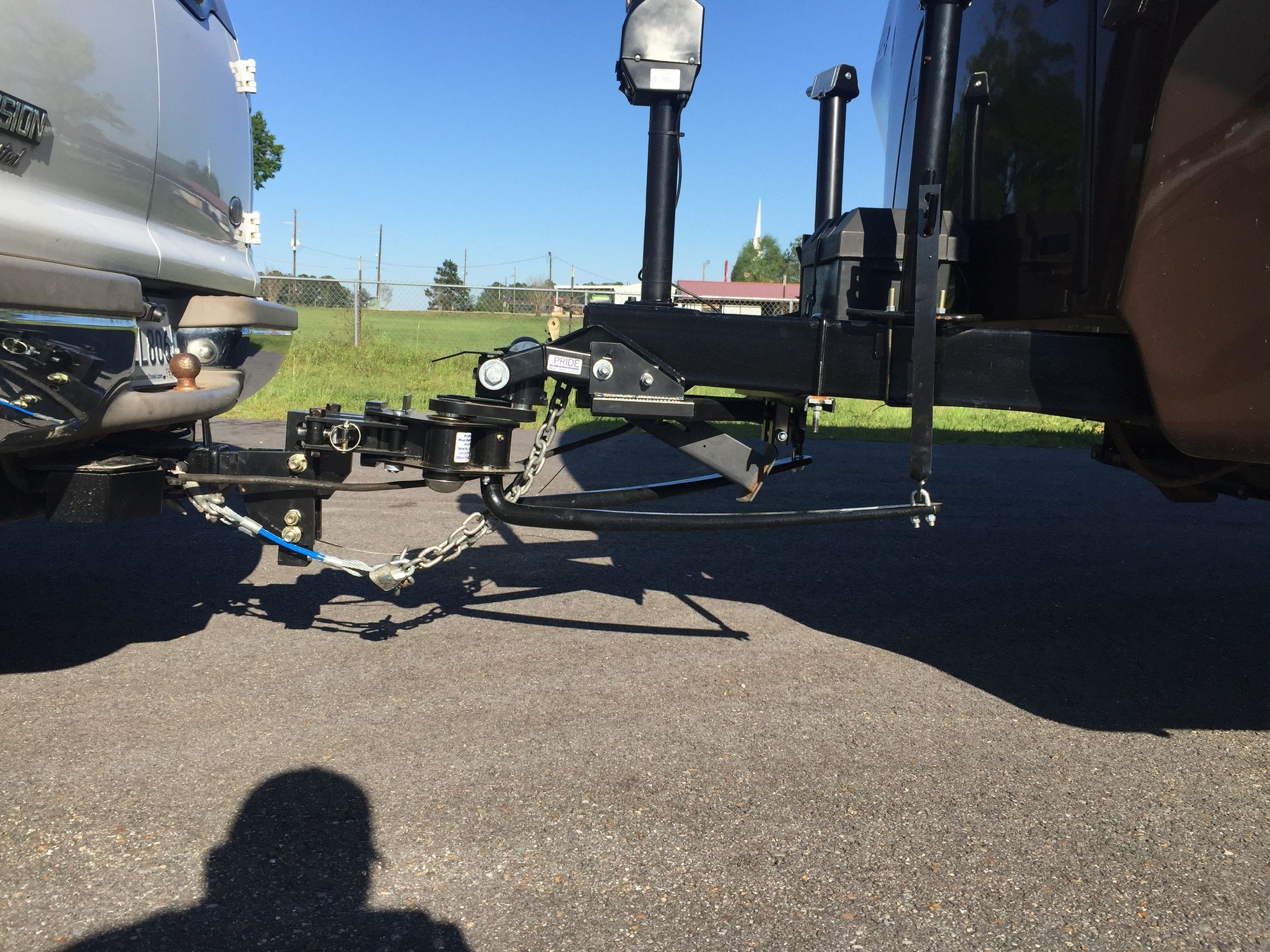

In at the cat scales in Fernwood Mississippi. The WD bars have straightend out the u shape hanger. What could have caused this? Is it safe to toe without the WD bars?

The hooks on the weight distribution adjuster bent? Sounds to me that the bar that connects the WD bars to the adjuster was not straight up and down. I have bent the connecting bar by lowering the WD too far but was able to straighten it.
I would not drive it without the WD hooked up, the Pro Pride uses the bars for turning and stabilizing the hitch head.
Do you have a standard hitch with you? You could take the PP off and tow the camper without it until you get with Sean at PP and get a replacement part.

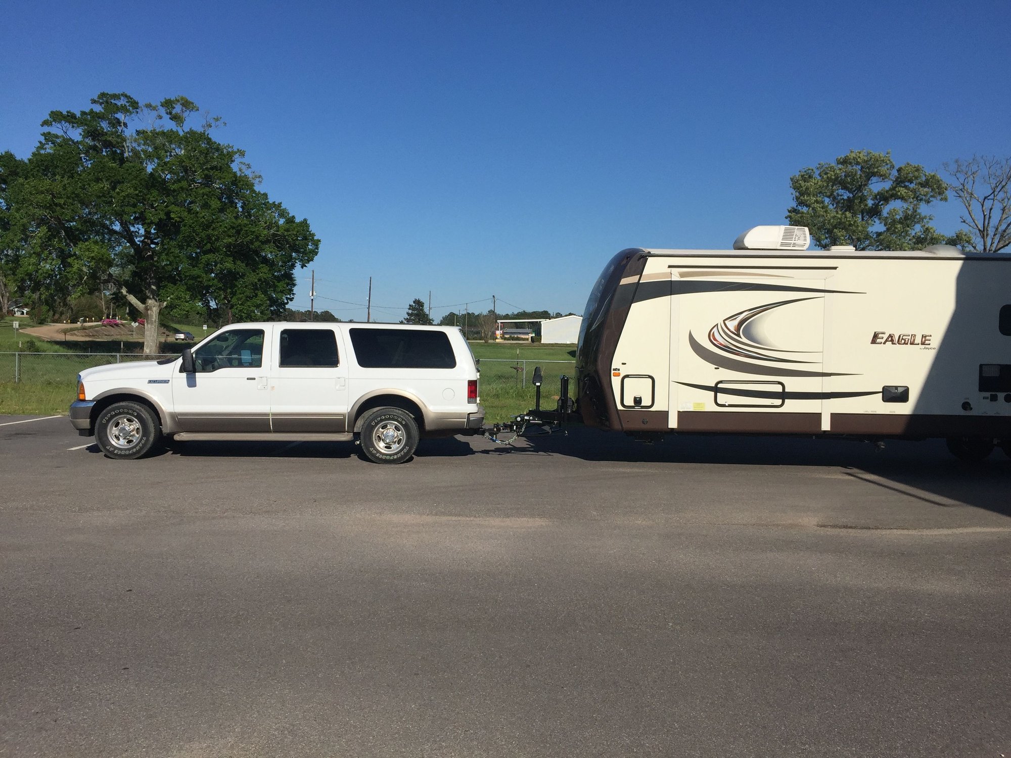

Here's a before and after. I installed everything as per the instructions a few months back haven't towed with it it just a few miles giving it a shake down. Today we trekked about 30 miles to the cat scales. At least I did get one pass over the scales.
3680 front axle
6380 rear axel
9100 TT axel
Heading home to get the old fast way hitch
Thanks for the reply

I know someone at Pro Pride. Here's what he told me:
The frame bracket holding the yoke tail is shifted which tells me the force that did that was prying on the Jack hook. Probably in a tight backing situation. Bend the hook back up and get a flexible pipe/gear clamp (hose clamp) around the jack to hold it from bending. Call me Monday for a new jack outer tube.
It didn't happen all in one incident. It was being pried more than one time. Then the spring bar link walked out to the end of the hook at it went the rest of the way.
Also, see your PM for more stuff I can't put in this post.

Oilfield, I would also turn your stinger so it is not so close to the ground, just turn it 180 degrees and readjust . Since the PP sits lower on the tongue at some campsites you may have ground clearance issues.

I'm following this too, but not being a PP user I have nothing to offer as to what happened. But I do agree on what Excurvelle said about flipping that drawbar over to get better ground clearance, especially with your RWD EX.
If that hitch was feeling unstable on the highway then it does sound like something may not have been adjusted properly during setup. Please keep us informed as you work with PP to get this all sorted out and good luck, once you get this thing dialed in you should be very happy with it.
I know that you are having a bad day and I don't mean to add to your stress level or nitpick but I have a few other observations that I'm going to mention. My only intent is to help you get to a better and safer towing combo with fewer problems on the road in the future.

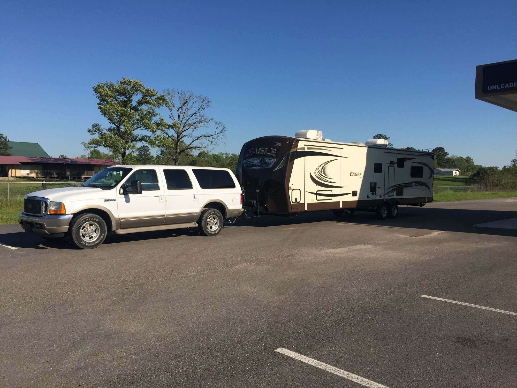

It's hard to tell for sure from the first picture but is the TT riding a little nose high? Level or slightly nose down will provide for better handling and braking performance.
Your 7 way cable looks a little tight in the pic, do you have any way of freeing up a few additional inches to give it some slack? If it's fairly tight-ish it could pull out on a tight turn causing a lose of lighting and brakes on the TT. I had to relocate my TT 7 way cable junction box to give me a little slack with our Hensley's extra length.
Looking at your safety chain/cable hooks, they should be hooked onto the receiver hitch the opposite way, from up and under through the hole vs down and through as they are. The gates on the hooks should also be latched closed once attached to the receiver hitch for added security of the safety chains.

The 7 way does look tight in that picture. I thought it had more slack than that when hooking up. The Hooks yep those are wrong also. My current hooks do not fit on the Curt and latch I was going to swing by camping world after weighing to pick up new hooks but they didn't carry them

Harley, with 6380lbs on the rear axle I don't think he is suffering from too little weight there. It is sometimes difficult to really tell if a trailer is riding level from a picture between the 60' bumper to bumper length, shadows and uneven ground that angle can look off a bit. Below is a picture of my EX pulling the EXACT SAME TT as Oilfield's (and yes, like Pirate said they are a lot of mass with a very BIG surface area to control!) from a very similar angle, mine looks a tad bit nose high but I know for a fact that is actually just a whisker nose down from level.
