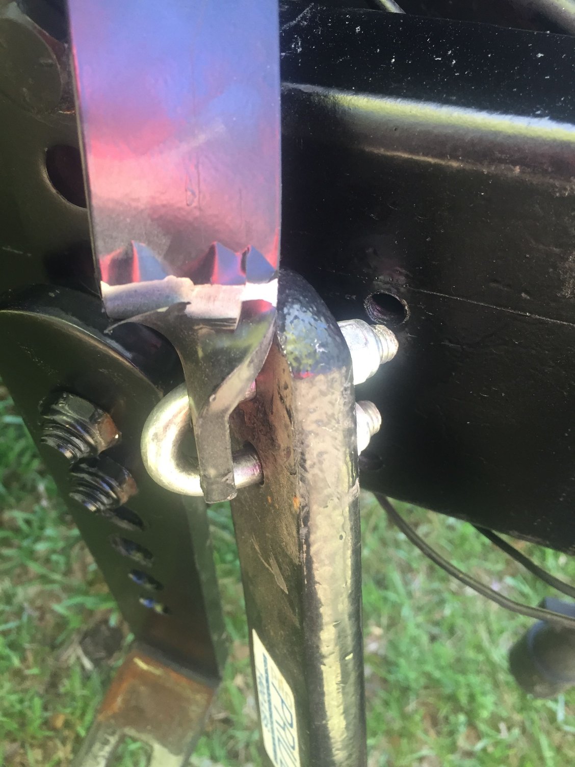

It looks like to me the load bars may have hit the trailer tongue jack/support on a hard turn, that would cause the jack U support to bend.
The draw bar (stinger) has a lot of ways to adjust, it took me a while to get it right. Oh, with a new camper on the way I get to do the setup all over again!

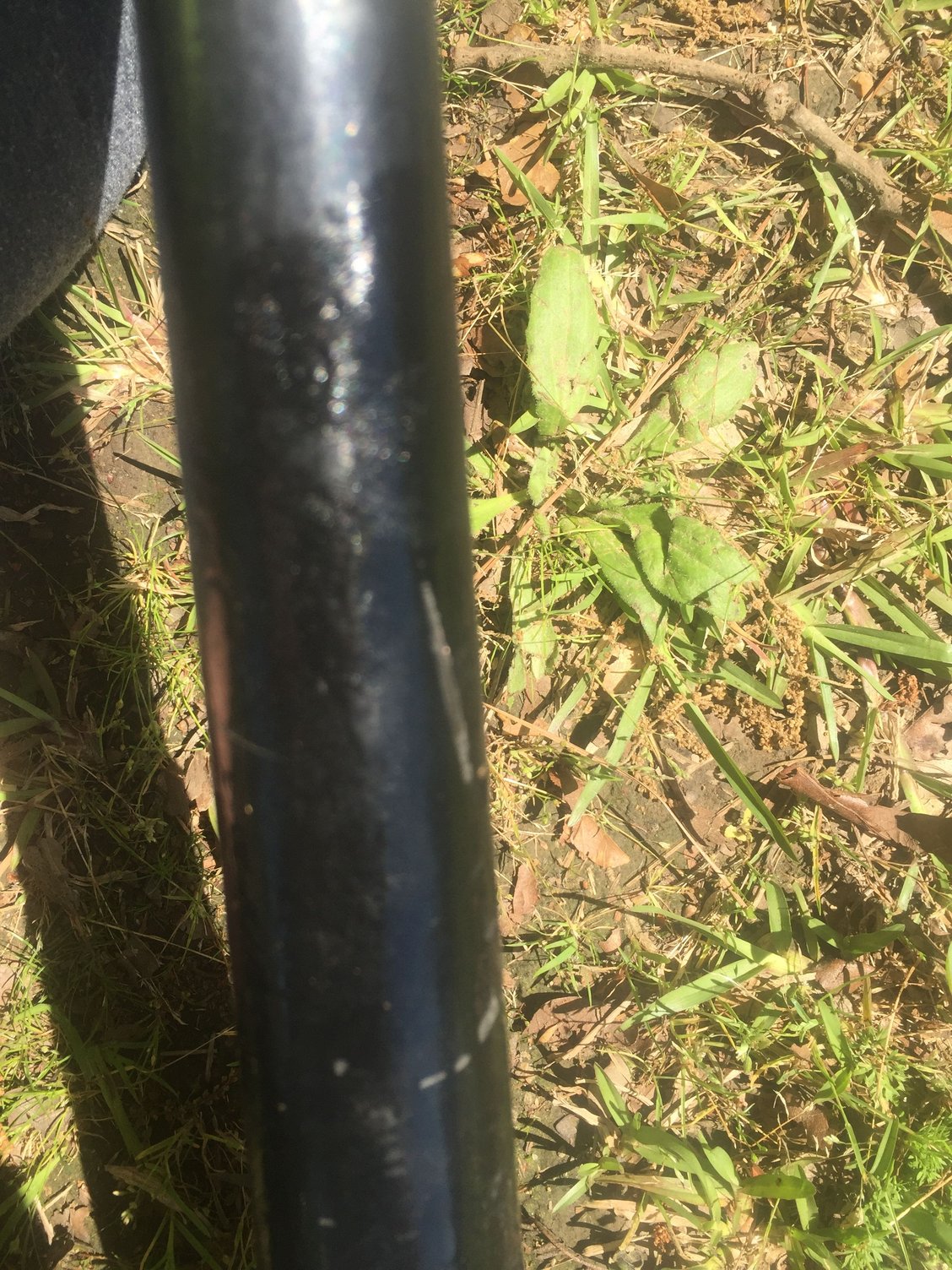

Ok just got off the phone with PP. he is going to send me new jacks for the hitch. It appears that there is something hanging on the WD bars but we are not sure what. I should have the new jacks before this weekend.there is a lot of good information flying around here and I appreciate all the help. Without me going back over the scales empty I'll never be able to answer most of the questions. I did go back over the scales BUT without my wife and 3 kids in the truck. So those numbers are pretty useless but here they are anyway.

Old Apr 4, 2016 | 12:03 PM
  #28
Oilfield Trash's Avatar
Oilfield Trash
Joined: Jul 2015
Posts: 165
Excurvelle
Right after you posted that I was reading it to my wife and Shawn text me back and suggested he same thing. So we went and looked on the draw bars. And guess what. Y'all both are right. The foot has to go.
So for now the mystery of how and why it happened is solved now once I get the jacks in we can all get together and solve the problem of me not transferring enough weight

Another pic of the evidence.

Great! Glad you figured it out.
Once you get the system running again drive the truck, take a hard right turn, stop, get out and look at how far the mechanism twists and how close the camper is to the back of your Ex. You will definitely see why the wiring and chains need slack.
