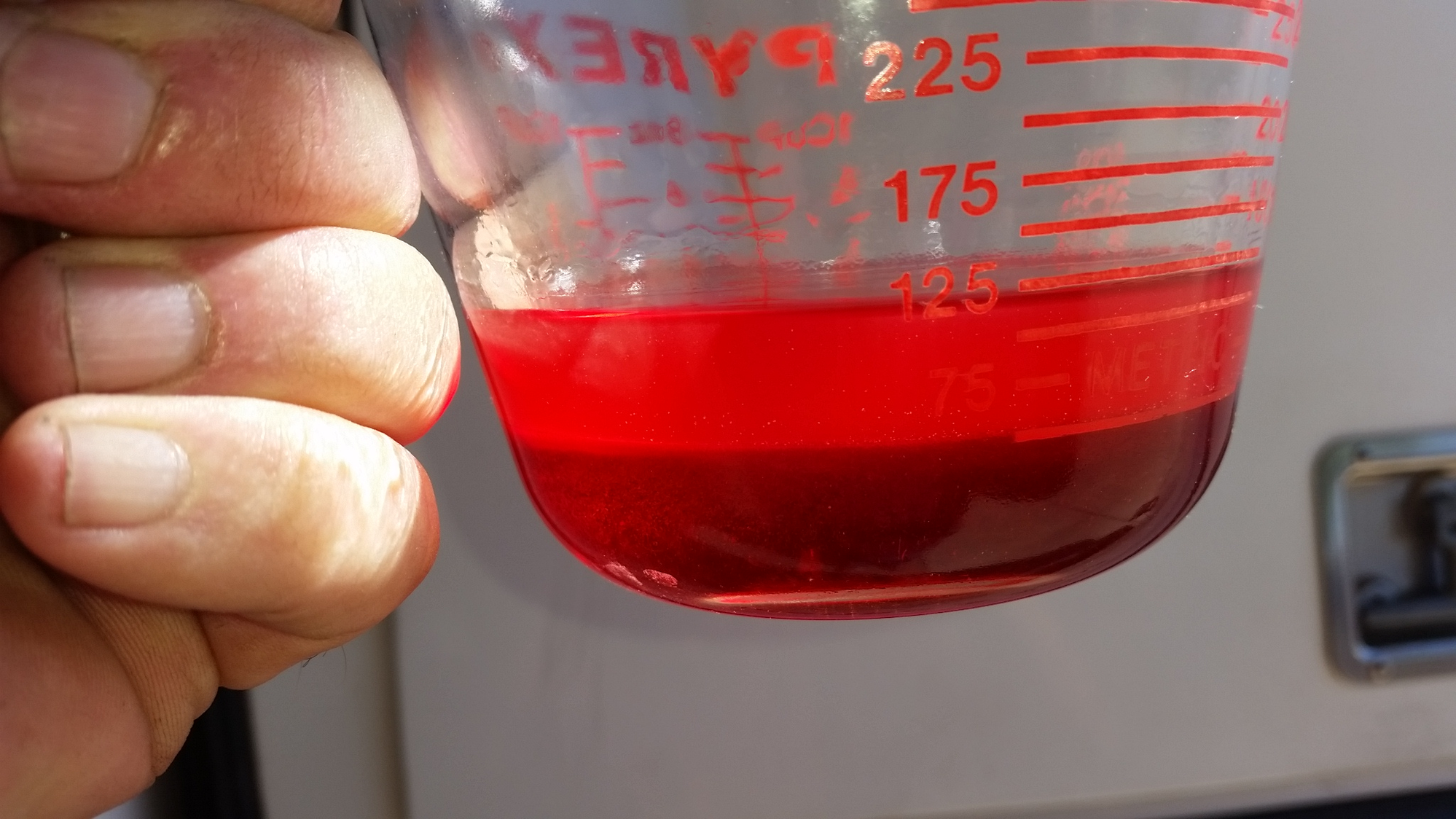

Sean, you are right on with the ATF & Acetone, I have used it myself and it works great. FYI to everyone, the mixture does not mix well together so be aware you must keep shaking the mixture to keep it from separating.

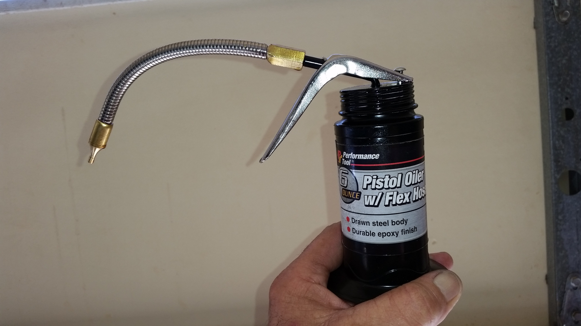

Sean, sorry I have been out working on my 7.3 today. I use an O'reily Oil can with a flex spout.
As for the ATF & Acetone mixing, as seen here I mixed 2ozs Actone & ATF and stirred very well, after on minute I took this pic.
I am working on a better delivery system that will not let the Acetone evaporate, one of those I will get to it soon projects.
I hope this helps everyone.
