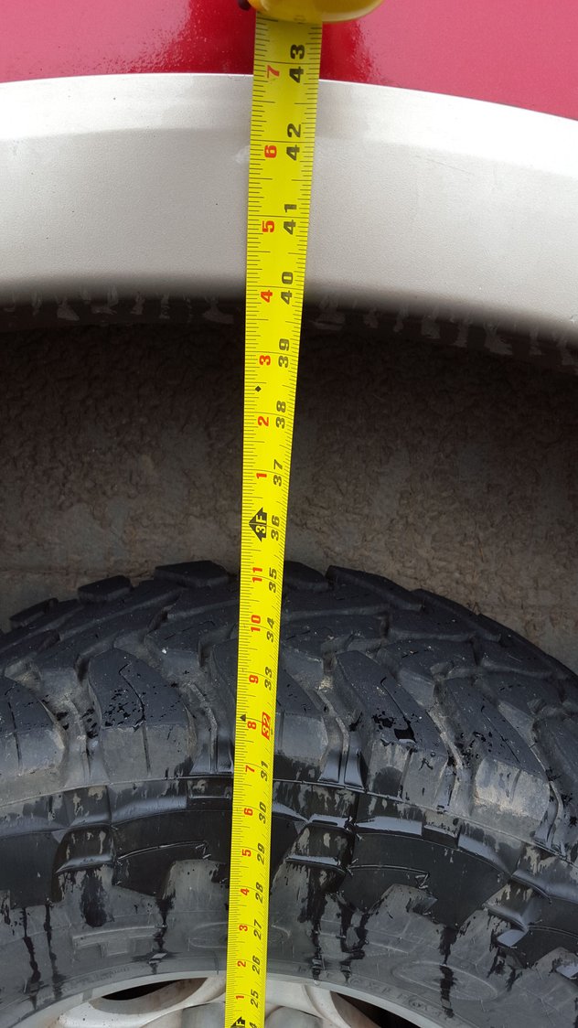

Not sure what I currently have for springs... I do not have the door stickers anymore as they have been worn off?? I do have RMX monotubes that were already on the Ex. Haven't measured how high I am sitting yet, wondering if that would clue me in on the springs? I think have good bump stop clearance, definately more than an inch on all sides. Need to get the Helwig for the rear too. I have Toyo MT Open Counrty tires but I cannot remember the size at the moment....

To see exactly where your EX is riding as far suspension goes take your measurements and add your data to this thread where you can compare your numbers to what others have.

That looks like the stock suspension to me. It's fine for towing something that small but if you decide to upgrade to a bigger RV, you're going to want something a lot stiffer under there. The bilsteins and a Hellwig sway bar are great additions. My Ex (same color as yours) tows my 9000# RV fine.

Tires are 285/75 r16. Measurements are 38 and 40 inches from ground.

As outlined in the above linked to thread you will want to take the measurement from the hub centers to the bottom of the wheel well arch. That method will remove any tire size variations due to different manufactures or wear, it will be a much more accurate assessment of your spring situation.
