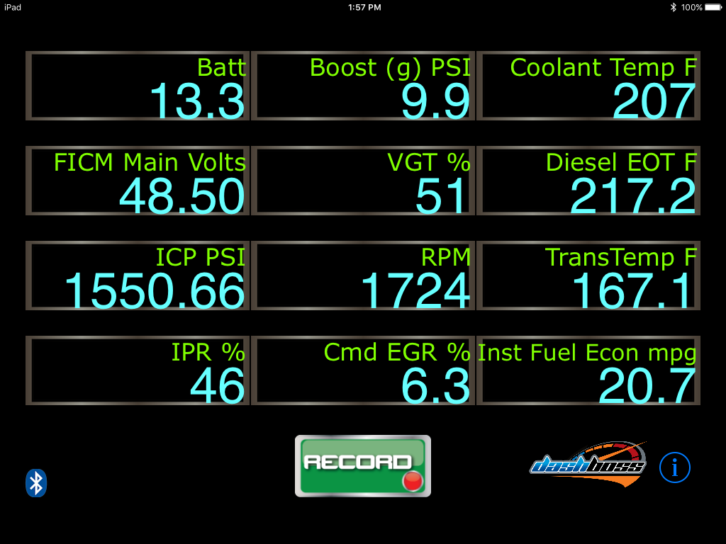

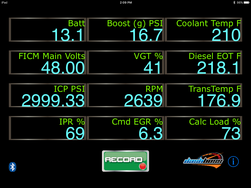

r2millers's Avatar
r2millers
Joined: Sep 2010
Posts: 3,472
From: Southern Cal
Originally Posted by navistarnut
If your EOT is running that cool then what are you seeing for ECT's?
6.0 is happier and more efficient at 190 ECT or above. If your ECT's are as low as your EOT's then you need to address that.
Here's my data after the unison ring replacement.
About 57 mph in 5th on flat ground.
At 60 mph in 4th on flat ground.
