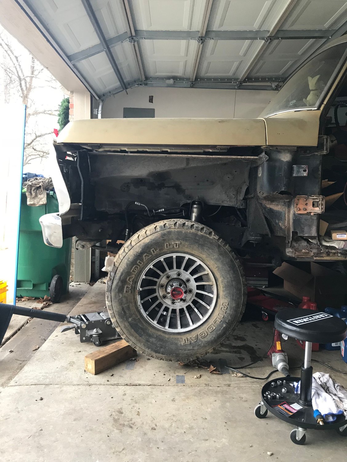

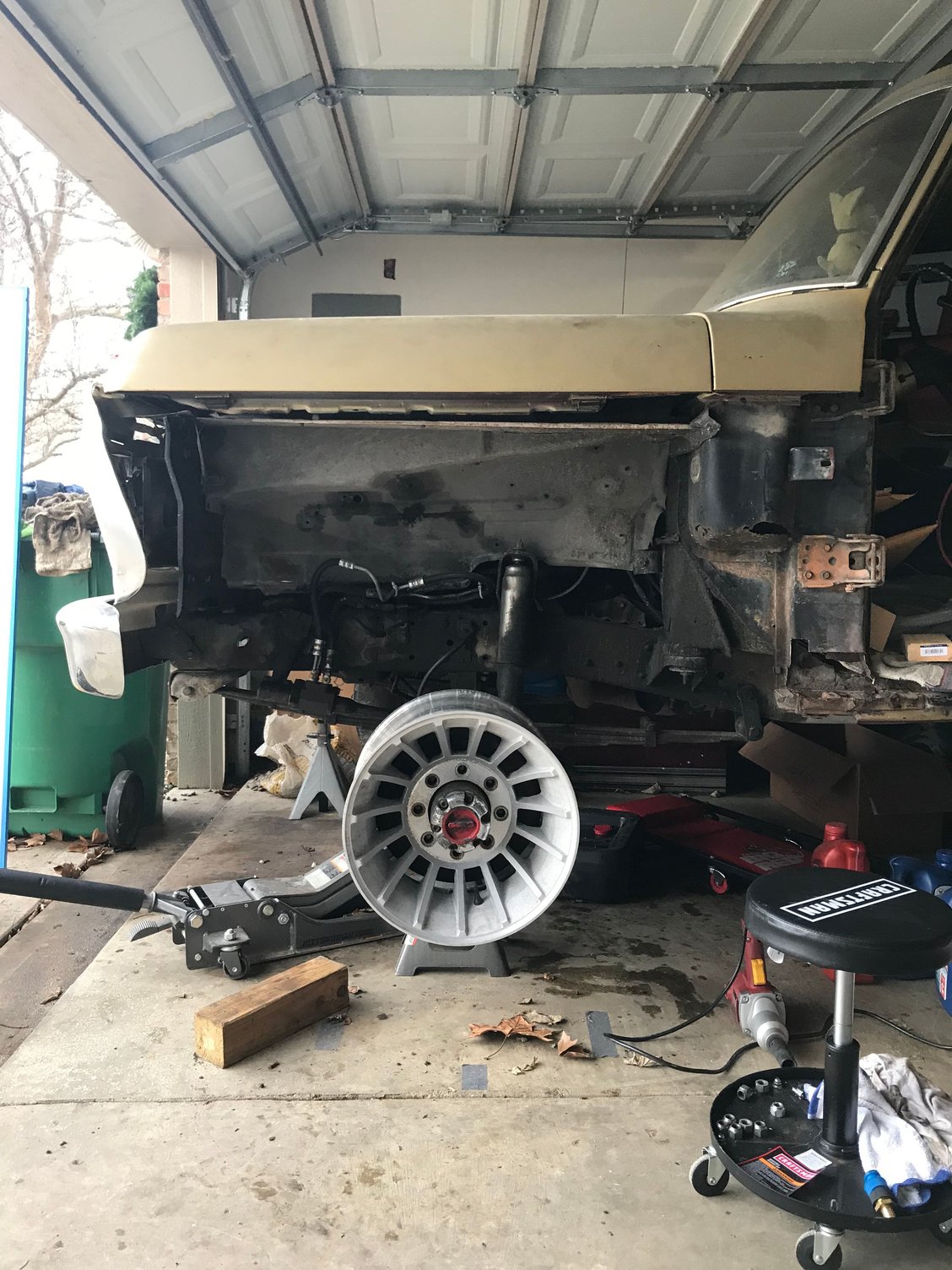

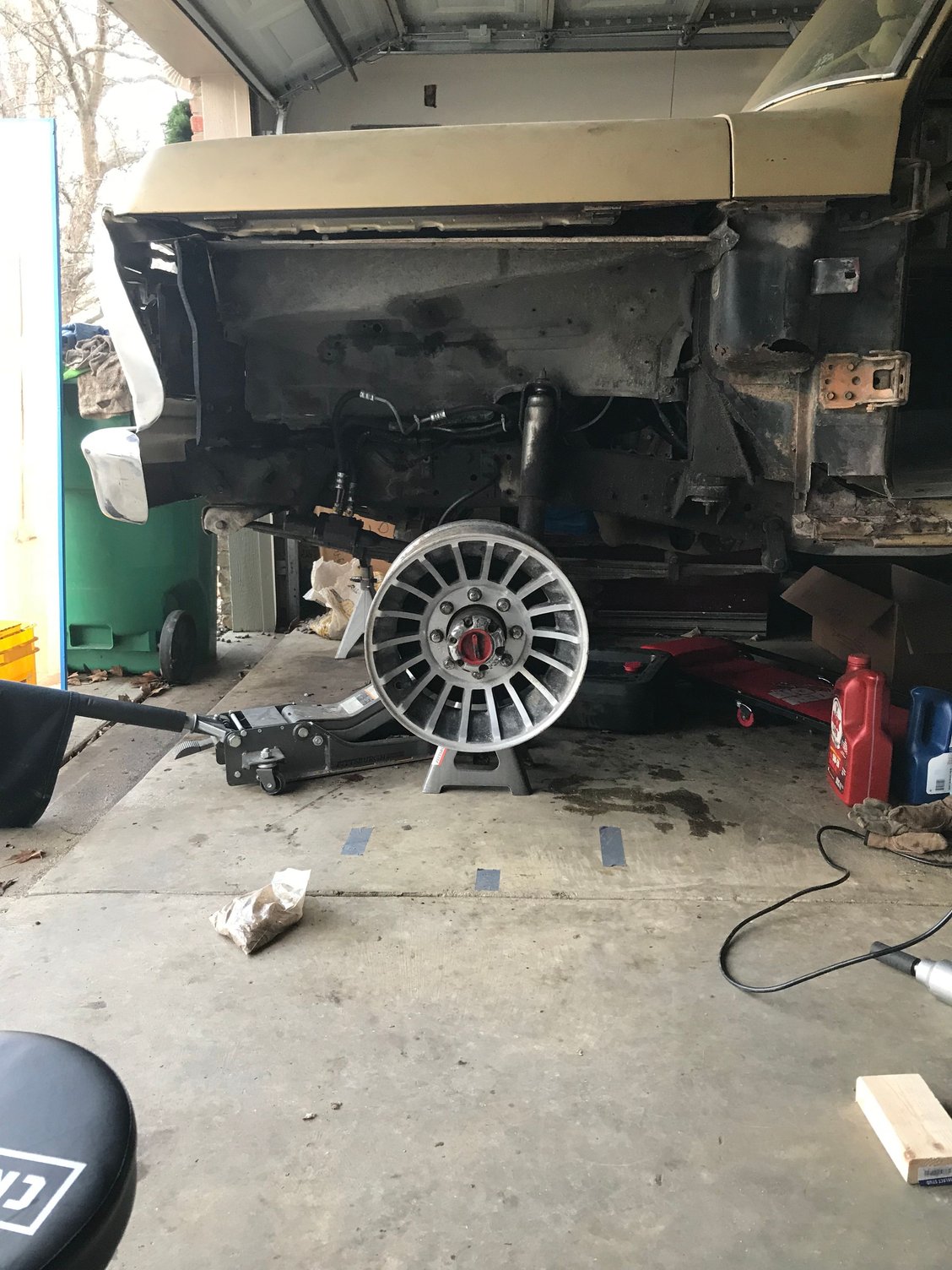

As promised pics of it on the truck... also two of the rims came with tires. beads are popped so they are flat and dry rotted but it at least gives me an idea of what it is going to look like. Also tossed the 16 spokes on for a picture too (Tell me the 18 spokes look better cz thats what I have to go with lol) I think I like them better too. Plan is to buy 37s once its running and driving or if I can find a good set of anything 16.5 on craigslist for under $200 I'll put those on for now.
First pic is the rims that don't fit. 2nd pic is the new set (and yes they are that dirty it looks like in between the fins was painted black lol) Also sorry I dont have the front fender on right now either. Has a small rust spot and came off when I tore down the interior/took the door off. It still gives an idea on the truck tho

Looking good, good luck finding some 16.5's that are that cheap and have any tread on them or are not 100 years old and weather checked.
Unless you get military take offs that are bias ply 36's or the 2 optional 37's.
Hard to locate NOS 33x12.50x16.5 around $700 at a semi local tire shop.

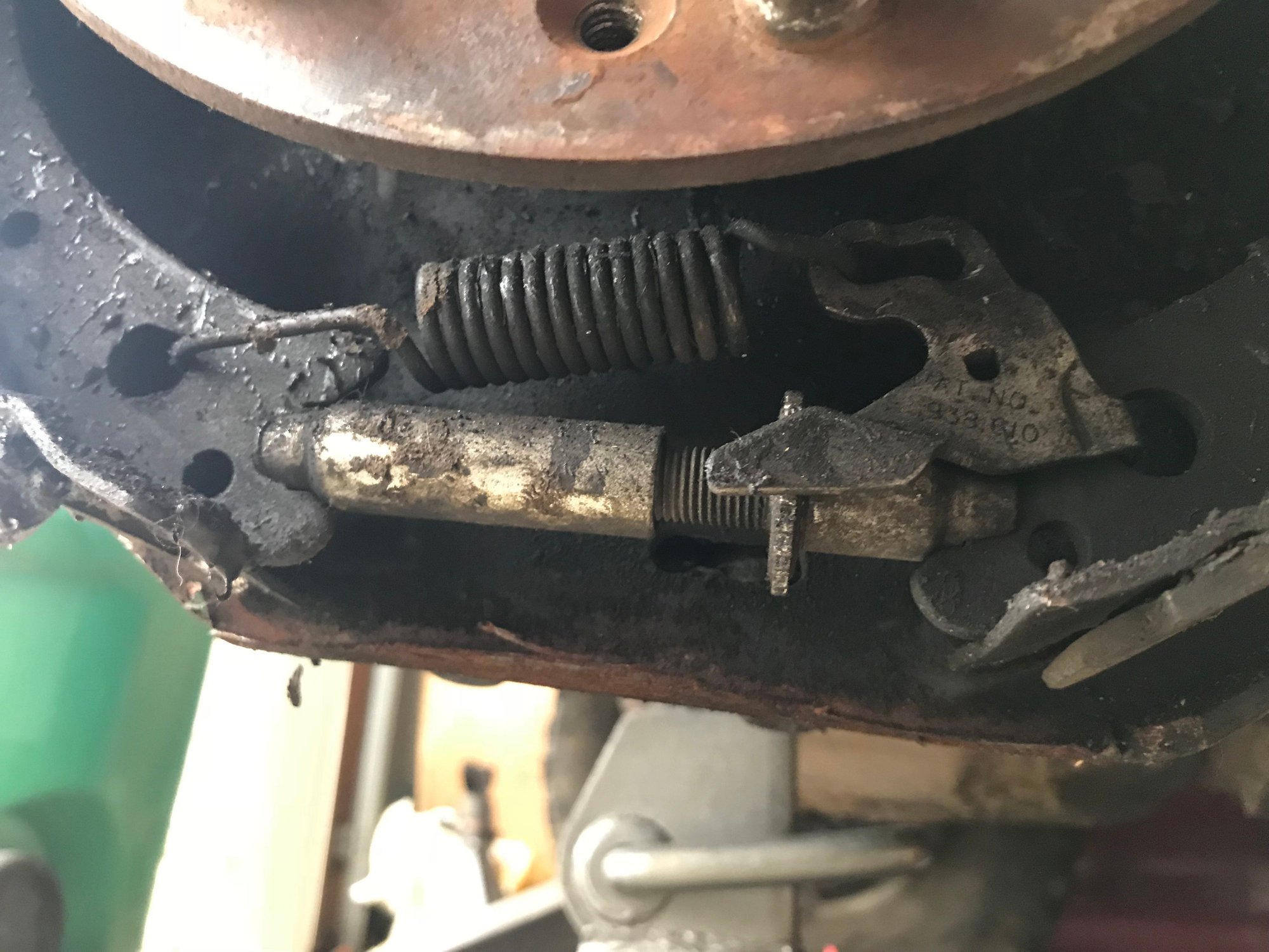

Anybody know where to get a drum backing plate? I switched gears while I wait on the dry ice blaster to call me back to clean up the timing cover. Figured now was a good time to do my brake overhaul. Well was buying parts and then noticed there were different brake shoe widths so went out and started tearing down driver front side. Found out my brake shoes are 2" wide. Also found out the shop I had it towed to on my way home, didn't bother telling me or fixing the backing plate, they just cut off the damaged part. So now I am needing a new backing plate. Let me know if y'all know where I can buy one from online or leads to one. Here's a pic I took of the spring hardware to reference but you can see the cut at the bottom.

Has this truck has the rear wheel fall off at some point? That does not look "cut off", that looks ground off, like from going down the road.
I know to pull a rear drum you have to pull an axle ect...but it looks ground off to me.
