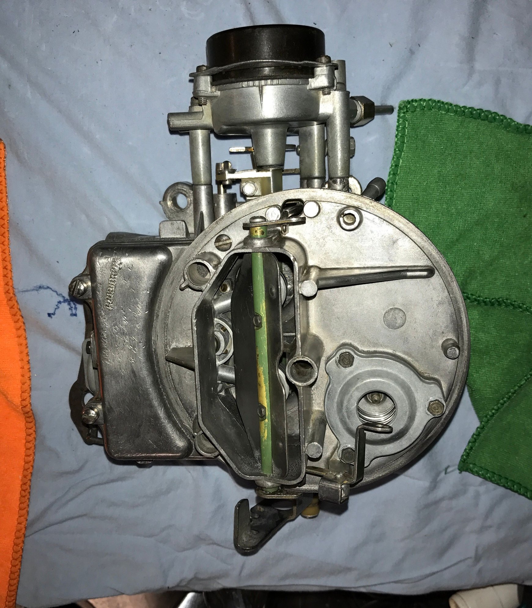

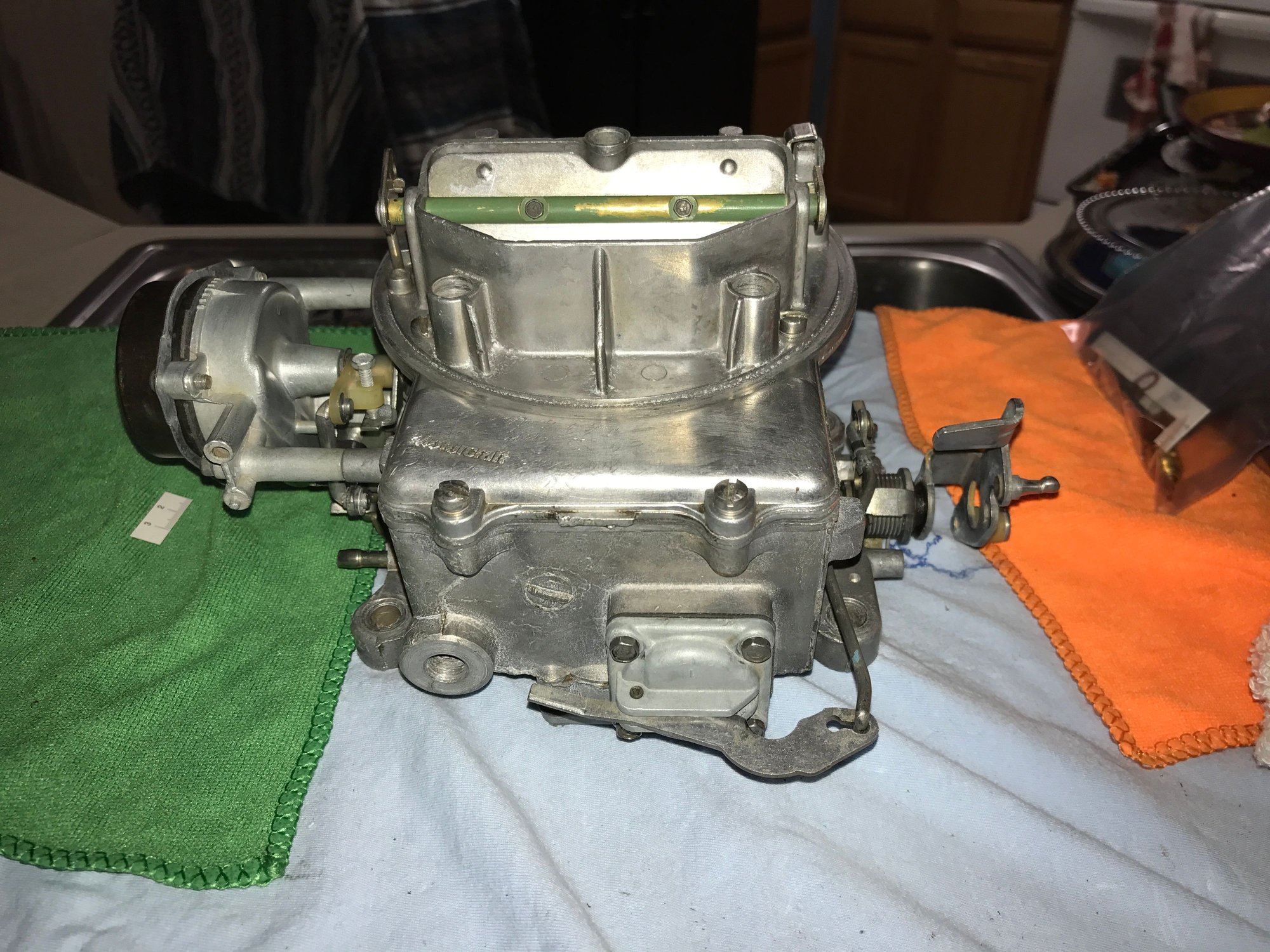

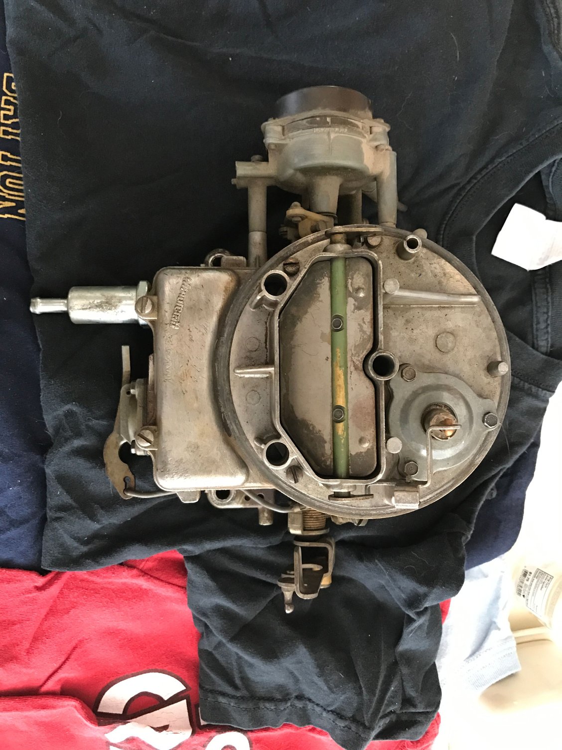

Alright so when I last left off I was a happy camper! I had my revived core support painted, reassembled and looking good! I then put the carb and air cleaner back on
I put the radiator hoses back on, filled er up and she started! Thats the last time I remember enjoyment in this truck for the last 4 months . Bought a timing gun, got the engine timed just right, fired her up and she ran decent for having been torn apart for so long... then I noticed a small gas leak from the carb, so decided what the heck, time to teach myself how to rebuild a carb. After some youtube videos and chats with friends, I ran down to the local autozone and they actually had a rebuild kit in stock... doesn't look like they sell them too often the manager told me he hadnt sold one of those in 5 years! You can see the dust on it lol
I also am a huge advocate of pinesol to clean carbs. Here are my before and after pics. All I did was soak in pinesol then lightly scrubbed with a toothbrush dont have any pics of the varnish on the inside but it disintegrated that stuff! plus my garage smelled good afterwards and the wife liked it better than the used gear oil smell.
So feeling good about all I had accomplished, I put everything back together and went to fire her up again. Had the wife come out with a fire extinguisher (just in case) and she laughed like am I really doing anything? Well fired her up and success!... until she yelled to shut it down as there was gas spewing everywhere well now she at least knows why I had her out there lol.
So ruined my intake manifold paint job (actually forgot about that until just now and it still stings a bit) the blue is ruined but luckily the primer is still in perfect shape. Got to investigating what could be leaking and as I went back thru the pics of the carb I took I noticed something....something I should have caught but chalk it up to being new I didn't pay attention. Anybody notice whats wrong?
Yep thats a problem! Right where the fuel filter screws in, theres a nice little crack... that isn't so small once I put the fuel filter back on. So I believe grinnergetter helped me once again and sent me a carb, used some pinesol... and little more elbow grease and bam back in business. I still need to tune the carb a bit, but she runs and idles pretty good. Heres a video, my exhaust is cut under the cab (I may or may not have explained that earlier but i cut off the crappy exhaust and haven't fixed it, and probably wont until other things are fixed.) Also in later pics you'll see it cut by the TC

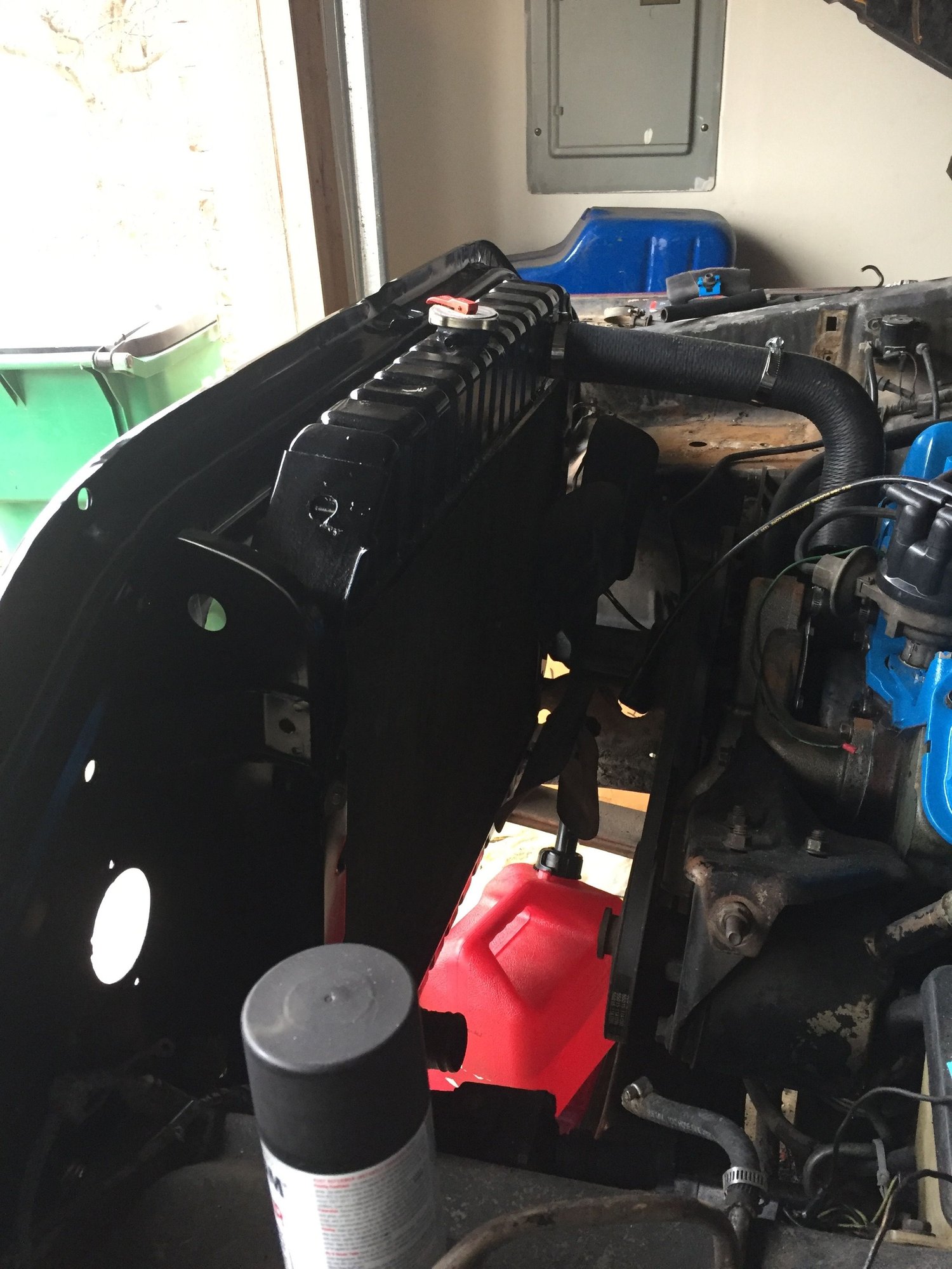

So once again feeling accomplished I moved onto the next project... putting the front end back together, after all I can't drive her looking like this!
Well I didn't get too far into this one when yet again more problems! (see why I haven't had fun lately lol) Somethings not aligning right causing my hood latch to be too far forward
After a few phone calls and measurements from grinnergetter, I still couldnt figure out why things werent lining up, and I did not want to reshim every panel on the front of the truck.. at least not yet anyway. So I took the nice new core support back out and compared to my old one. Sure enough you can tell the drivers side lower portion is bent, and I'm still not sure why the entire support leaned further out than the old one but since part of it is bent I just assumed there are other "straightness" issues with the one I cleaned up. (also at some point I hung up my Trucks flag in the garage)
So frustration at an all time high, and night setting in, heres how she sat for a few more weeks. looks like I made no progress at all!
Decided the best thing to do was put the old one back in to see if that solved my issues. (this would let me know if I moved something to knock everything out of whack) but maaaannnn doesn't the painted one just look so good in there?!
So im sure you guessed it; the old one fit perfectly, no issues.
Took it back out, sprayed rustoleum rust converter on it and put it back in for now... ill look for another one later... someday
A few days later I found some more motivation and put the front clip back together and she now looks whole again (minus front bumper)

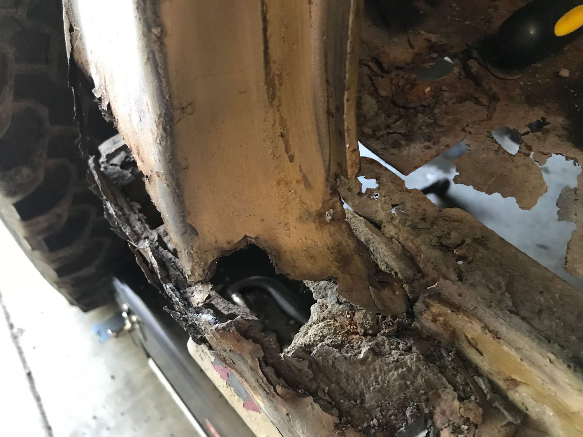

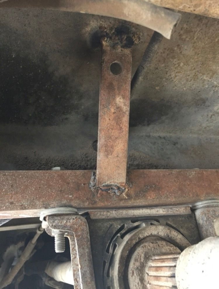

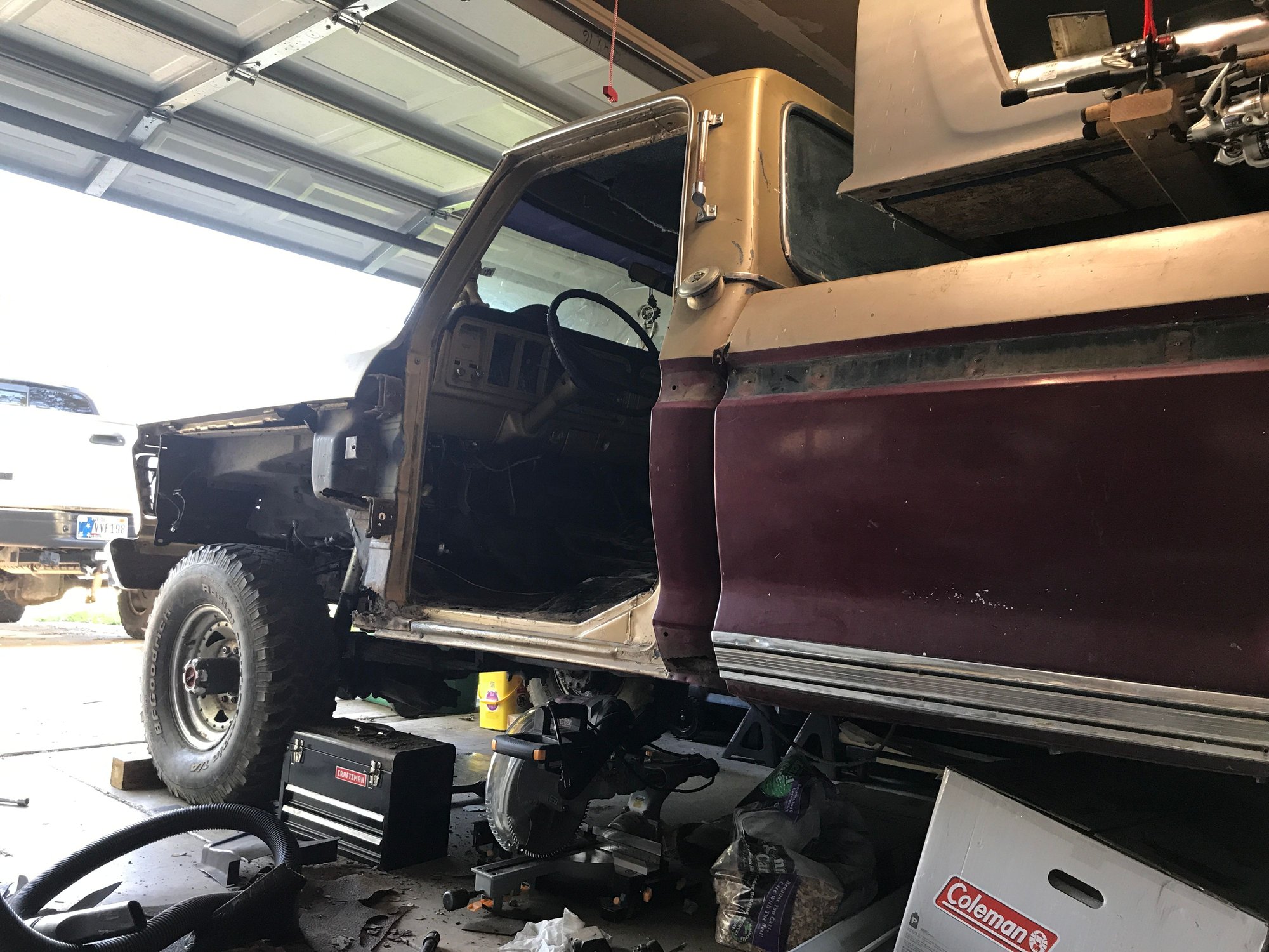

Well that brings us up to the beginning of this week. Decided since it hasn't moved in months, and wasn't going to until this rust got taken care of, I bit the bulltet and ordered some Tabco replacement panels. Floor board, inner rocker, and inner lower rear corner. Ill need a rocker and some passenger parts eventually but this will get me going. Also figured it was a good time to tackle the NP205 installation. I believe I have some pictures back in here that show the shotty job the PO did by welding in a bar and dropping the TC and just shoving a 2wd shaft in there. Edit* found the pics, here they are

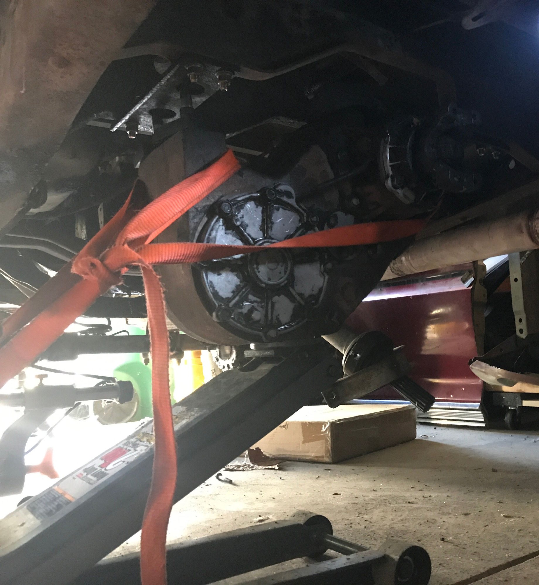

So took out the driveshaft, used an anglegrinder to cut off the welded plates and a flap disc to smooth the frame rails back down. Cleaned off the TC (was going to overhaul it but it works so thats another project for another day) bought some grade 8 hardware and went to install it. Didn't have a transmission jack so I used some good ole fashioned redneck engineering and used my floor jack and a ratchet strap.... hey its not a dumb idea if it works right?
I know i know, pics or it didnt happen; well heres proof the TC is up on its own with no assistance (and no cracked concrete floor either)
Then today I went to install the driveshafts I picked up about a year ago from a guy on CL who promised me they were out of his old 74 f250... well you guessed it; THEY DONT FIT. So im currently looking for all 3 driveshafts.
Moved onto finding what is leaking from my truck. I believe its my dipstick, currently researching on the proper way to fix/seal it. I've got a thread open feel free to drop some knowledge in there for me.
So other than waiting on the tabco patch panels to come in, thats pretty much it.
She runs, doesn't leak fuel, has the front reassembled minus the bumper, has the driver side front fender and door taken off, rust cut out of the driver side, interior torn apart, and in search of driveshafts. She may not be perfect, but she is still my dream truck.

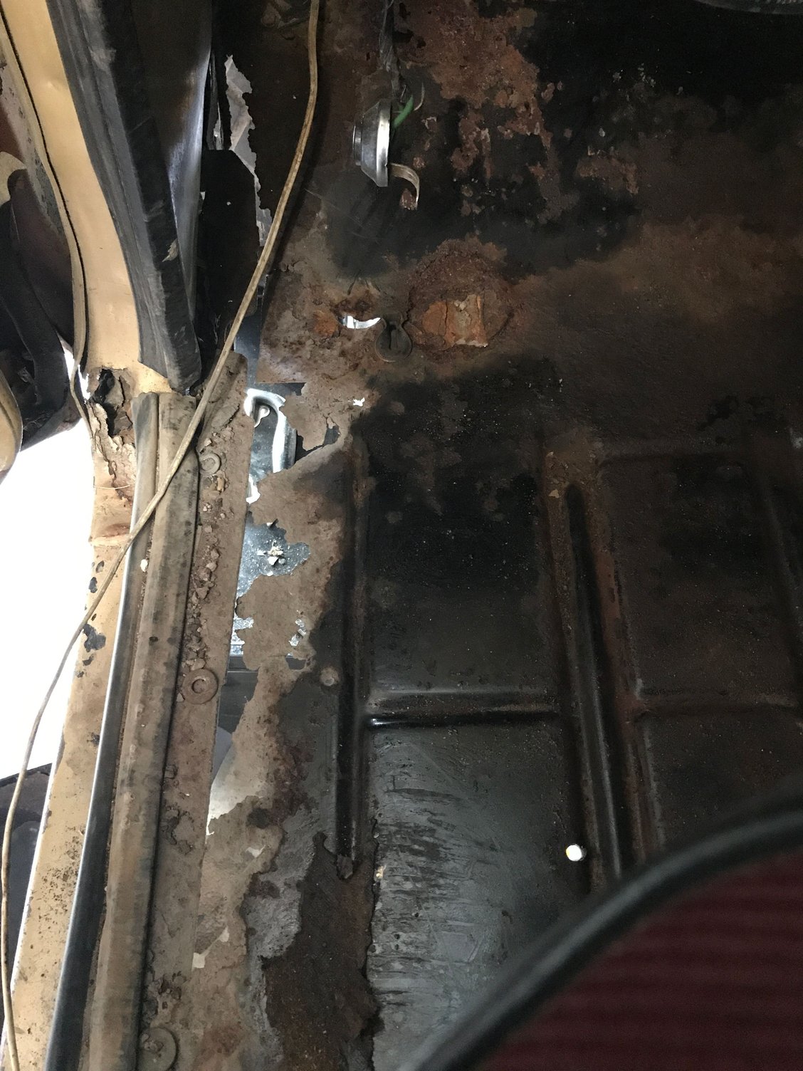

Removed the oil pan after soaking the dipstick tube bolt in pb blaster... and learning you can't just drop the pan lol. Removed the exhaust instead of raising the engine because 1 I don't have an engine hoist and 2 my exhaust barely goes past the cab anyway. That gave me enough room to remove the pan. It looks like the oil pump isn't properly bolted so I'll fix that too. Currently waiting on the 1194 sealant to come in, oil pan gasket just arrived today and bought a rivet gun the other day. Still searching for driveshafts and tc linkage. Hoping to drive to a good junkyard next week in search of some driveshafts.
2/3 patch panels arrived the other day. Not sure how I feel about the floor pan but I'll see what I can do with it. The lower rear inner cab corner came with it. Still waiting on the inner rocker to come in.
