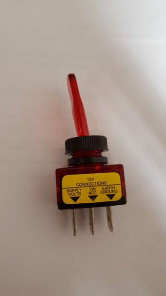

I have read several conflicting accounts of how to control the torque convertor lockup. one place said to send 12v to it to command lockup and another place said to ground the wire in the bundle, i think purple with white stripe, to command lockup as used with the engaging the exhaust back pressure valve for descending hills with a load.
so i have this switch which is lighted when on and trying to figure how to do the TC part.
how do you wire this thing to work properly.. ??

so i am guessing with no response this type switch is not able to be used or the application. In reading around i seem I need to ground the purple/yellow wire in pin #6 going to trans to lock TC on command.
So was reading about installing diode as well to prevent the flashing OD light. Any thought on that and which way to install diode.

The main problem with simply wiring in a switch to close the back pressure valve and apply the torque converter clutch is that the transmission pressure absolutely needs to be increased to prevent damage. Stock or aftermarket programming commands only 60 psi during deceleration and it's not enough to reliably apply enough pressure to the friction material to prevent slipping.

yes that is true.. I have read from mark to not lock up TC with RPM below 1400 to have line pressure needed.
All i am trying to do with switch is have manual command of TC,, not TC and EBPV.. that will happen with Jodys DP decel tune on my 6 position chip in the future.
guess I will just use a dpdt switch and wire it that way with a couple of leds
QUOTE=cleatus12r;16086465]The main problem with simply wiring in a switch to close the back pressure valve and apply the torque converter clutch is that the transmission pressure absolutely needs to be increased to prevent damage. Stock or aftermarket programming commands only 60 psi during deceleration and it's not enough to reliably apply enough pressure to the friction material to prevent slipping.[/QUOTE]
