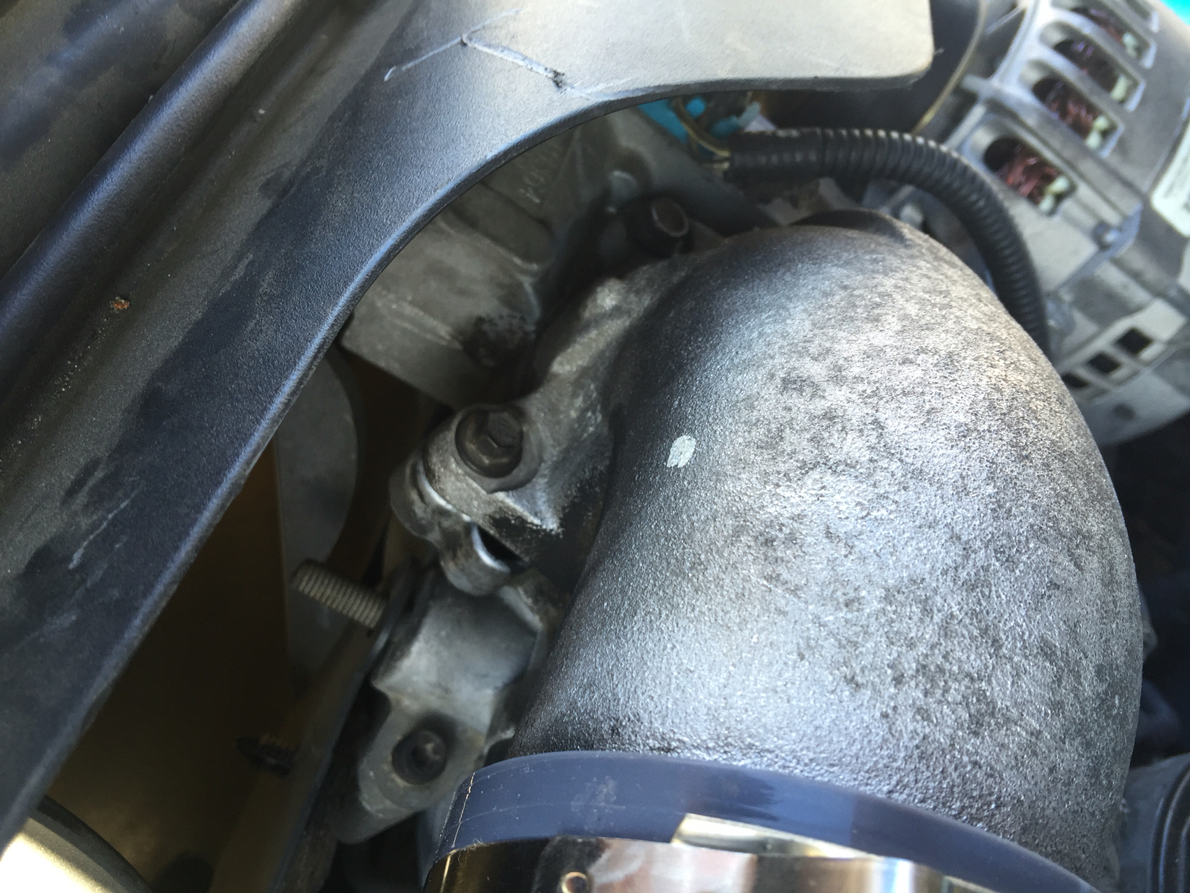

So bought the sinister charge pipes because they were on sale and my boots were going out(kept blowing off). I got them all in except the elbow. It has the bolt pattern of this 2 inch part under the original elbow. So I'm assuming I take that out as well but it has 2 sensors running into it. What are they? Can I take them out?
I have a 2003 early build 130k pretty much stock besides exhaust. Name:  photo809.jpg

Yes take it out. I only remember 1 wiring connection on mine also an 03, it was for the intake throttle plate that some had and some didn't, either way just unplug and remove it.

Ok it won't throw a code or anything? I didn't see a throttle plate when I took the elbow off

No codes if you look in the connector on the engine side you will find there are no connector pins.
