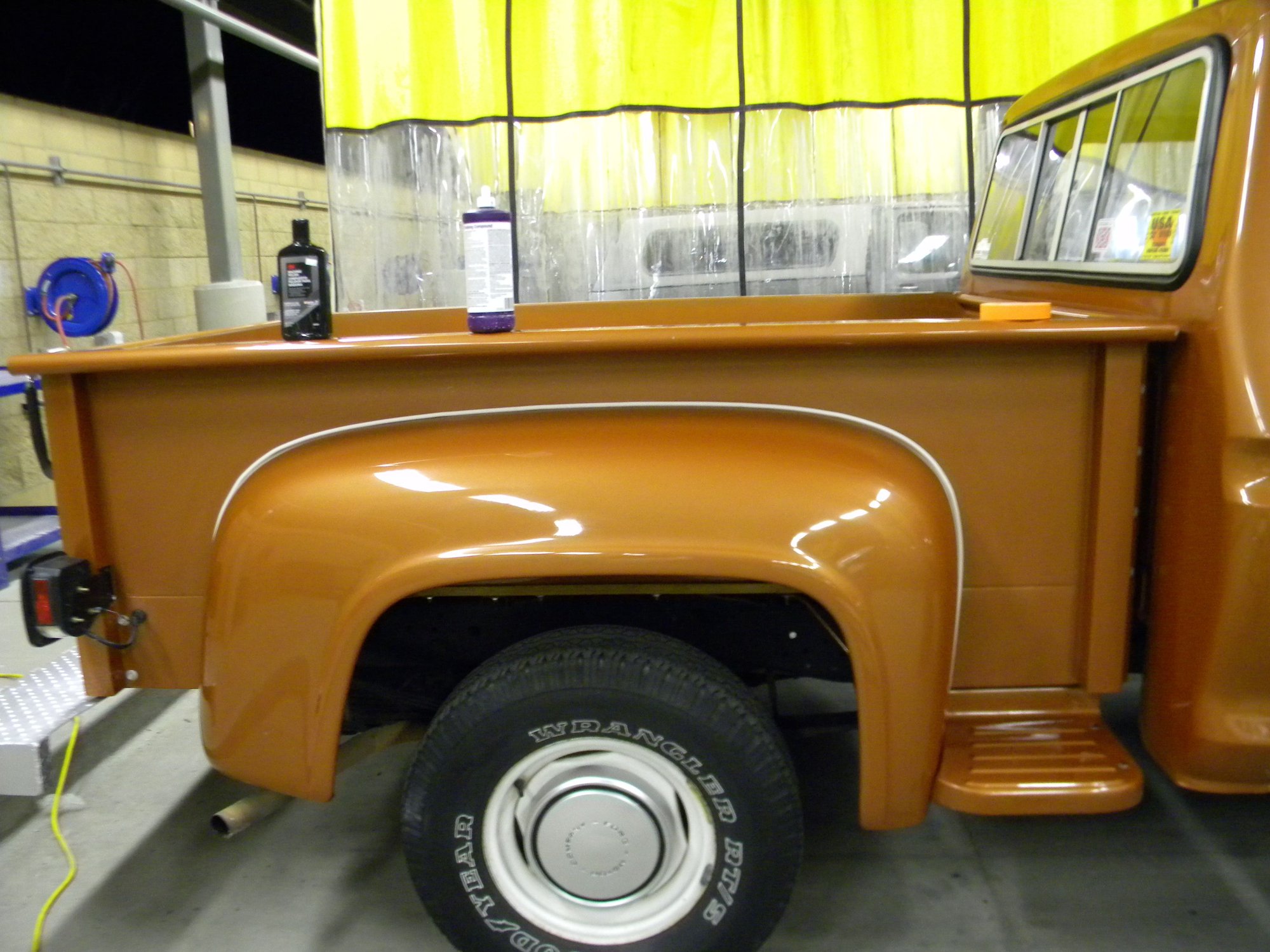

Quick update..
I have been doing the color sanding on my truck.
first I wet sanded with 1000,1500,2000,
then last week I used a DA with 3000 followed with 5000,
Today I started with a buffer and rubbing compound. Then switched to a foam pad and used a polishing compound.
Here she is at 5000 kinda dull...
Now where I stopped for the night.....
Still need to do the bed sides.

What products are you using on the buffing job
Old May 27, 2017 | 06:57 PM
  #99
dads1977's Avatar
dads1977
Joined: Sep 2015
Posts: 794
Likes: 19
From: between lost and found
Oz Econoline.
I used the 3M Perfect-it-EX for the rubbing compound with a wool wheel and
the 3m machine polish with the black foam pad.
