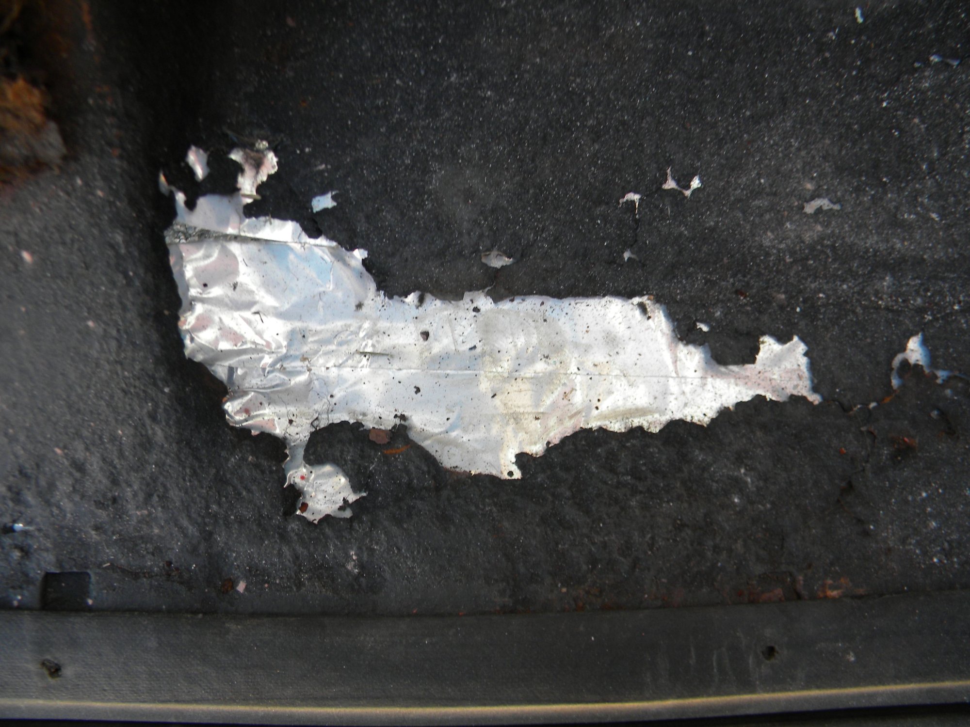

this past week while just poking and prodding... guess what I discovered....give up....
see PAREDNECK....we do get rust out here
yup... floor pan is toast ...but don't worry a quick call to NPD to order a replacement (which is going to make the long distance cross country trip to save the day, will be here next week)

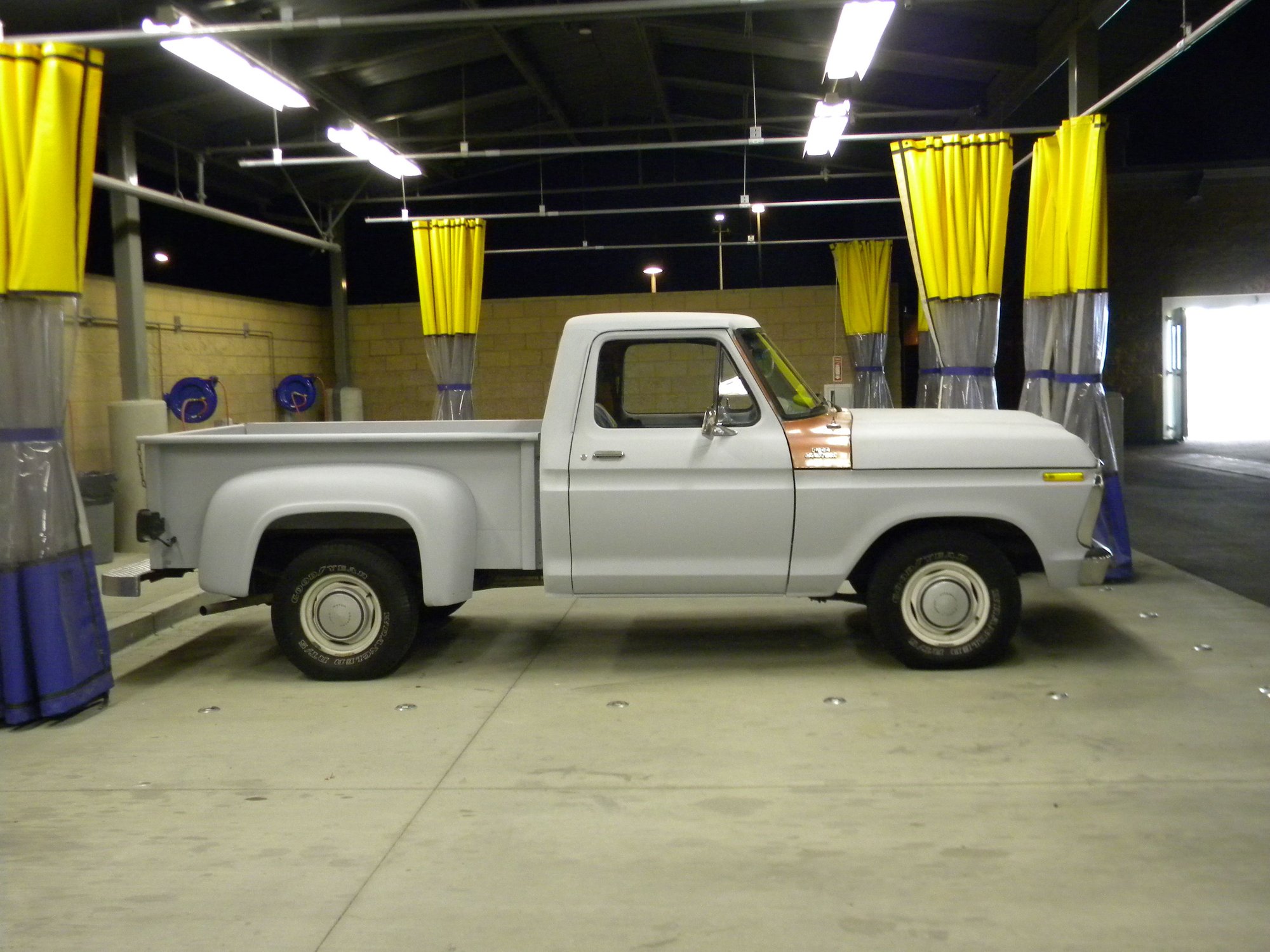

then to class.. once again to break the bed down..then into the booth
gotta love a clean, temperature controlled environment....
here she is back together
not bad for just a little over 2 hours of "fun" don't you agree?

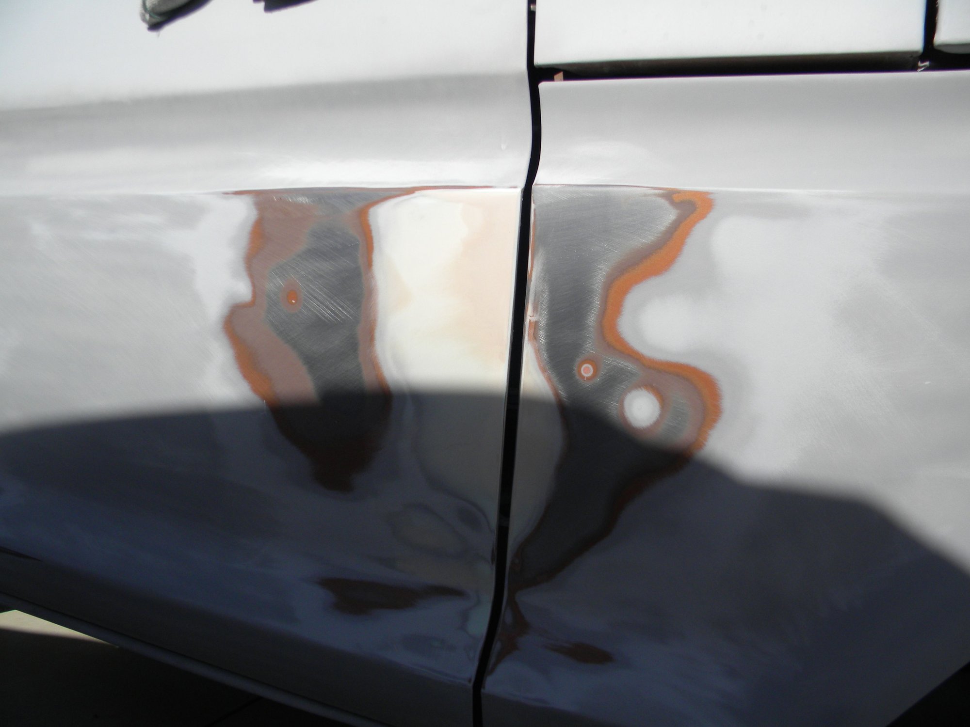

I re sanded,retreated,and re primed {this time I re primed with less reducer laid it on like a sealer and three wet coats.}
took the first week of may off from working on the truck,
now I have been shaping the primer with 150 grit and long blocks
yes i am using guide coat ($2 can of flat black primer instead of the expensive stuff)
or was my truck tagged?
been adjusting and re-adjusting on the doors to get them as close as possible but still needed to float a few places just a little with a glazing coat
top of passenger door to fender
bottom of passenger door to B pillar
Go figure..
