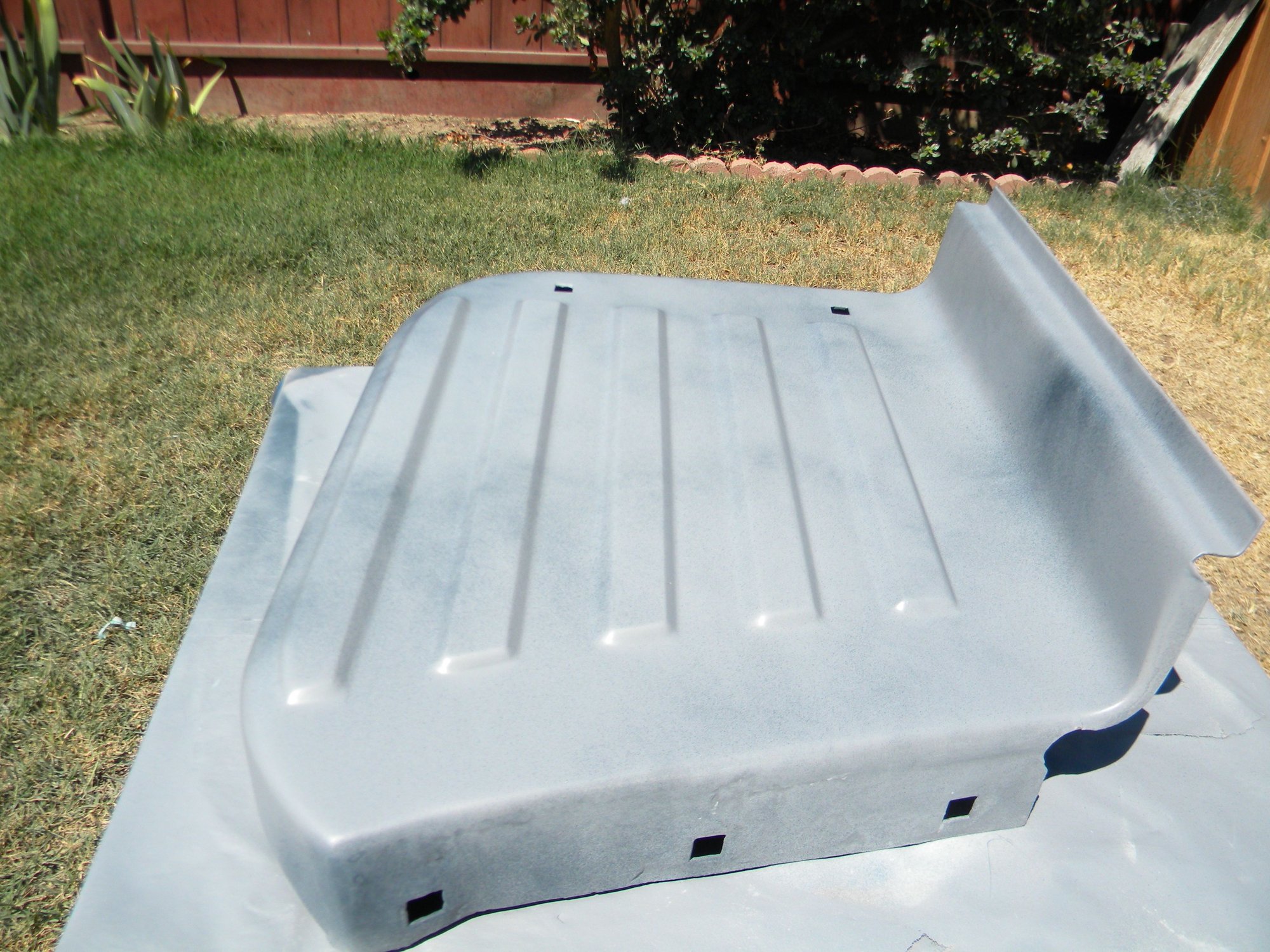

Well being on summer break, and not wanting to just sit around in my off time.
I took these panels off the truck to just re-apply some high build primer because in doing the "shaping" process I found a few "lows" so now let it flash and dry then back to more sanding
yes in the "Spirit of a L.B.B" I am doing this at home...

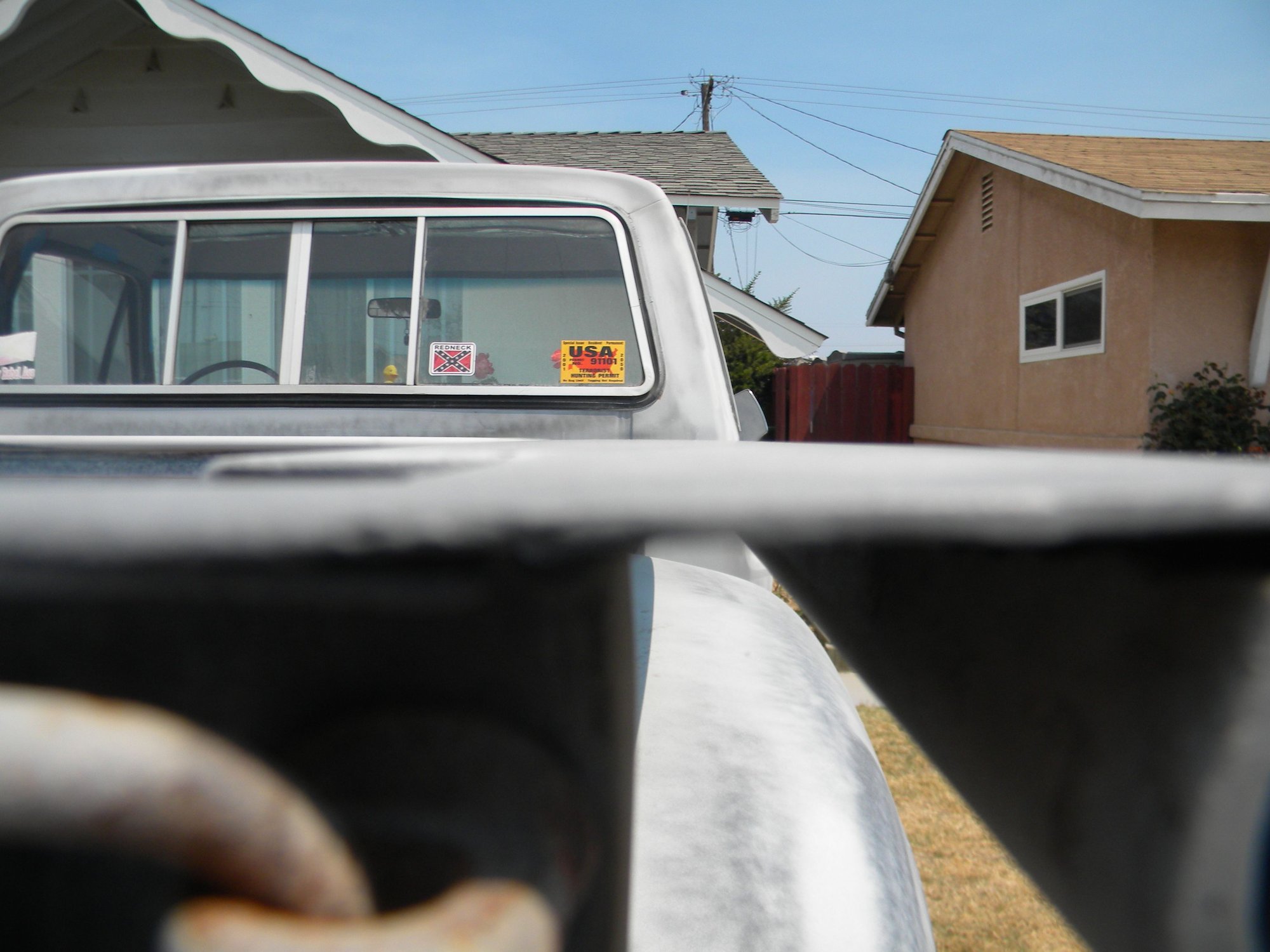

update on the "77
has it been a while? yes it has.... been a little busy lately...sanding....
I finally got the bed panels where I want them to be..."flat" It took a while...between the fenders,bed rails, tailgate and head board, close to 80+ hrs of block shaping. med sanding and fine dry sanding, I started with 150 then 240 320 and a 400 dry, I did need to re-apply a few coats of high build primer/filler to get to this point,
Now it is on to the front, I am currently blocking the front fenders, and am down to 320 when I took these pictures,
not quite done chasing the style lines on this fender

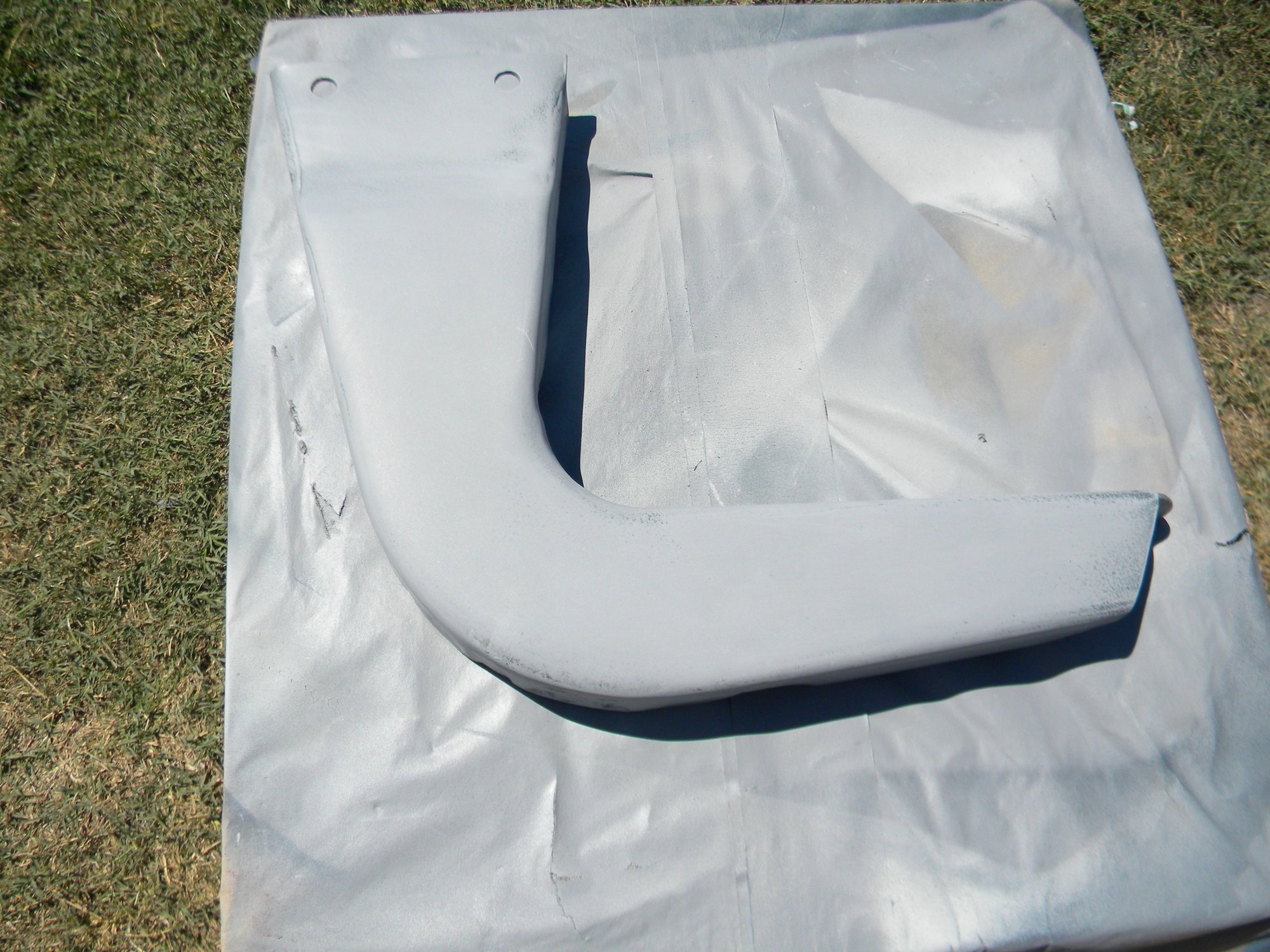

time to "STEP" it up
ok so I am currently happy with the way my front fenders are,
so on to the next set of pieces to be sanded
ready for wet sanding after only 24 + hrs shaping re-priming and re-sanding
step braces ready for wet sanding
oops still needs a little more blocking by the edge before done

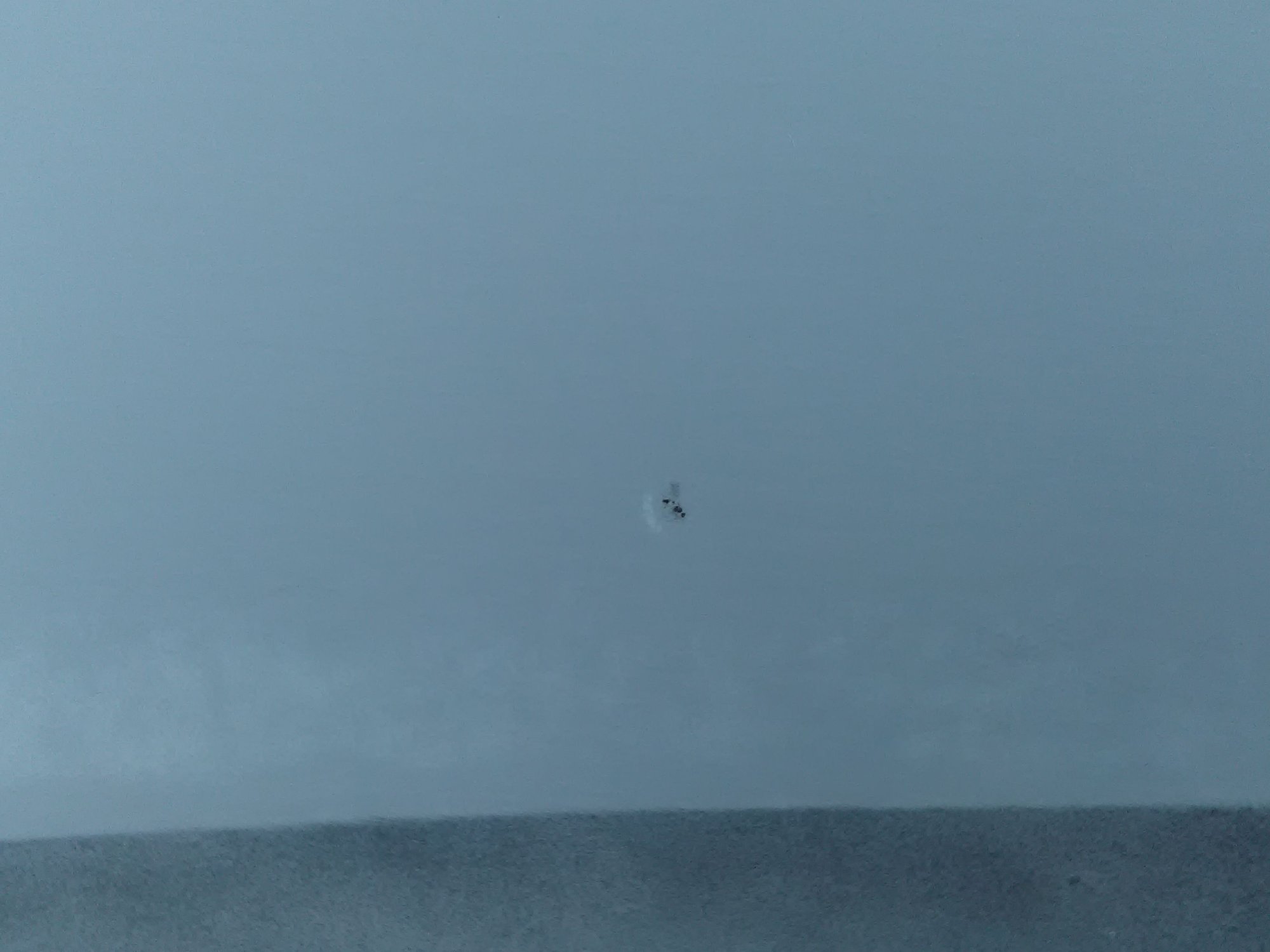

here you go MD
you ever hear the term "There's A Fly in the ointment?"
or "Waiter, there is a fly in my soup"
well just to show you a more interesting moment in doing this L.B.B...
zoom in
I didn't see my "fly" unit I was blocking this fender down...
so .... I sanded past my "fly"...and needed to re-apply another coat of primer
(he looked fossilized in primer)
