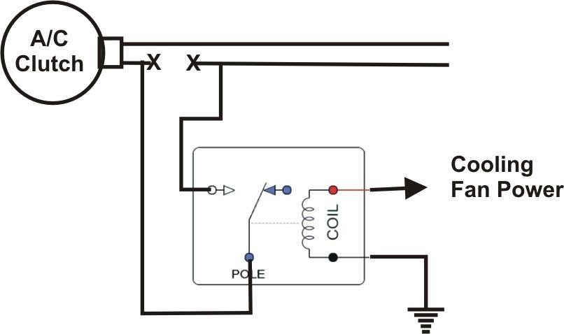

The reason I asked is my bus uses the stock dash evaporator and an overhead rear evaporator system but only has the large side skirt mounted condensing unit so when the compressor is on with the defroster, the 3 condenser fans are not running. With little airflow across the condenser, is that a problem?
Old Feb 22, 2016 | 08:38 AM
jimandnena's Avatar
jimandnena
Joined: Mar 2014
Posts: 906
Ahh, now I understand your setup. If the cooling fans on the condenser are not running then the high side pressure could get excessive. That would lead to compressor failure. I would certainly turn off the compressor running anytime the cooling fans are not on.
The ideal solution would be to put a relay in the compressor circuit that was powered by the cooling fan power. That would automatically solve the issue. jim
Relay cutout for A/C clutch.
