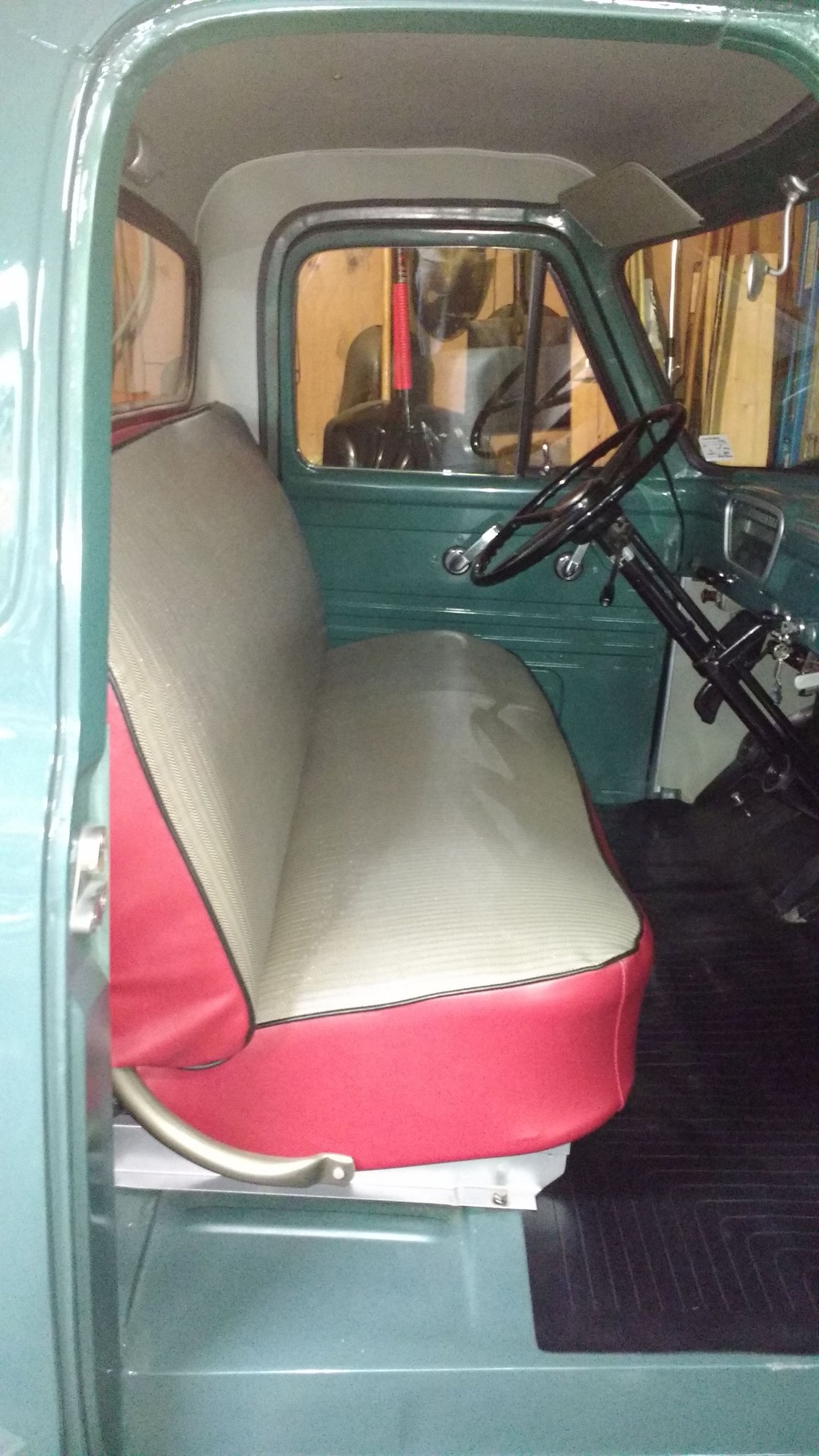

the seat reupholstered with 1954 NOS material in the truck:
Hi Abe,
did you get the seat material from SMS? Did they only offer one color in 1954? The seat in my truck is much darker than yours and the sample SMS sent me for ford 54 truck is very close to my existing seat. I’m just trying to determine which supplier has the best reproduction cover or one that’s close to stock.
Chris
Yes from SMS. Yes, only one color, Standard Cab and Deluxe Cab. The Deluxe Cab had a red vinyl booster on the top of the seat back. I bought NOS fabric. The owner told me he was going to start reproducing 54 truck fabric. The last time I emailed him he hadn't done it yet.
I don't know of any other place that has NOS 54 Ford truck fabric, nor reproduces it.
