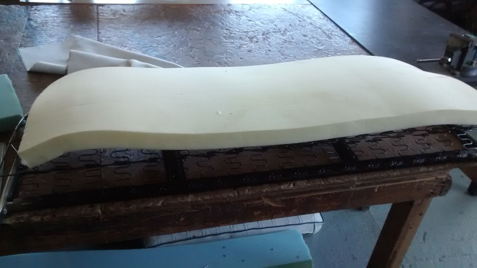

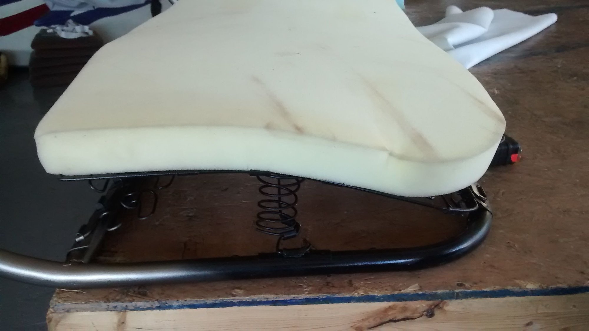

The upholsterer called this morning and said the seat back foam was too short and not wide enough for the seat. I got it from Mid-Fifty. I will call them after I go see the foam for myself.

I've had that happen to me before, Abe. Was the foam tightly wrapped for shipping? If so that can reduce the size of the foam considerably. While it may eventually return to full size eventually who wants to wait for that to happen? My cure was to use a steamer to return the foam to full size. Pretty quick and simple.

No it is the wrong size, not tapered like the picture and the description in the catalog said. It is a seat bottom I think. I told them I want a refund not an exchange. I will use the upholsterers foam.... a alot cheaper and quicker, too.
