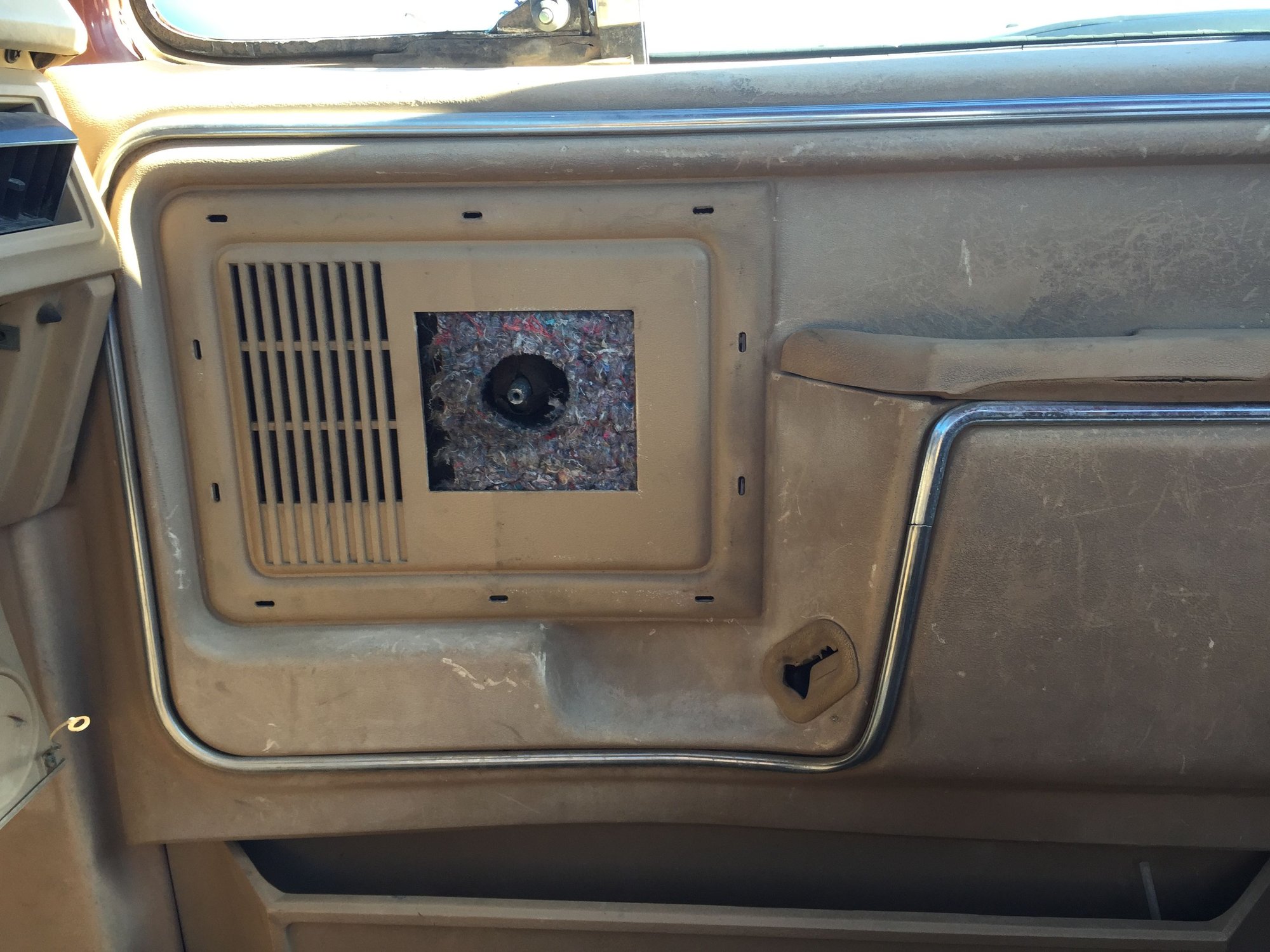

Originally Posted by DeereFord300
Is there any way to attach the wood grain door accents from the 80-84 XLTs?
The tabs usually don't survive removal, and I think most people just glue them on. I don't like the idea of having them permanently stuck to the door card like that so my plan (if I end up using mine) is to JB weld elevator bolts (the ones with the large super flat heads) to the 4 corners of the rosewood trim, drill holes in the door cards, and fasten them from the back with nuts and fender washers. Even if you could get the rosewood panels removed with the tabs intact, recreating the slots in the door card would be quite a chore:
