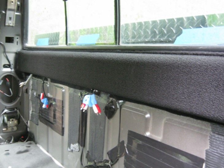

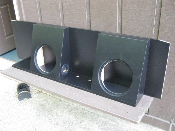

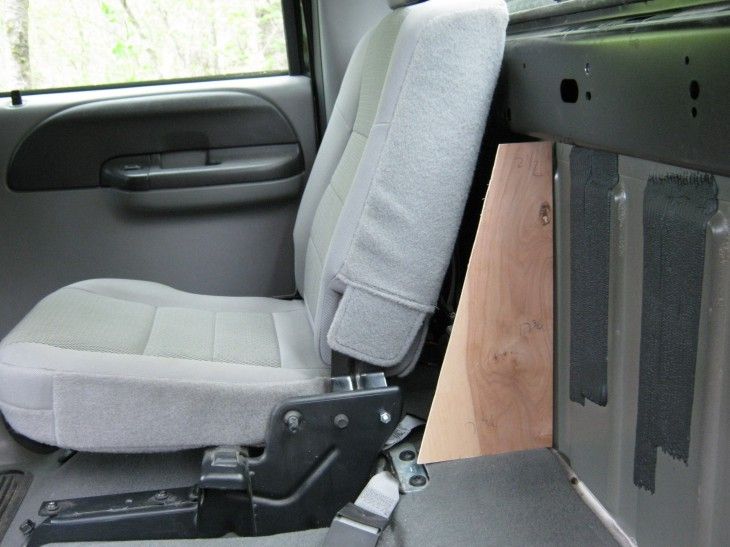

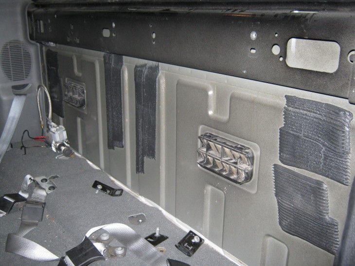

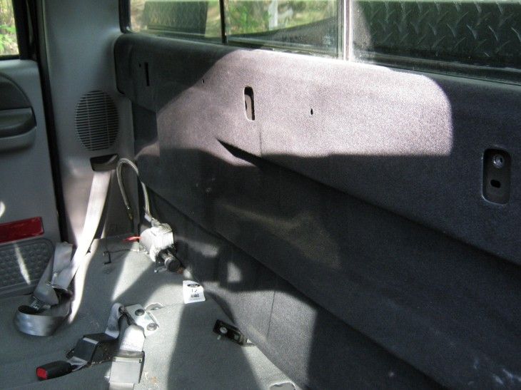

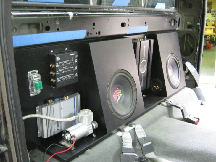

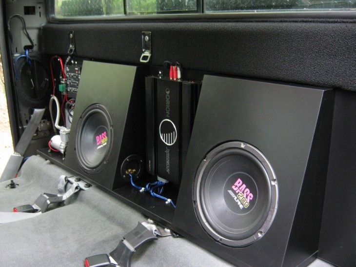

Im not sure if there is a difference between the 07 and 08, but you could get some plywood and make your own. Here some pics from an 07 crewcab.
Contact cement on a strip of carpet for the top rail.

Damn you ain't gonna see out your rear view mirror with that! Lol
