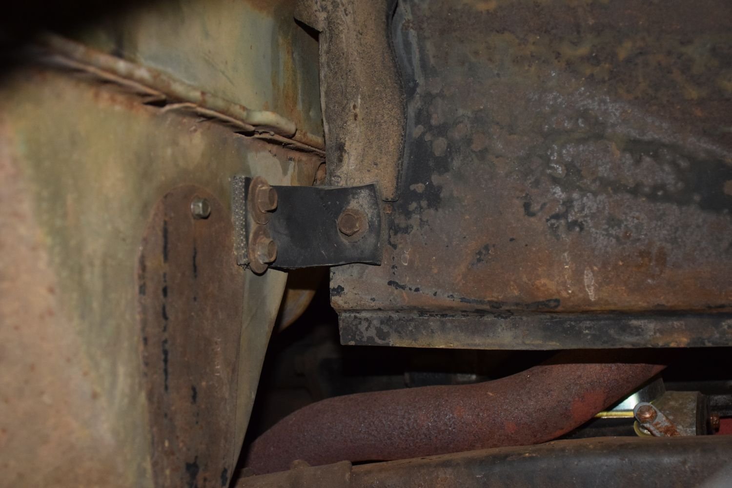

Tomahawk, I don't know how tore down your truck is, but are those the bolts to the rubber isolators from the fender well to cab?

Originally Posted by Salty Dog
Hope yall don't mind me re-using this thread. The title works perfect for this post.
No problemo, that's what its for.
I think you are onto something teach. Where exactly are they located?
Lowest portion of the inner fender, nearest the firewall. Driver side is below the steering shaft and passenger side below the heater core hoses. 1 bolt to the firewall connecting the rubber isolator to the inner fender with another bolt. Keepsemfromfloppin.

Got it!
They are on my F100...
..but not the Highboy.
PO never put them on.
LOL @ Keepsemfromfloppin
