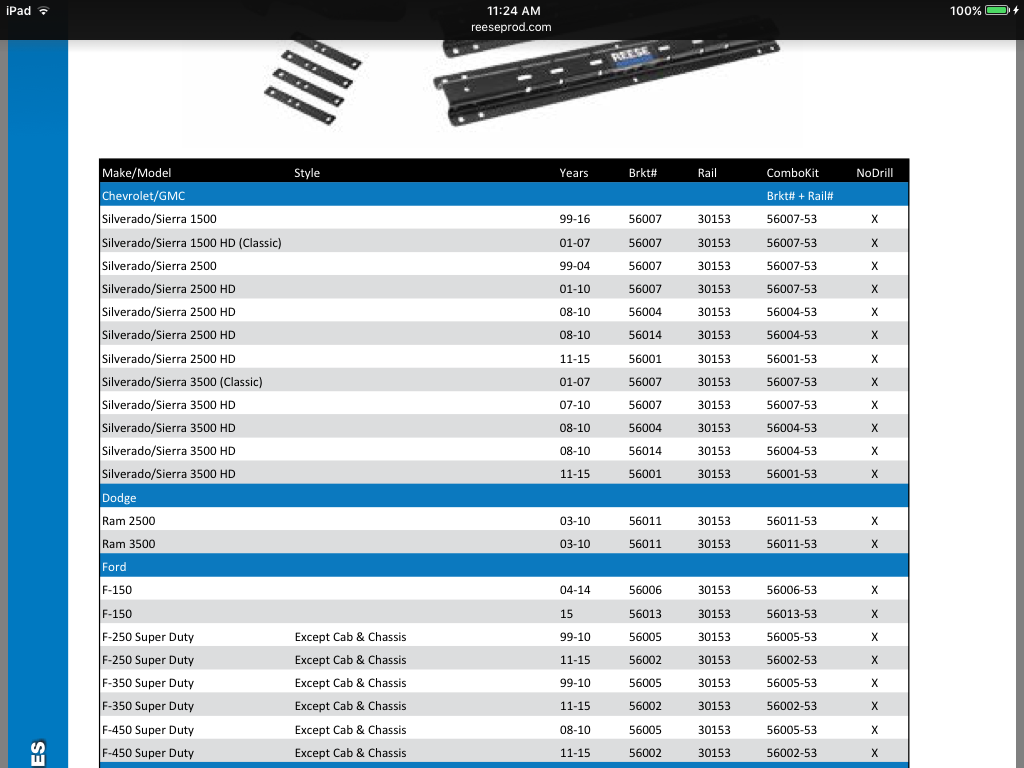

Here's the Reese page for their applications. You can see that some of these kits work for several years including yours up to 2010.
More then likely, Ford's kit that fits never models, might not work for you.
