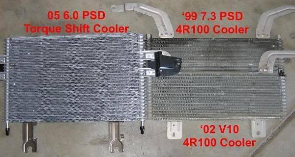

Do you have the stock transmission cooler? If not you may want to upgrade to the 6.0l cooler.
I would leave the rear block in as well, that is part of the F350 chassis, lowering it may have adverse effects on load capacity.
