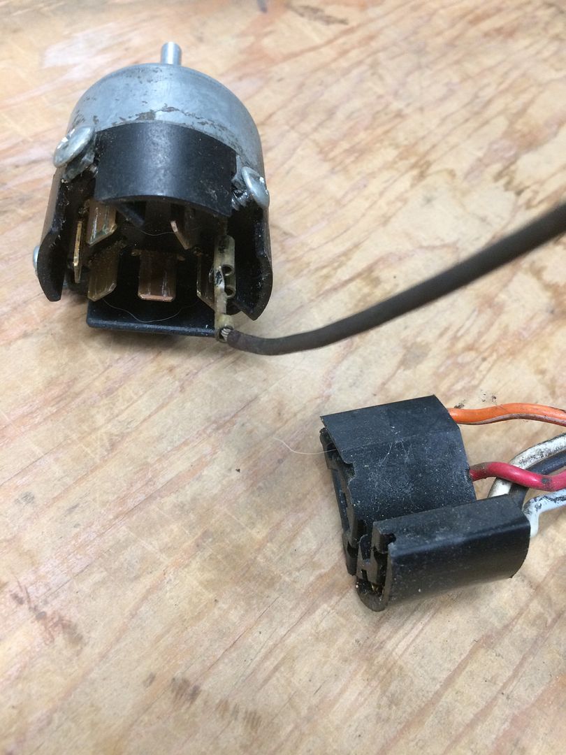

John I have the entire set up like the picture above I am putting it into a 62 F100 there was nothing in the truck, so I took the entire system out of a 78 F150?? bought a new 4 wire wiper motor but everyone says this is plug and play? Not if you don't have anything. As it sets it is a dead loop where do I get the power source from? I have and additional fuse box installed as the original head light switch was all rusted, finally found a replacement but still going to leave the xtra box in for easy fuse replacement. I have had Bruce and others keep saying plug and play but in my experience it has to have power introduced. Everyone keeps referring to a 4 prong switch or a 6 mine only has 5 it was a direct replacement from O Reilleys with the old one. Help

John hasn't logged on here in a few months. It is plug and play if you have a 1966 that came with 2 speed wipers using a 7 terminal wiper switch. The 6-prong connector looks sort of like a question mark (?). Not the best picture but if you have a 4-connector flat or any other style then it won't be plug and play.

The previous pictures were removed from a 78 Ford F150, I had everyting including wiper motor, but switch was corroded and easily replaced from O Reilleys. The wiper motor was locked up probably due to JY pull and windshield was missing so I purchased a new motor from same store, I just didn't pay attention to when I swapped out core for new and I let old one go with the harness connector. I just can't seem to fathom where the whole assy laid out on my desk is totally worthless until I can add power to circuit. Where do I install it?? I have the new ignition switch and a new headlight switch (my fuse box was rusted up) so that part of wiring I still have but there are some wires cut trying to trace them. Started to get seriously frustrated with this project just due to this stupid w/w upgrade, but he had pulled everything to do with wipers harness, motor, switch and misplaced them.

no can't physically fire it up. Think my problem is trying to put this entire setup into a 62 F100 it was a 2 speed but I pulled the whole shebang out of a 78 F150 wiper mtr, harness, delay box, and switch. It does all plug together but I can't see where you introduce the power to the system. It is a 4 wire motor with a round 4 pin attachment I removed that and matched wires to black plug with spade terminals. Someone said to introduce the power to the red wire on the motor and it will feed from motor to switch and back. BS now got another motor and switch starting all over

Just going by memory everything plugged together and the orange wire got connected to power. One of the photos above you can see an orange wire but not sure if that is from your harness or someone else’s.

12v power to the switch. Use a fuse, I like to add a relay into the mix and give these old switches a break. check your email
