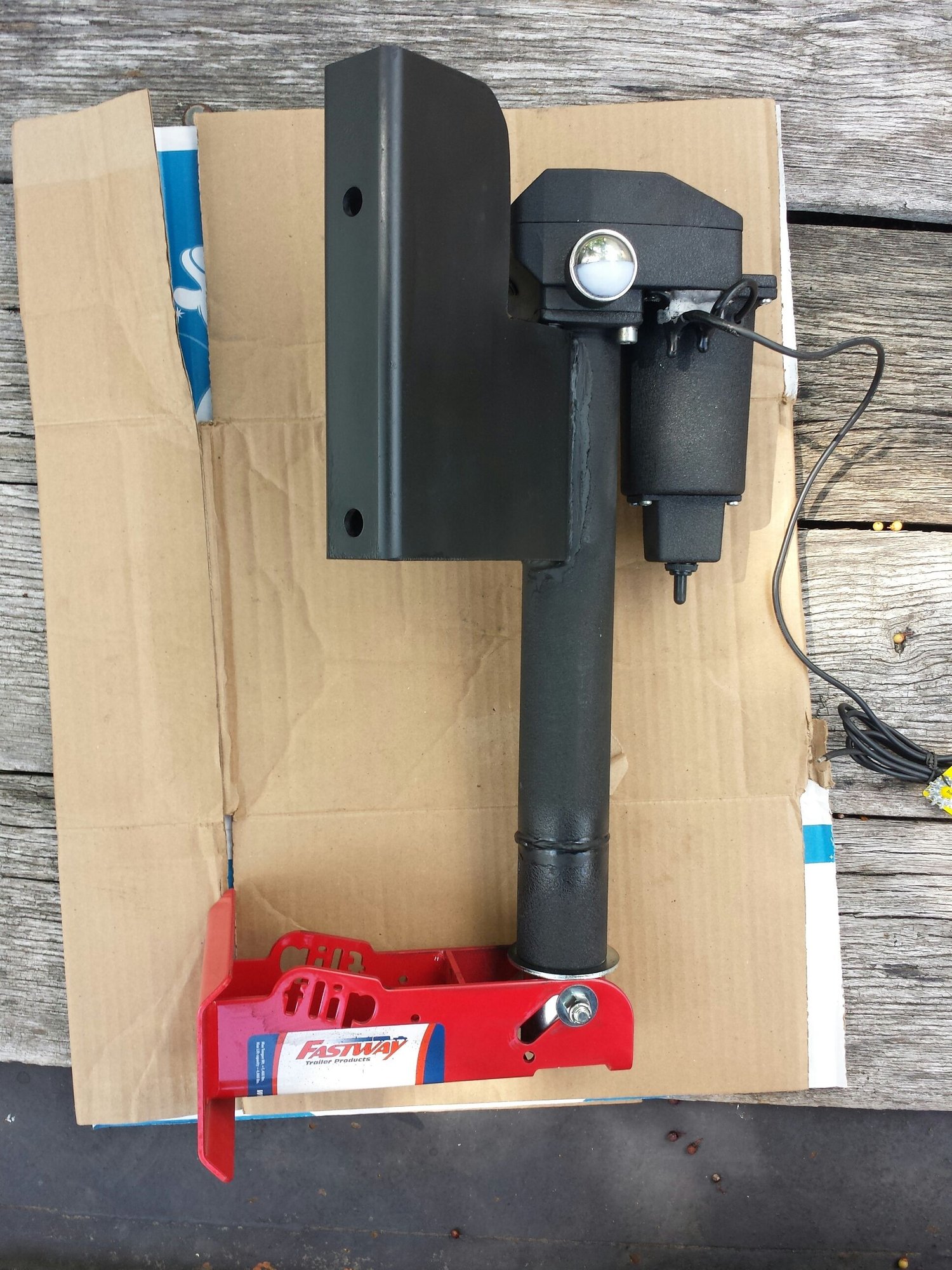

I made my own out of 4k tongue Jacks. I cut them down 7" and added a 6" flip foot for faster setup. I used a piece of 6x2x3/16" tubing for the mounts to the I beam. My Wildcat has hydraulic front landing gear so set up is fast. I'm able to lift the entire coach off the ground for bearing and brake service. I think I have about $375 into it.

It looks like you fabricated a bracket to fit inside the I beam horizontal supports on the exterior of the I beam? Did you weld the bracket to the frame or is it bolt on? Do you have any other pictures of the bracket welded to the jack?
Do you simply manually activate the switch?
I have a very similar jack for my 30 ft travel trailer. Although, in order to fabricate something like this I would have to enlist the help of a welder and machine shop for the brackets.

The material used for the bracket is listed above. The braclet is welded to the jack tube but bolted through the I-beam with 2- 1/2" bolts. I kept the install simple and ran one 10ga fused hot wire from the battery to the jacks. They are operated by reaching up and using the toggle switch. Later I may add remotes.

I don't know a lot about welding, but I am surprised to see that weld on the tube of the tongue jack is holding. The leverage from the point where the bracket is bolted to the I-beam must be producing a lot of pressure.
It is difficult to see the portion of the bracket that bolts to the frame with the 2 1/2" bolts, but I assume that it has a section of short length to run next to the I-beam to give it more strength?
I assume you do some sort of metal fabrication on the side or full time?

The weld is full length both sides, and across the bottom. It's all sheer strength up and down. The round tubing leg would bend long before my welds would ever break. The 5"+ of weld would have to sheer for it to break, simply not happening. There's hardly any side load, maybe a couple hundred pounds being it's only a 6" vertical offset. The bracket is also tight to the flanges of the I-beam to help assure the bolts won't sheer either.
And yes, 20+ years fabricating and more years in mechanics. Now it's more so extra money on the side or to help out friends. It's something I enjoy, stepping back at the end of the day and seeing what I built.
Here's a couple more pics. Also note, I angled the flip foot for stability. Once both sides are down it really locks the jacks in place. It took majority of the rocking out of the coach too compared to the old scissor jack stabilizers, so much that I removed them.

I commend you for a job well done sir! The last set of pictures really puts it into perspective now that I can see it is double sided. Thank you for sharing your project with us.
