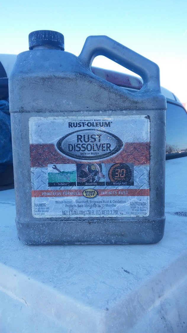

Why not rebuild yours? That rust can easily be removed with this product
Heres some pics of a gtp38 out of a 7.3 this was all done with the product above, no scrubbing, just dip it in a pan and let it do its work.
After
Before
Also check spturboost.com quality stuff at low price. Any Q talk to Kevin he knows turbos.

Freakify, that stuff works great for rust. I also use Qurox here at work.
I would also add however it won't cure pitting obviously.

Unfortunately when pitting occures theres no reversing it.
