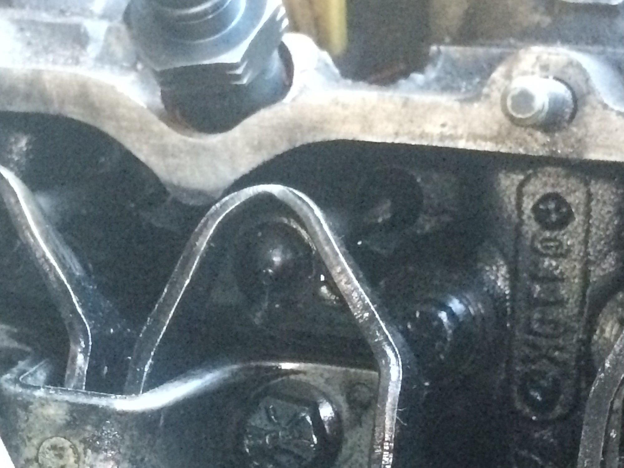

looking to see if anyone has this same issue.
may not be detrimental, but its "rubbing" me the wrong way.
i have a set of roller rockers that i didnt install because of this issue.
but putting the stock valve train on, on 3 different engines, they all appeared to have the same outcome.
working on a buddys 6.9 yesterday, i noticed his are the same way, even tho he has the early style rockers.
but the pushrods arnt shiny, so they cant be contacting the cast iron.
does this cause alarm for anyone else???

You think the pushrods are contacting the head?
no sir, they are not touching the head, but its really close.
too close for my liking.

normally i would agree with you.
but before i install the $1200 in parts on the valvetrain that i have sitting here,
i wanted to see if theres anything that can be done to fix this.
on my next engine, im throwing the heads on the mill!

So do the Harland Sharp rockers fit and work at least as well as the stock ones without modifications or custom push rods?

definitely need shorter pushrods...
i have an adjustable pushrod, but i didnt like the placement of the rods to the hole.
